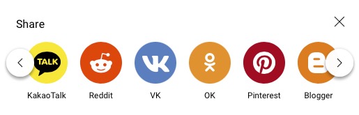

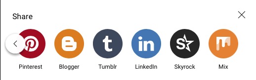

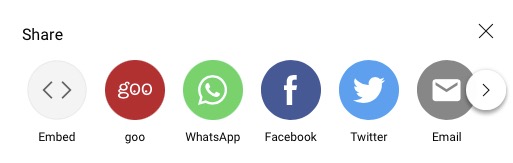

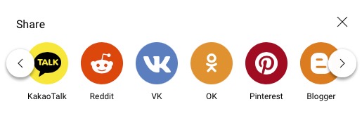

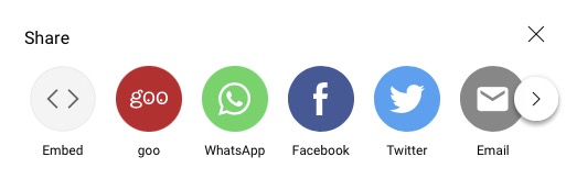

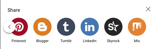

Anyone else noticed Share Sheet weirdness with YouTube in Safari under Monterey? Don't know if this is an OCLP thing or not. To see this, click the Share link under a video in YouTube. Not the Safari file-menu Share or the Safari Toolbar Share button, but the Share link that appears under every video in YouTube. The list of Share sites is bizarre. And conspicuously absent is Messages or Text. Most of the Share apps I don't use or recognize- save for Email, Twitter, and Reddit. Anyone else noticed this? Running Monterey 12.5.1 and Safari 15.6.1 and OCLP 0.4.10.
EDIT: No idea what is up with the green boxes in the first jpeg...they don't appear that way in Preview on my Mac.

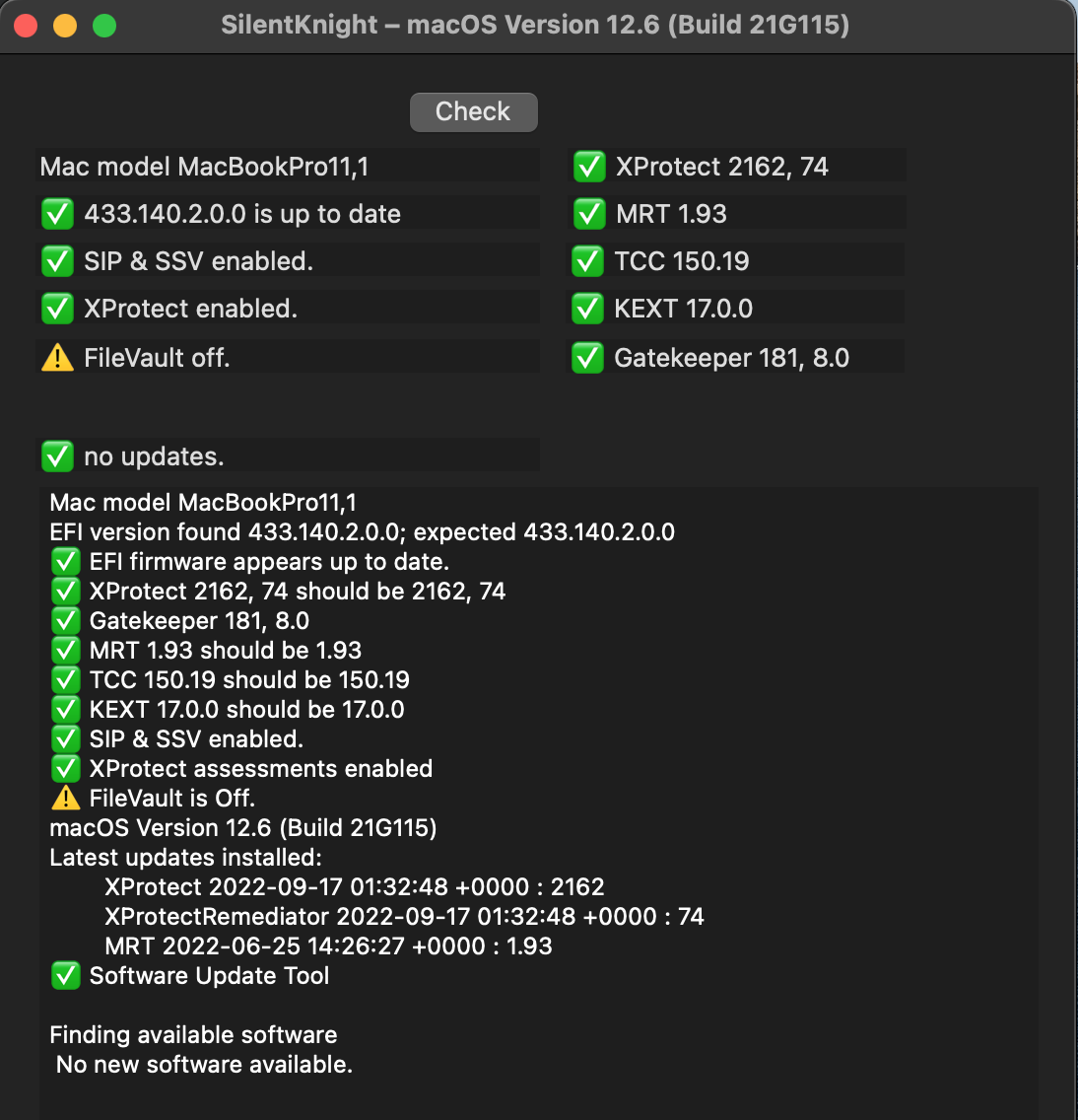

4 days ago I installed 12.6 to a fresh partition on MBP11,1 using OCLP 0.4.11 without disabling any features (or touching other default settings) and have had no 'volume hash mismatch' error thus far, and NightShift also works fine.
Everything is very smooth & stable for daily tasks, SilentKnight reports all security like SIP, SSV, etc, up to date & active. The only crash I have been able to induce thus far is with the GeekBench 5 /Compute > Metal test, which reliably KP's 29 seconds in, but works fine on the Big Sur 11.7 install on same machine.
This Metal-handling issue was expected, as I had it before with 12.4 & OCLP 0.4.8 on same machine - will try booting Monterey from USBKey with OCLP v0.5.0 EFI partition to see if that resolves the issue.

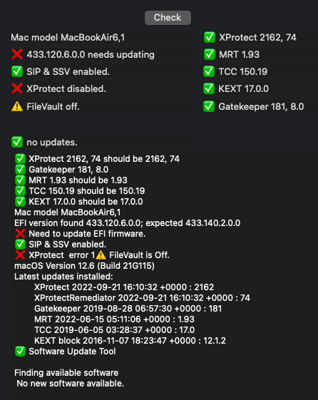

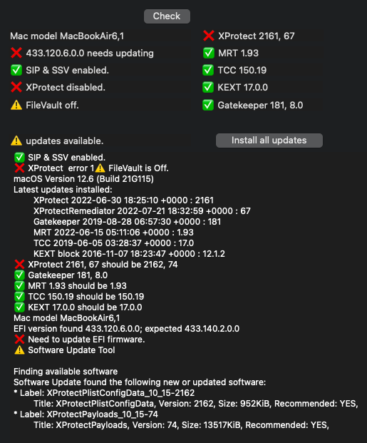

Thanks for the heads-up about SilentKnight – this may be the answer to the security question I asked earlier. I hadn't heard of it before.
In my particular case, some updates are needed. Is it advised that I proceed? And why are these out of date? I used OCLP v0.4.10 and now have OCLP v0.4.11 installed (as an app) which reports no patches needed.
I went ahead and ran the updates after reading the SilentKnight instructions. Here's where I'm at (please advise):
