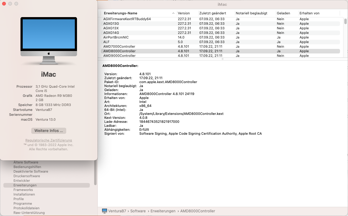

Kexts can be located in more that one place. Also in /Library/Extensions , besides /System/Library/Extensions.
Yes, but the kexts of the OCLP patch are located in /System/Library/Extensions. If your system is patched, make this test : look with the Finder in /System/Library/extensions, sort by date and you will see first the OCLP extensions. Note them, and look for them in System Information>Software>Extensions. They are absent.
The guide for OCLP states: "OpenCore is a sophisticated boot loader used to inject and patch data in memory, instead of on disk." https://dortania.github.io/OpenCore-Legacy-Patcher/
Does the list of extensions in the System Information>Software>Extensions location show extensions loaded in memory by any code at any time, or only extensions loaded during the initial boot process? I suspect the later.
Could someone who knows for sure chime in?
They are no absent!
In general your observation is not correct. Having only a single system really root-patched (iMac12,2+GCN Saturn dGPU needing the AMD8000Controller support patched back from Monterey ) I found the particular extension listed and in use on my system (side by side with the GCN1 7000 and GCN3 9000 extension).
OpenCore can inject extensions, but when Frameworks, PrivateFrameworks, bundle files are needed injection reaches its limits, you need root patching.
Of course it does only show what was loaded by OS, will not (how would it?) show kexts that were loaded by OC and wait for the system to load in order to patch whatever they patch.
They are no absent!

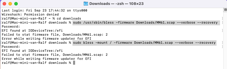

Thanks a lot. I managed to find the MM61.scap file for my Mac mini 2012.
When I run the command in the Terminal app I'm stuck with the following error. I've also tried another command, without success.
Does anyone have an idea what goes wrong and how to perform the firmware update?

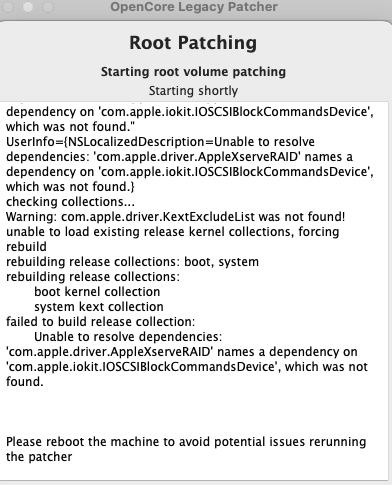

Weird issue just caught me by surprise and searching this forum did not reveal a solution. I have installed Monterey 12.6 (21G115) on a second volume (same drive where I'm running a good version of 12.6 already). Installed fine and when it boots into the second volume, I receive a prompt by OCLP to install root patches, which I proceed but noticed the following message -
I did not have this issue patching my first volume and not sure why AppleXserveRAID would be installed on my machine as I do not have RAID, looks to be missing "com.apple.iokit.IOSCSIBlockCommandsDevice". Anyone encounter this and/or know of a resolution?
Many thanks in advance for your help!!!
Reactions: rehkram
I don't know the answer but I can tell you that I have the same m/c, mid 2012 rMBP 10,1. AppleXserveRAID is not on my m/c
