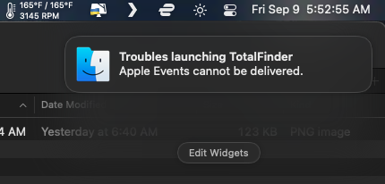

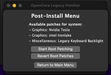

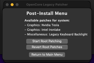

Is there a way to only apply SOME of the post-install root patches?
For example. Before I apply the available patches, my keyboard backlight works perfectly.
Other then some graphical things I need, i.e. external monitor ability, I don't think my mac needs as many patches as its patching. 🤷‍♂️
Regardless of the patches, my brightness HUD is still glitchy. Transposes one HUD on top of the other meant for the external display.
Could also be the reason TotalFinder isn't working after patching. Something in these 3 patches goofs it up. Causes the following error:
Reverting it works fine.
Any insight would be appreciated.

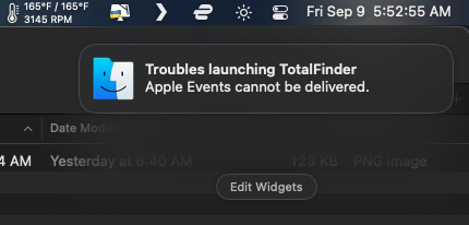

View attachment 2084387 View attachment 2084388
No, unless you write your own patcher or patch completely manually. You are free to check the source code and fork it.

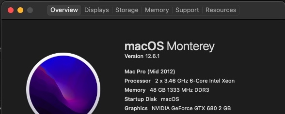

Hi guys. After OC running pretty much flawlessly for some time I am now finding that my Mac will no longer shutdown properly, nor will it ever wake again from sleep once it does.
Have you reset SMC & NVRAM?
Is this a Safari 16.0 problem or an OCLP 0.4.11 issue? Has anyone else experienced this?
I have loaded OCLP 0.4.11 3 times with latest Monterey. Safari 15.6.1 runs fine. Safari 16.0 And beta 16.1 will not allow me to sign into certain websites. Others, it will. I am using a MacBook Pro 5.1. I don’t know if it’s OCLP 0.4.11 or the Sarfari version. I am able to use Safari 16.0 on OCLP 0.4.6, so I’m guessing it’s the OCLP 0.4.11

@Jisted
I am probably unclear with my suggestions.
If your situation is anything like mine, the white screen is probably simply indicative of an attempted restart without alt key pressed. So when you see that, just try and force quit with long press on power key, then start again with power key while pressing alt-key.
You should then see and be able to select the current install partition usually named MacOS install and continue the install. In my experience, OCLP installs on these Macbook Airs has to be supervised to press alt for each restart.
Good luck.
I tried doing the reboot when I hit the white/grey screen, but from the bootpicker there was no option for MacOS Install (with the Monterey background). Only EFI Boot, macOS Installer, Untitled (High Sierra), and Install OS Monterey (from the USB boot disk), so I believe the installer hadn't reached the point where it is usable. When clicking 'macOS Installer', I am faced with the 'No usable OS error screen ø'.
During the installation process the progress bar reached 'About 12 minutes remaining' which is when the white/grey screen appears.
I've tried this a number of times with different approaches (clean install after Disk Utility erase of internal disk, NVRAM reset), but each time, I get this far with the same results.
Trying again now with different USB device (external SSD).
I also realised I wasn't checking for the installer inside the EFI Boot Disk 🤦‍♂️
My other Macs were so straight forward.
Update. After half a dozen “hang at white screen” occurrences, each time I powered down the Mac, restarted with Alt key, go to EFI BOOT and choose the installer with Disk icon. It finally went through.
I kind of know this is documented in OCLP website but the description isn’t quite as what I was seeing.
Anyway, thanks guys for the support. Greatly appreciated.
