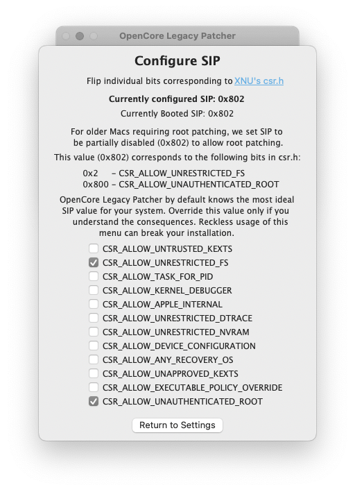

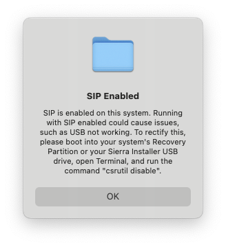

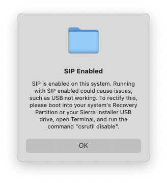

Hello all,
after a hardware upgrade for WiFi and Bluetooth, I was finally able to upgrade my Mac Pro 3.1 to Monterey today. This was done with the wonderful OpenCore Legacy Patcher v04.11.
So far everything is running beautifully. The only thing that still bothers me is that after every reboot I get this dialog:
It's just a little thing, but still, it would be nice not to see it again.
I had already disabled SIP in recovery mode, but this caused my installation to not boot. So this won't work. Fortunately, I was able to fix this with the USB boot stick by reinstalling OpenCore in its EFI.
These are the current settings of OCLP:
Does anyone have any ideas on how I can fix this? Thanks in advance for helpful hints! 🙂
Hello all,
Allow untrusted kexts, it should work.

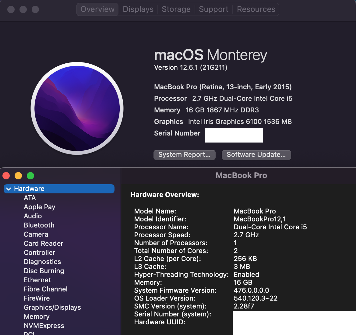

I wish mine ran 12.6 better, it feels really sluggish. I've tried it a few times. I am on Mojave right now and its way snappier. I only have 8Gb of ram tho.
I don't know what Apple did, but 12.6 is much slower than the previous version 12.5.1; version 12.6.1 RC fixed it, it's faster, and I only have 4GB RAM.
Reactions: Jack Neill
Its something about my 2015 and Monterey that just feels slow. My downgraded it to Mojave and its so much snappier. I have a 12.6 image on a TB drive, I'll give 12.6.1 a shot and see if its any better.

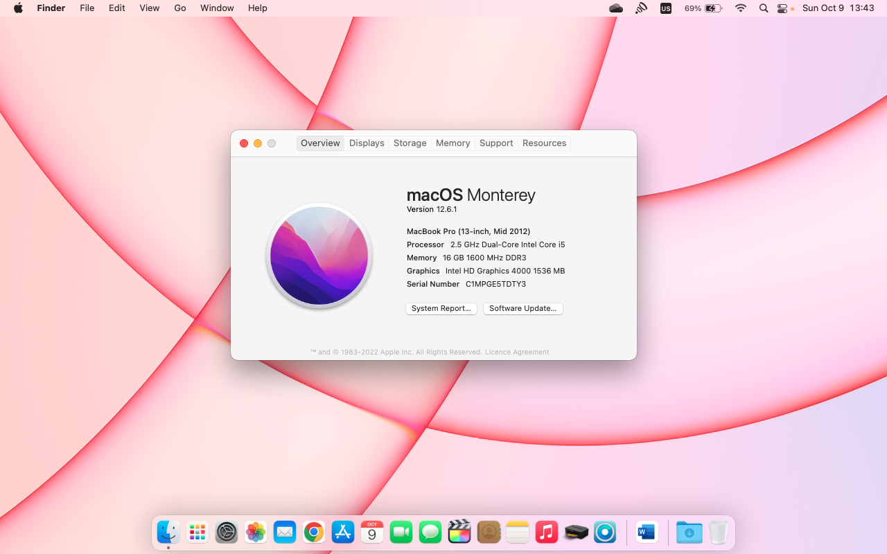

Hi guys, long time no hear! 😉 Just finished updating my MBP 9,2 mid 2012 non-retina to macOS Monterey 12.6.1 RC using OCLP 0.2.5 and everything works perfectly and fast. Have a great one!
