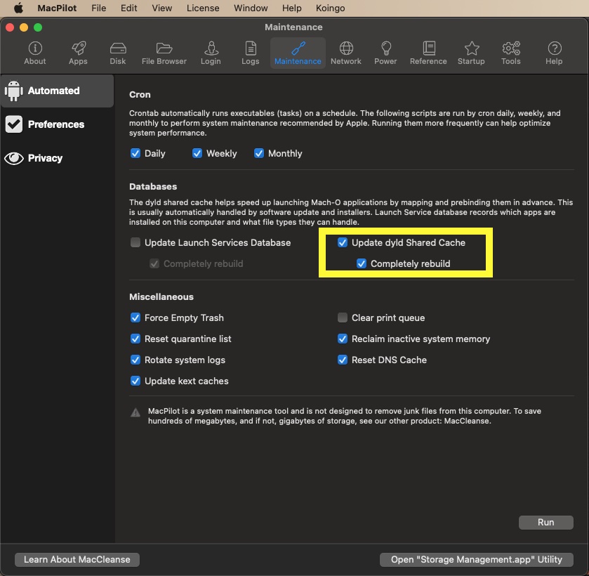

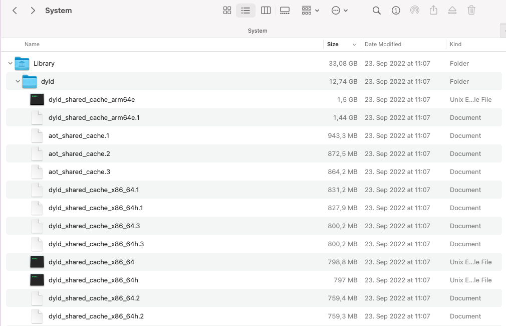

Does someone know a way to thin the dyld folder within the system folder just leaving the necessary cache files behind?
The dyld cache is a new form of System optimization introduced by Apple.
From what I understand, to improve the System's performance, in this cache many binary and other files are inserted and linked together that are no longer inserted directly in many Framework and Kext modules. So I don't think it can be emptied.
That said, in the last MacPilot, I found this option and I'm sending you a screenshot. Cocktail also allows this. However I don't think it really works...
After that, I test it in my Mac and let you know if it worked through an EDIT of this post.
EDIT
So! I started cleaning with MacPilot and as I imagined it made no changes...
The files in the dyld folder were 25 and 25 remain and the total size is the same [Select all files with CMD + A and then execute (CMD + Alt Option + I)] : 12.736.938.798 (5,13 GB on Disk).
The dates also remained the same: August 24, 2022, 10:59 am (GMT + 2.00)
I hope I have answered you

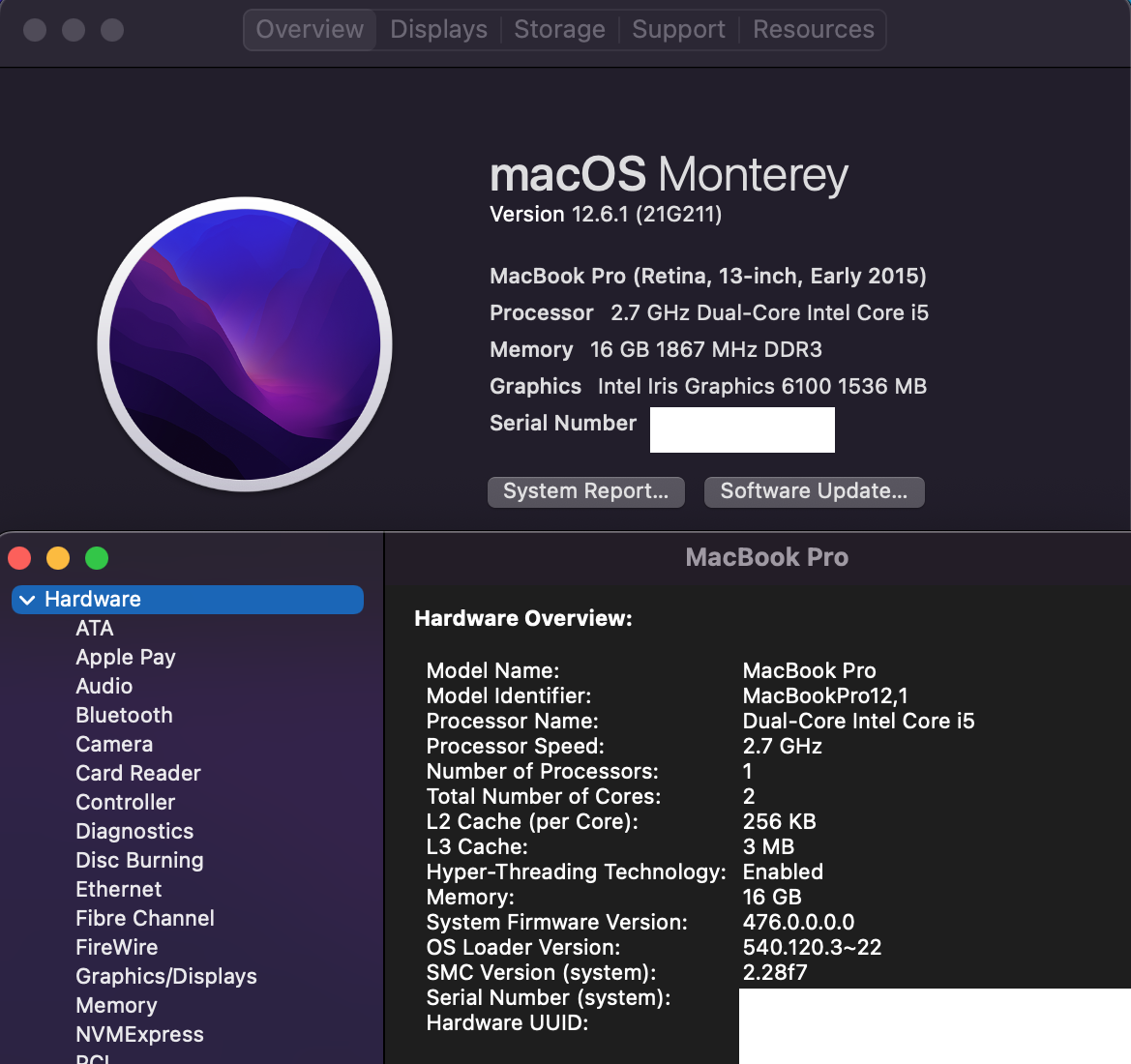

Hi guys. After OC running pretty much flawlessly for some time I am now finding that my Mac will no longer shutdown properly, nor will it ever wake again from sleep once it does.
On shutdown everything quits etc and the sounds wind down but it stays on the desktop pic for a long time (10 min+). If nothing is done it will eventually restart itself, without a chime, presenting the 'computer didn't shut down properly' message before starting up. The crash reports seem to be the same every time.
If allowed to sleep nothing will happen when keyboard or mouse is activated. Sometimes it sounds like mechanically its waking but sometimes not.
Any ideas where to start looking to try and fix this? Its completely the same every time now and not random at all.
Thanks.
What version of OCLP are you running? Watchdogd timeouts were fixed a while back. Install OCLP 0.4.11, rebuild and reboot.

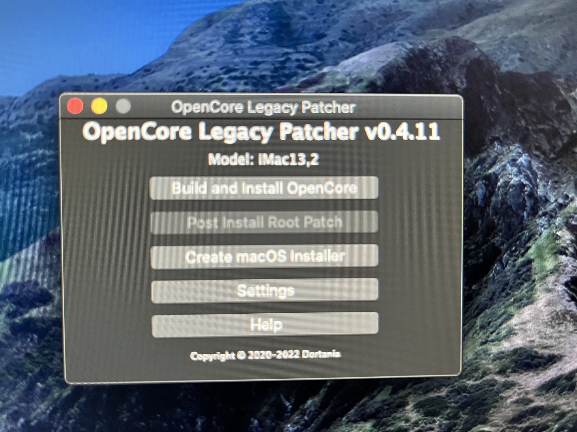

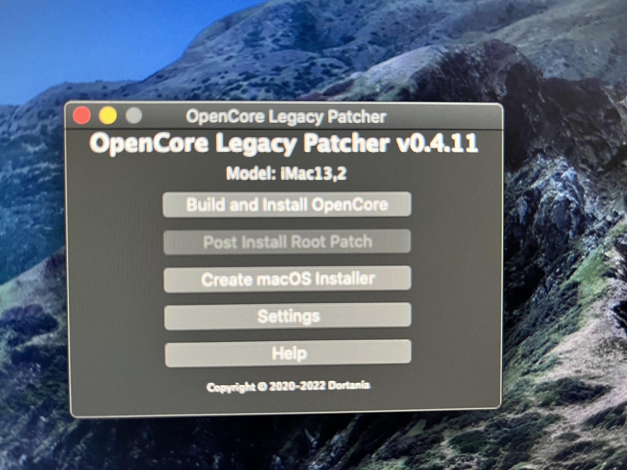

Imac/27/late2012/13.2/Kepler/Ivybridge now Catalina was Monterey 12.6.1/4.11 and running well.
Divided into 2 APFS 500gb partitions. I have been experimenting the past couple of days and screwed things up enough I decided to go back to Catalina via USB, erased both partitions, and now have Catalina running normally, the problem is that when I download 4.11 to go back to Monterey, the line "Post install Root Patch" is grayed out, even after I Build and Install OpenCore, then reboot, it is the same and I get Build and install again.
Any way to fix this please.

Just to be sure I understand. "... the problem is that when I download 4.11 to go back to Monterey, the line "Post install Root Patch" is grayed out". Is this in Catalina or Monterey? In Catalina, it will always be greyed out. Further, you erased the two partition setup and went back to one in which you installed Catalina by USB, is the current plan to upgrade your 1 partition Catalina to Monterey?
Reactions: macpro_mid2014
To clarify, I now have 2 partitions one with Catalina and the other is in reserve. I was thinking of installing Monterey on the 2nd disk.
You should create a USB Monterey installer. I have had problems using OCLP to create the USB installer since it will automatically do the patching on installation which was unworkable on MacBook Pro 5,1. For me, the best option was using Terminal to create Monterey USB installer and then use OCLP to install EFI on USB drive. Also, I don't know if having OLCP installed on your boot drive with a supported Catalina and unsupported Monterey is a good option or not. I am fairly certain that using USB is better than trying to upgrade to Monterey to the other partition within Catalina.
