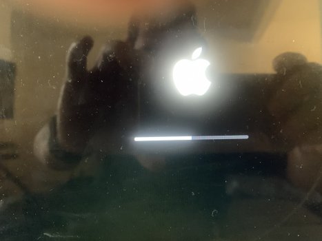

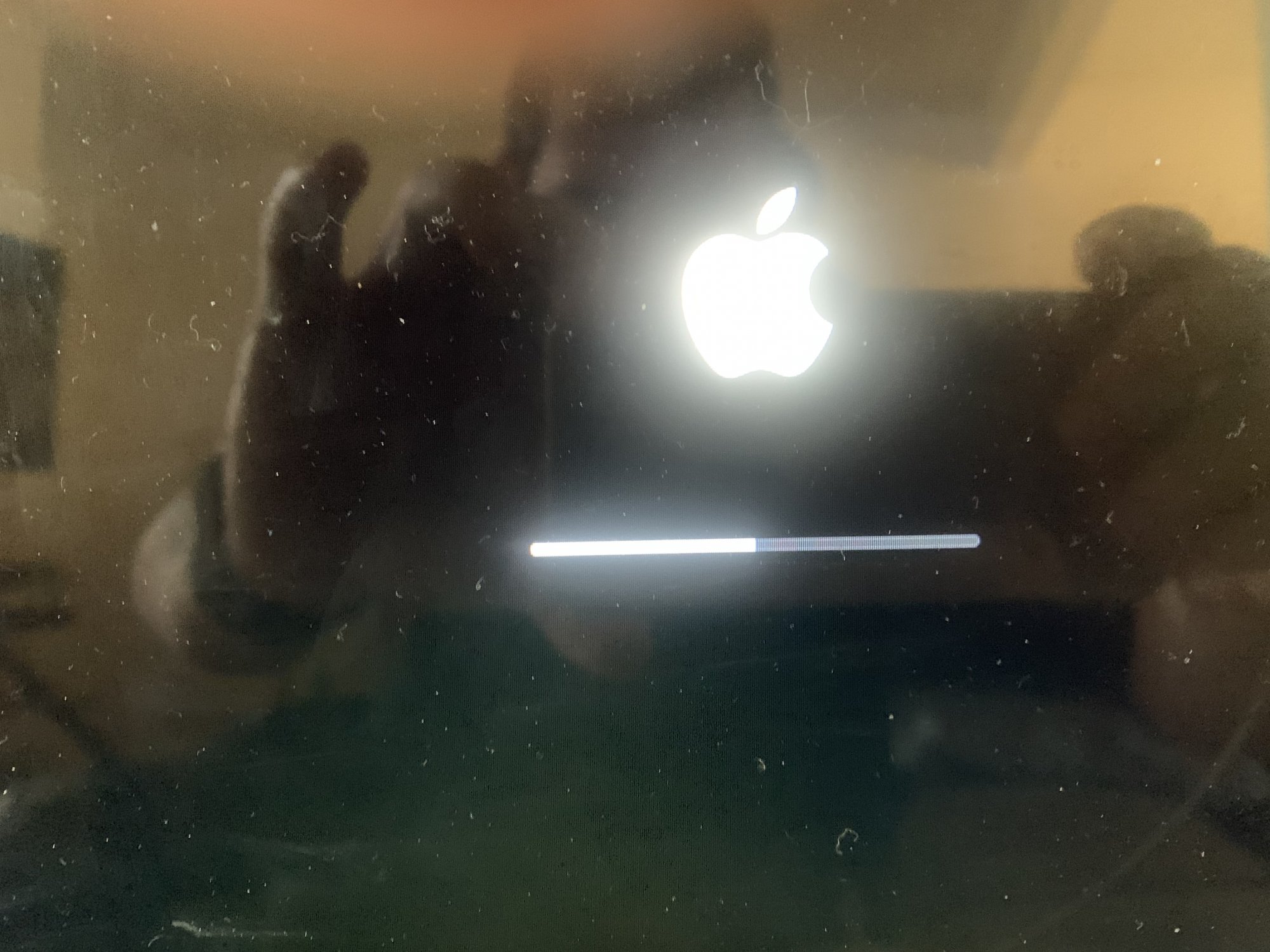

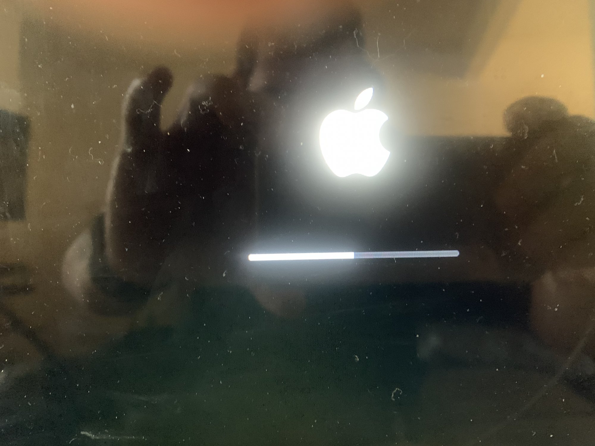

But yeah, this is critical cuz I wanna make sure my macs not frozen, I know I can see the progress moving EVER-SO slowly, but it was an 11gb update, so I assume that’s why. Does it matter if I used Mr. McIntosh’s full installer package for Beta 3 with the OCLP post install volume patches, and then an OTA update for Beta 4? (Which was again, 11gb, when I thought the delta update from Beta 3->4 should only be like 2.3 gb? Should I have just used his full installer? The progress bar looks like it’s moving so I’m reticent to do a hard shut down just yet. If I have to, I’m not even sure what it’ll boot to or if I should hold option down?
This is where the progress bar is at and seems to be slowly creeping along

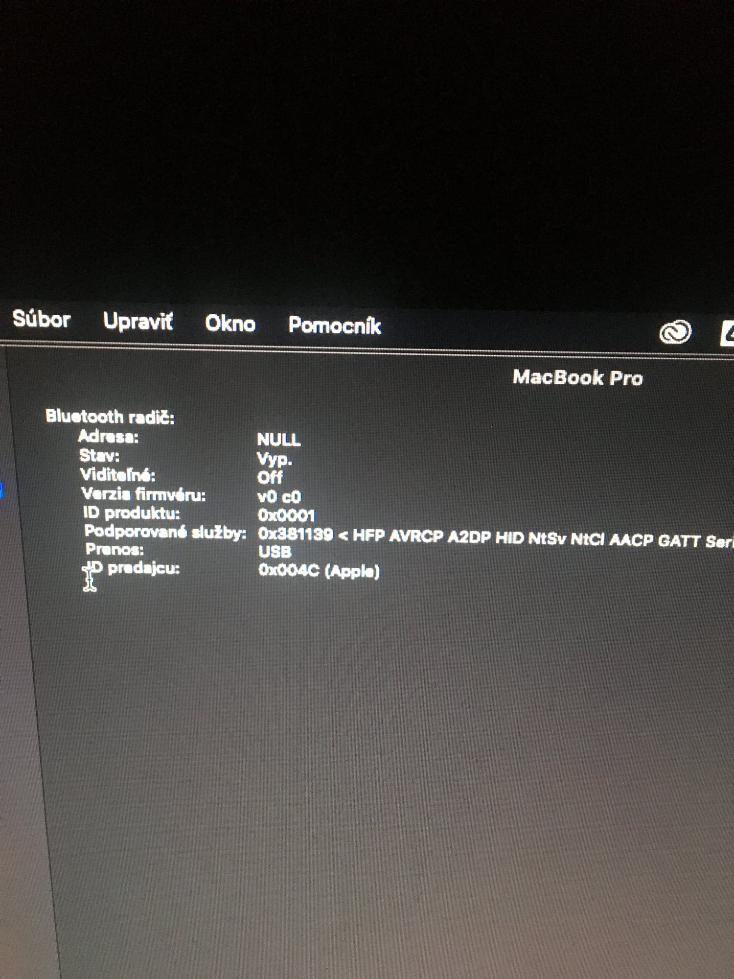

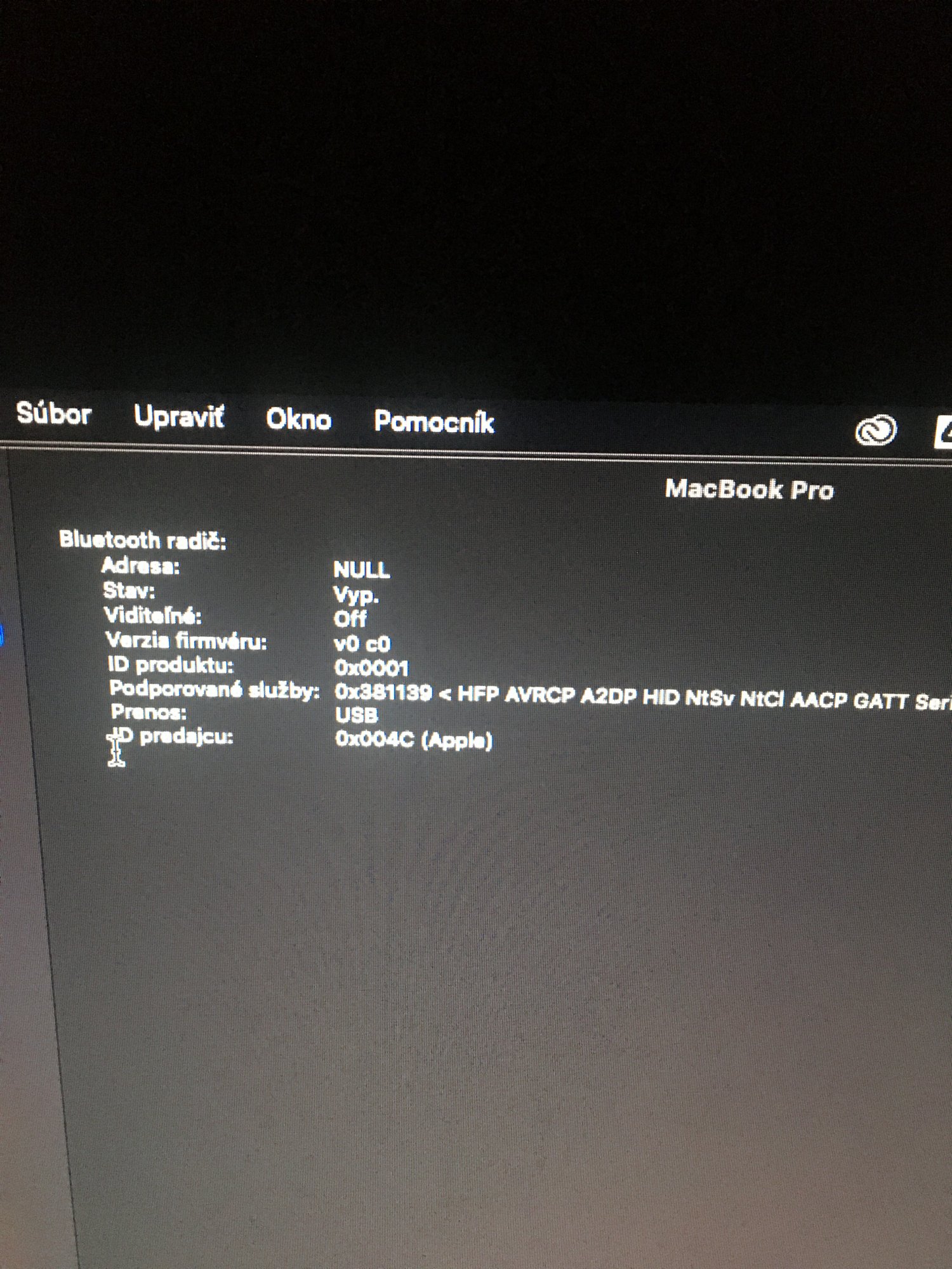

Oh well MBP 9.2, beta 4, BT shows turned off and Trust BT mouse moves only on X axis on top of the screen., keft and right buttons are working. Address: NULL Any fix yet?
Thank you for this update - I have taken the advice from above and reverted back to Beta3 until this issue can be resolved as not having full control over the track pad was a real nuisance.

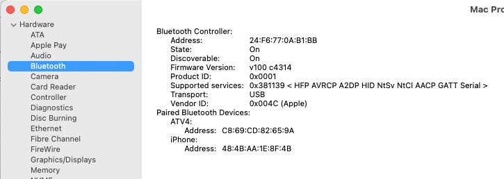

@khronokernel (and @borp99) quick ping here to let you know my BT is back (for all the rest of you, it was discussed over the past 2 days in the latebloom thread). I am not sure exactly why BT is back as I did several changes fairly close to each other (not a good idea of course) but I suspect adding all my HDD and USB 3.0 PCIe card as well as USB 3.0 hub did something. Previously, I was testing latebloom with a rather vanilla setup (only NMVe card with BS and one 2.5" SSD with OC). So far, I've had success in getting BT to show up and work after every boot (cold or warm, even lukewarm haha). I'm not assuming it's all resolved, of course. And I am already thinking about the plan B in getting that USB hub in there as you (both) further explained in this thread. Thanks!

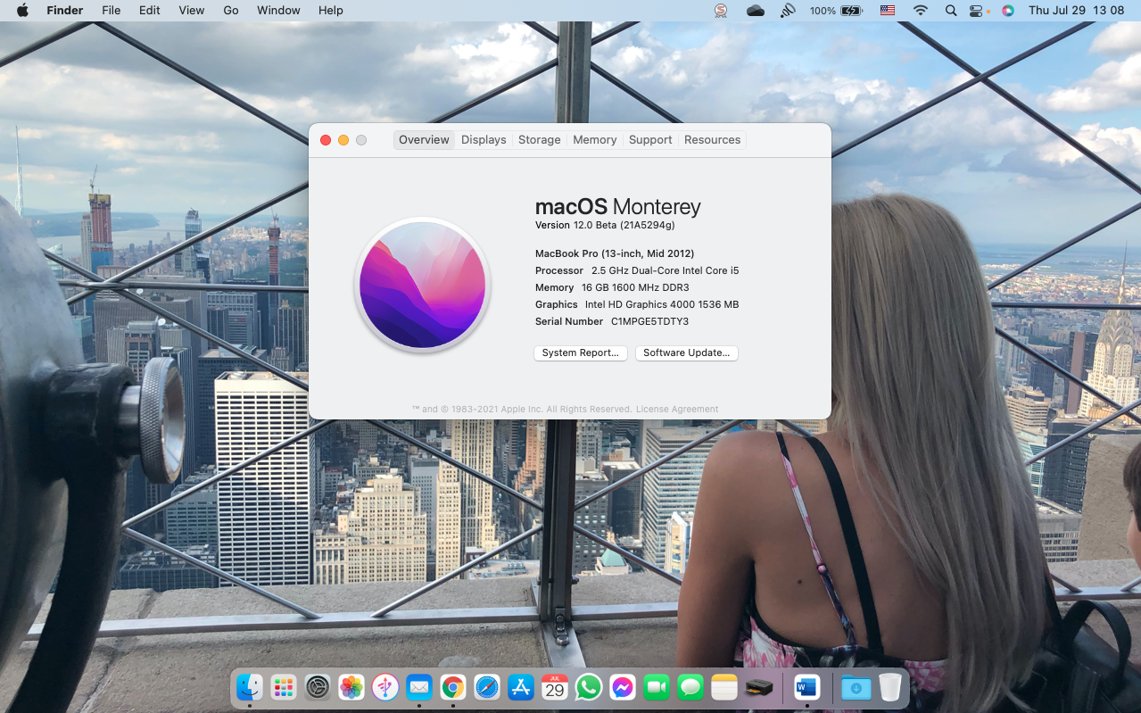

Just upgraded my MBP 9,2 non retina from macOS Monterey Beta 3 to Beta 4 and got through some issues (for the very first time since I've started 'playing' with macOS Big Sur on my unsupported Mac)... I have used the OCPL 0.2.2 since I couldn't figure out how to use 0.2.3. 🙂))
First issue - the install got syuck mid way and stayed there for about 2 hours until I have done a hard reset, chose the EFI Boot and it restarted in Beta 4! Finished the procedure untill the end and everything seemed fine until I have realised that my magic mouse doesn't scroll the pages! It works fine selecting and opening apps but no scrolling 🙁
Then checked the BT and it is off... So I guess no handoff which is a huge problem for me...
Can anyone give me an ideea if I can get back to Beta 3 without having to loose my settings (hard restore)? Thank you so much guys!

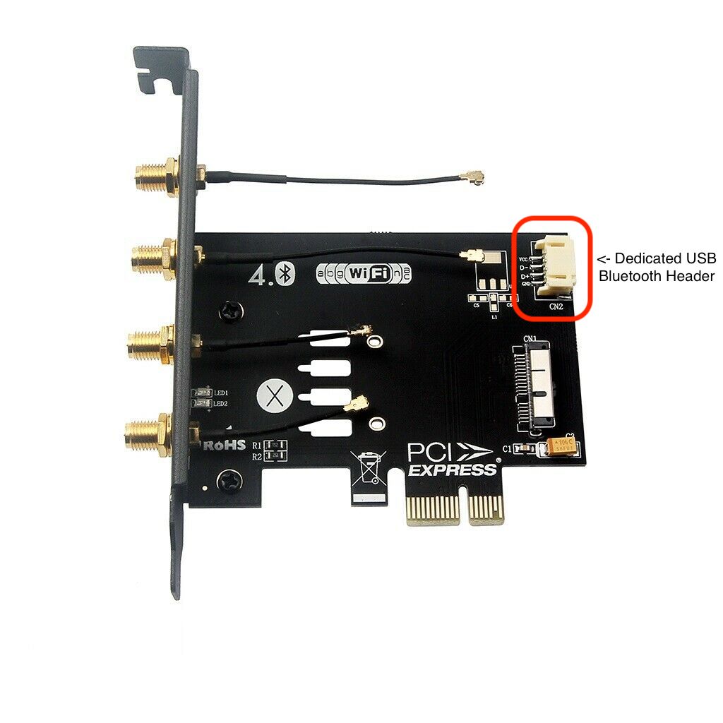

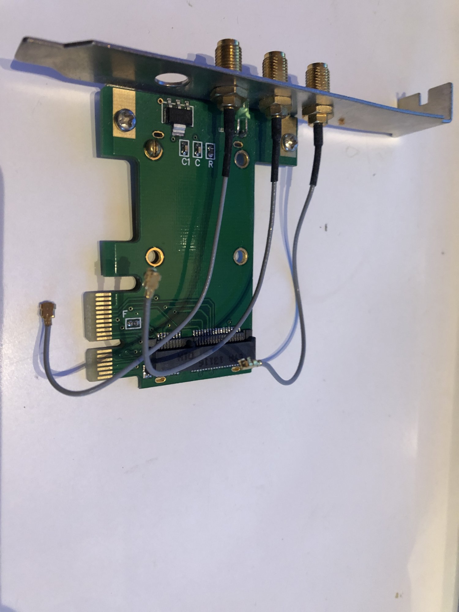

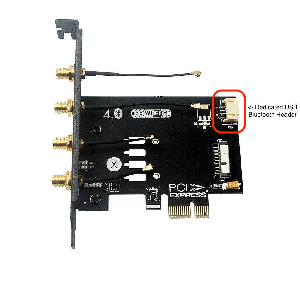

Might this PCIe 1x riser card bring back BT support to cMP 3,1 by adding an extra antenna and moving the BCM943602CDP card now in the mPCIe slot to it?
That exact adapter no, as there's no USB header to route. You'd need something that exposes a dedicated USB port you can manually plug in
Reactions: iMac-iPad
Can you recommend a PCIe riser that will do the job?
I had bought mine back in 2016 so a bit difficult to find the exact model however there's many similar ones online. Below is a 12+6 pin Apple Wireless to PCIe x1 adapter, in the top right you see there's a dedicated plug. This is used to route a USB cable from it to either an internal header or rear USB ports.
The one I own is extremely similar, main difference being that it uses a standard Mini USB socket and cable to route bluetooth. The exact connector is irrelevant, all that matters is that there's USB data lines being passthrough
Thanks khronokernel. I've scoured ebay, Amazon and Alibaba and cannot find the exact same card configuration. Plenty of 3 antenna port cards but none with 4 antennas and USB header. Have to keep looking.

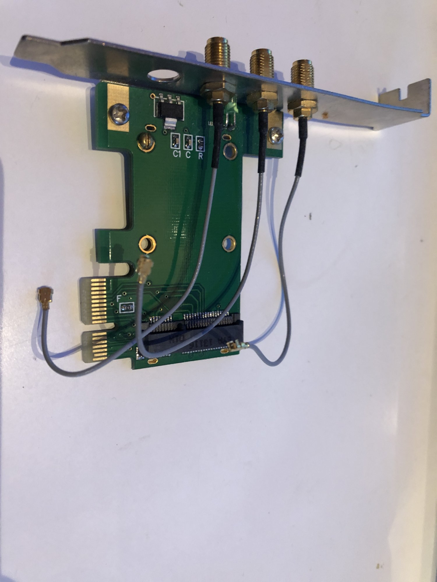

I can confirm what khronokernel said. That green mPCIe riser doesn't work in Monterey.
I used that in my USB3 mod to my iMac to hold my new Wifi/BT module in my iMac 2010 (see my signature).
But the Wifi/BT module is on another small adapter board with USB feeds before inserted into the mPCIe riser.
Both Wifi and BT work in Big Sur but not in Monterey.
This seems to hold the Wifi/BT module directly without an intermediate adapter.

On closer inspection of the mPCIe adapter card I am currently using between the cMP mPCI slot and the BCM943602CDP card, there is a pair of pins that are not connected but look like they might be pins for USB power. I will try to get a shot to post, but it is an awkward and dark/obstructed position. I wonder if bringing power to them from a back USB2 port might solve the issue?

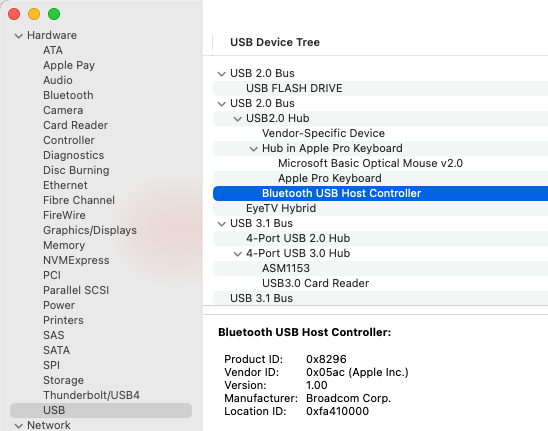

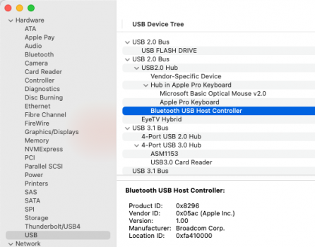

I'm happy to report that, following khronokernel's advice, connecting the data + and - wires from an upgrade mPCIe adapter to the middle 2 pins of a USB Type A plug works to get BT off the newer card (eg. BCM943602CDP) working with Monterey 12.0 beta 4...if the USB plug is plugged into a USB 2 or 3 hub.
As previously mentioned, I built a 4-port USB 2 hub into the lower back part of my 5,1 case. I saw a cheap 7 port hub today on eBay, with 5 outward facing ports and 2 on the back (which would be ideal to keep the BT/USB wires 'internal' and save having the USB cable otherwise dangling through one of the cheesegrater mesh holes to the outside). However, there'd be no reason not to do this [even as an experiment] - to plug the BT feed plug into a completely external hub, if you don't mind extra components and cables on the floor. Airdrop now works as expected. As I seemingly am lucky to also have my 2 Ethernet ports active, I'm now back to 100% hardware functionality with Monterey. Apple better not change anything else before the RC!
NB. I also had to connect my wired Apple Extended keyboard into the USB 2 hub I added, as it didn't work plugging it into one of the back USB 2 ports when running Monterey. I have a Microsoft USB 1,1 mouse plugged into the keyboard hub. Maybe that was why the MP5,1 wouldn't recognise those devices. Everything was fine using the back ports with all of the Big Sur flavours.
