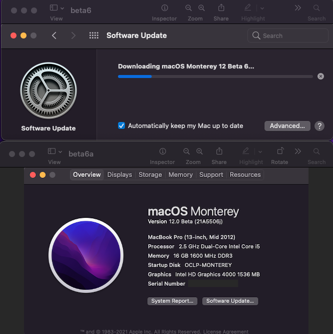

Monterey beta6 is up, working well OCLP 0.2.5
I can't understand. Why when i click to update from software update to beta 6 after restart i'm again with beta 5. Anyone else with the same issue?
P.S. I used oclp 0.2.4 stable and macbook pro 15 2014 mid
Reactions: macpro_mid2014

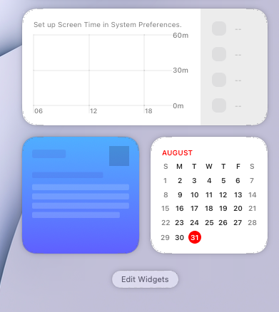

Anyway to improve on this? Monterey on Macbook air 2012 using OCLP 2.4. It looks fine on Big Sur. Tried external monitor, airplay, always get these artifacts but only on the widgets, everything else look fine.
Reactions: thienluong89
I used to have the same issue. What happens is that after the 30 minutes of the Preparing state, the computer starts to show an apple logo with a progressing bar below it (no time count).
THEN, the computer restarts AND you have to have the OPT key pressed so it boots to EFI and then you select the macOS Installer option which is created during the first part of the update.
IF instead of macOS Installer you select the disk where the update should be installed, the installer shows an apple logo with a 5 minutes progress bar and when you get to the OS, the update did not happen.
So, you need to make sure you select macOS Installer (or the other disk which had been created during the first phase of the update.
This is what happened to me and how I solved my problem.

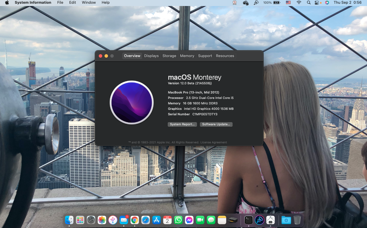

Hi everyone, just finished updating my MBP mid 2012 non retina to macOS Monterey Beta 6 using OCLP 0.2.2. Still needed to use sudo kill in order to enable bluetooth but all works perfect including Safari.
Reactions: macinfo
