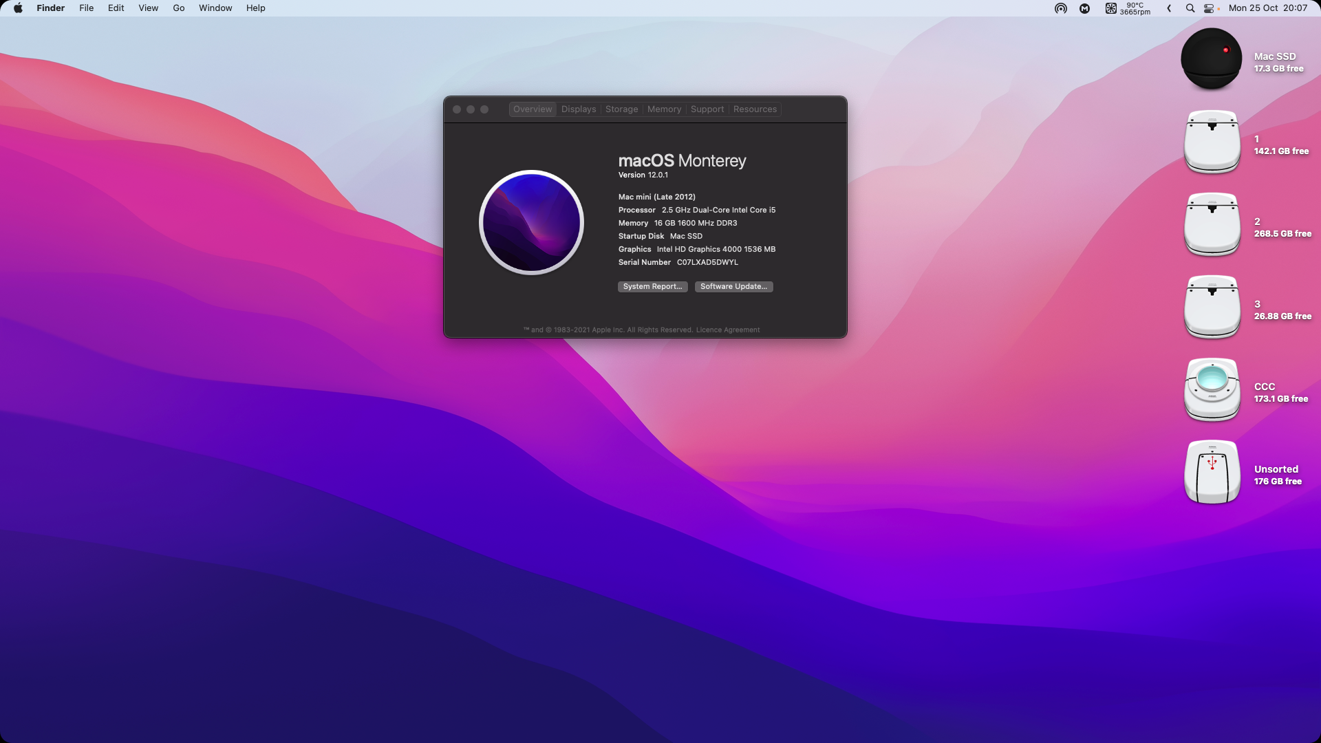

Everything works flawlessly... except Airdrop. I can transfer data iPhone -> Mini but not iPhone <- Mini.
No biggie as this is an RC which may get ironed out with further development of Universal Control.
A huge thanks to @khronokernel / @dosdude1 / @dhinakg and the rest of the Dortania team for their work on OCLP!

View attachment 1877793Everything works flawlessly... except Airdrop. I can transfer data iPhone -> Mini but not iPhone <- Mini.

↑ That desktop looks quite nice, even without a notch. ;)
I’m curious, what did you use to get the rounded corners on the menu bar and the bottom corners?
