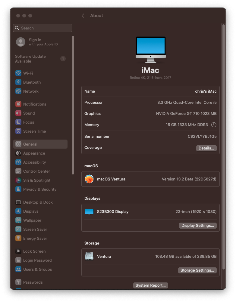

Still trying to figure out why many macOS Icons won't show in the Menu Bar? Date Time ect..
oclp v0.5.4n 13.2 22D5027d on cMP 5,1
maybe it's because of beta 13.2?
I am running 13.1 on a 4,1/5,1 with OCLP 0.5.3 and have not yet received an offer to update to 13.2 beta. My Coffee Lake hackintosh got the OTA update a while ago along with the Security Response update and is working well. Ventura on the 4,1/5,1 is not as smooth as with Monterey but time will tell.

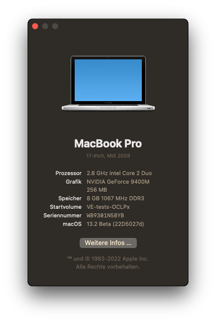

Another Ventura exercise on MBP5,2 mid 2009:
Starting with 13.0 on an external SSD. Using latest OCLP 0.5.4n (last commit regarding comments for UHCI/OHCI) for EFI and root patching. Monterey, just updated OTA to 12.6.3, remains on internal SSD.
OTA update to 13.1 went fine. Applied root patches, fine. WIFI working!
OTA update to 13.2 beta went fine. Same with root patches.
KDK handling (load, install/merge) worked well.
Tried also the Rapid Security Response 13.2 (a), known result: message that update preparation failed. According to khronokernel's comment cited earlier, no use to try further.
Also played a bit with the UHCI/OHCI in the hope to get internal USB 1.1 devices to work, esp. keyboard/trackpad, but no success. Looked at/modified resources/build/misc.py lines 196-205.
Despite that, Ventura on that machine is good enough e.g. to type this post. Thank you OCLP developers, looking forward to more testing.

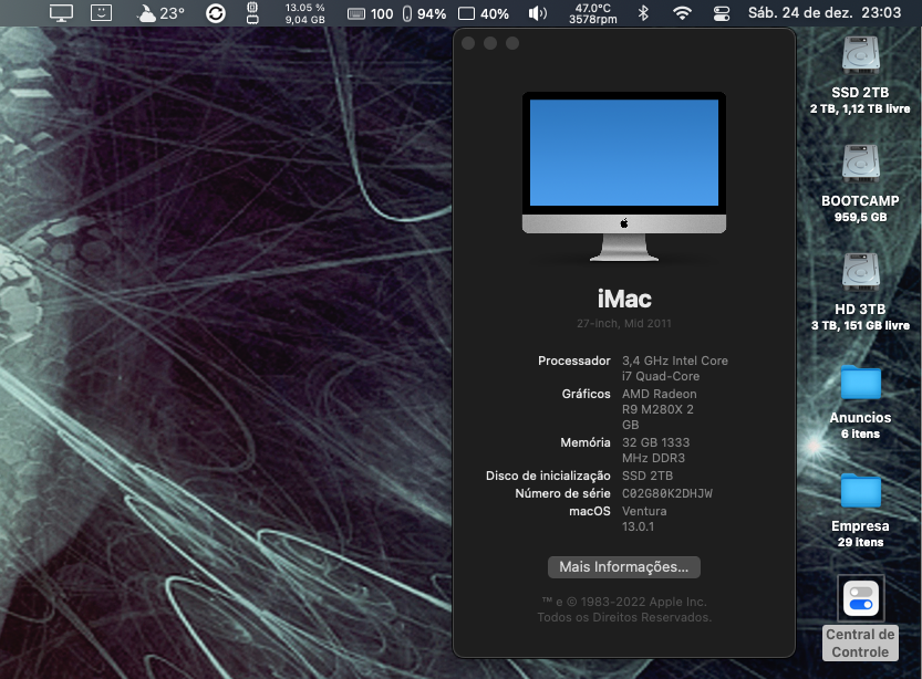

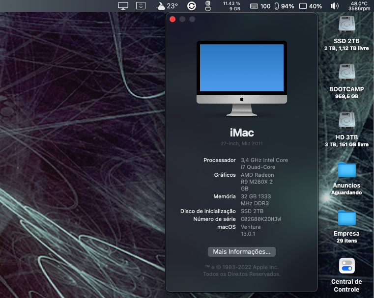

Trick to reactivate Control Center and related icons after WiFi Patch
I accidentally found a temporary solution to resolve Control Center after Wifi Patch on my iMac12.2 (27-inch, Mid 2011). The solution is to launch the Control Center from another path via Terminal
The Control Center app is located at "/System/Library/CoreServices/ControlCenter.app"
Copy the app to another place (in my case I put it on my desktop)
Right-click, then "Show Package Content". Then "Contents/MacOS/" and run the file "ControlCenter"
The window that opens from the Terminal CANNOT be closed, otherwise you will have to do the process again
Very nice temp fix! Thanks!

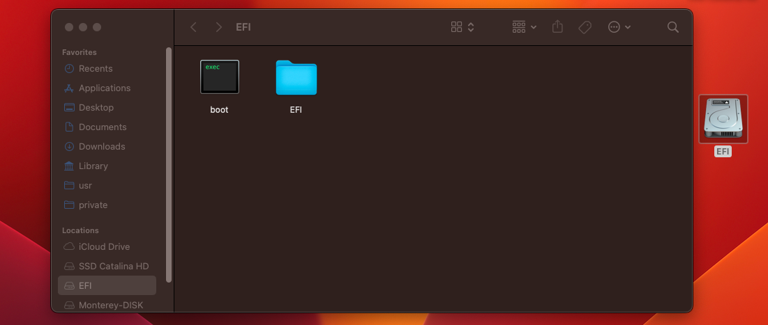

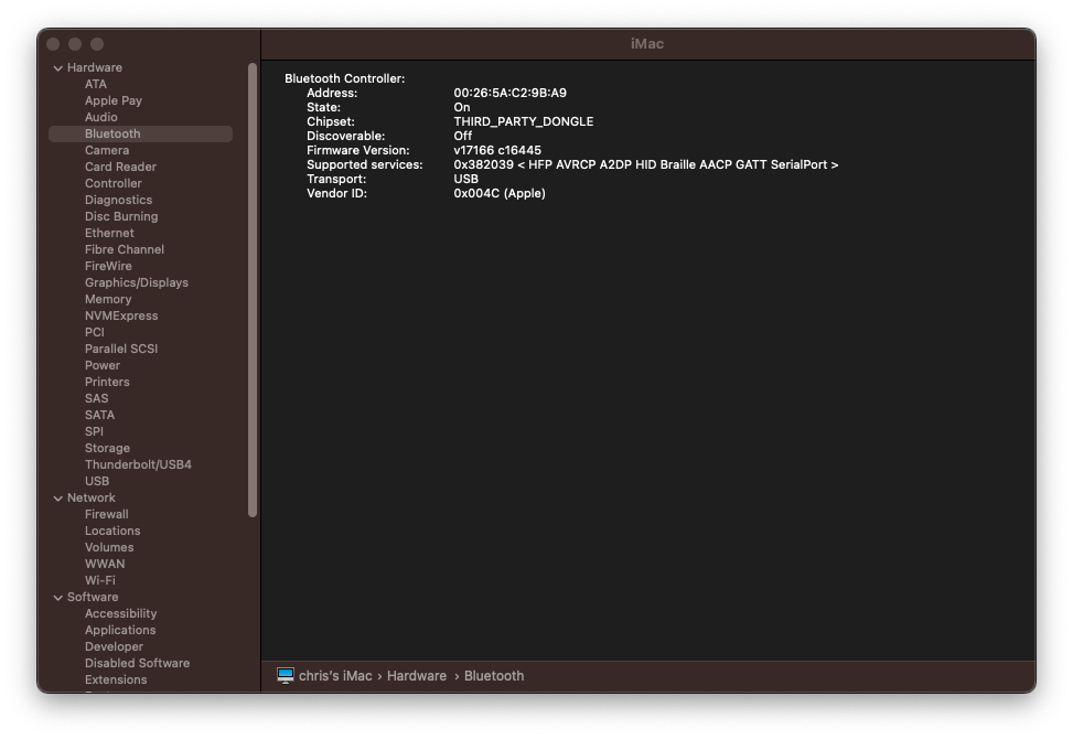

I will share some amazing experiances with a Verry Old PC
DELL Optiplex 790 (i5 2500 k Intel HD 3000) Geforce GT 710
It run from Catalina to Ventura 13 OCLP 0.8.5 OpenCore 0.8.6 Duet
I want to thank all the Dev's and all those who work in the shadows and also all the testers of all the Mac and Hackintosh Forums!
A verry old Bluetooth D-Link BT 122 :D
Everythings work smootly this machine is really amazing

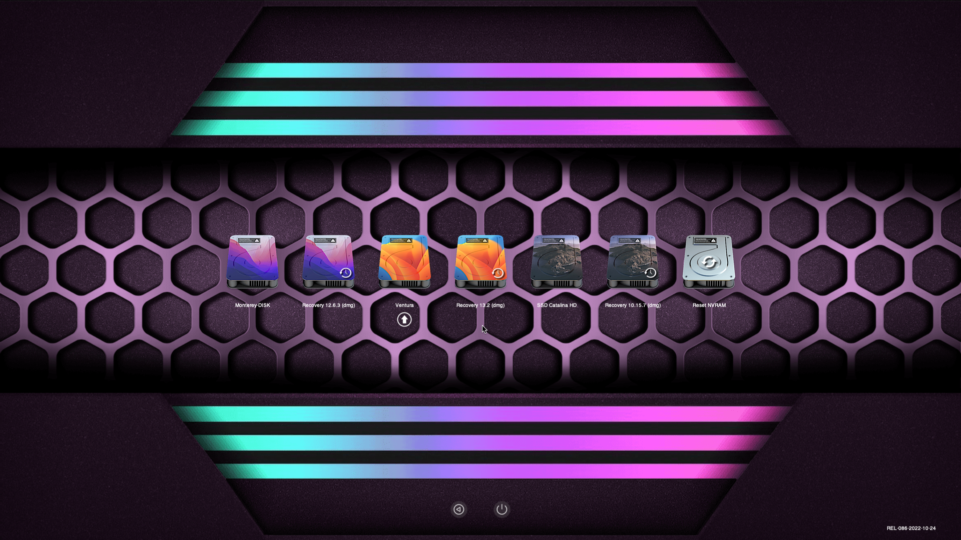

Booting 3 system with OC 0.8.6 Duet
