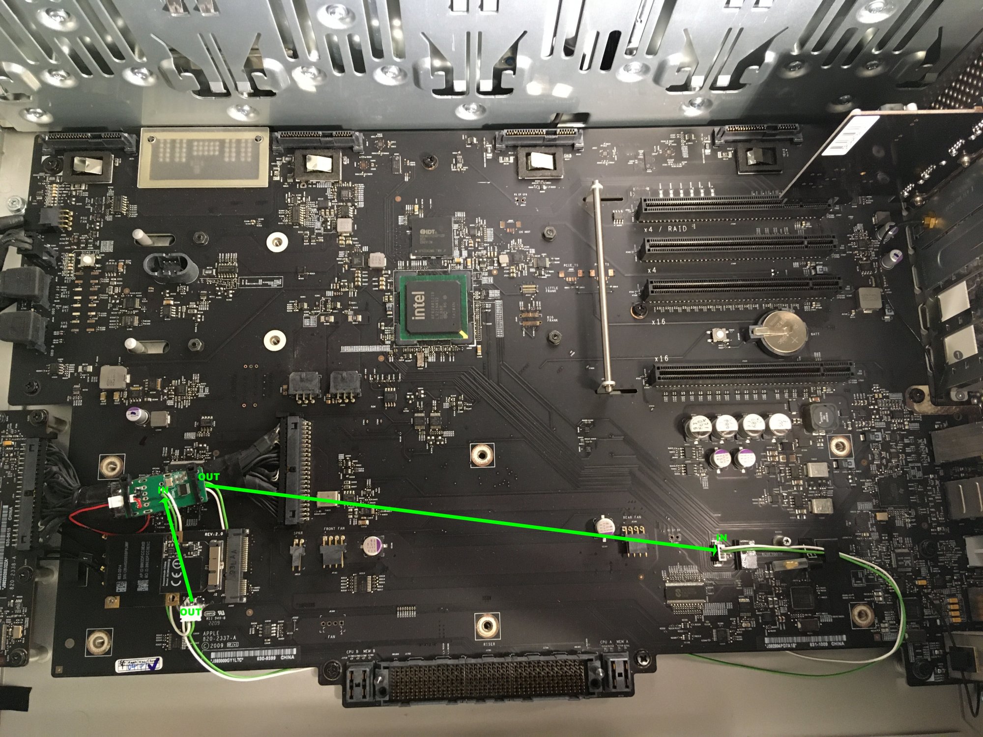

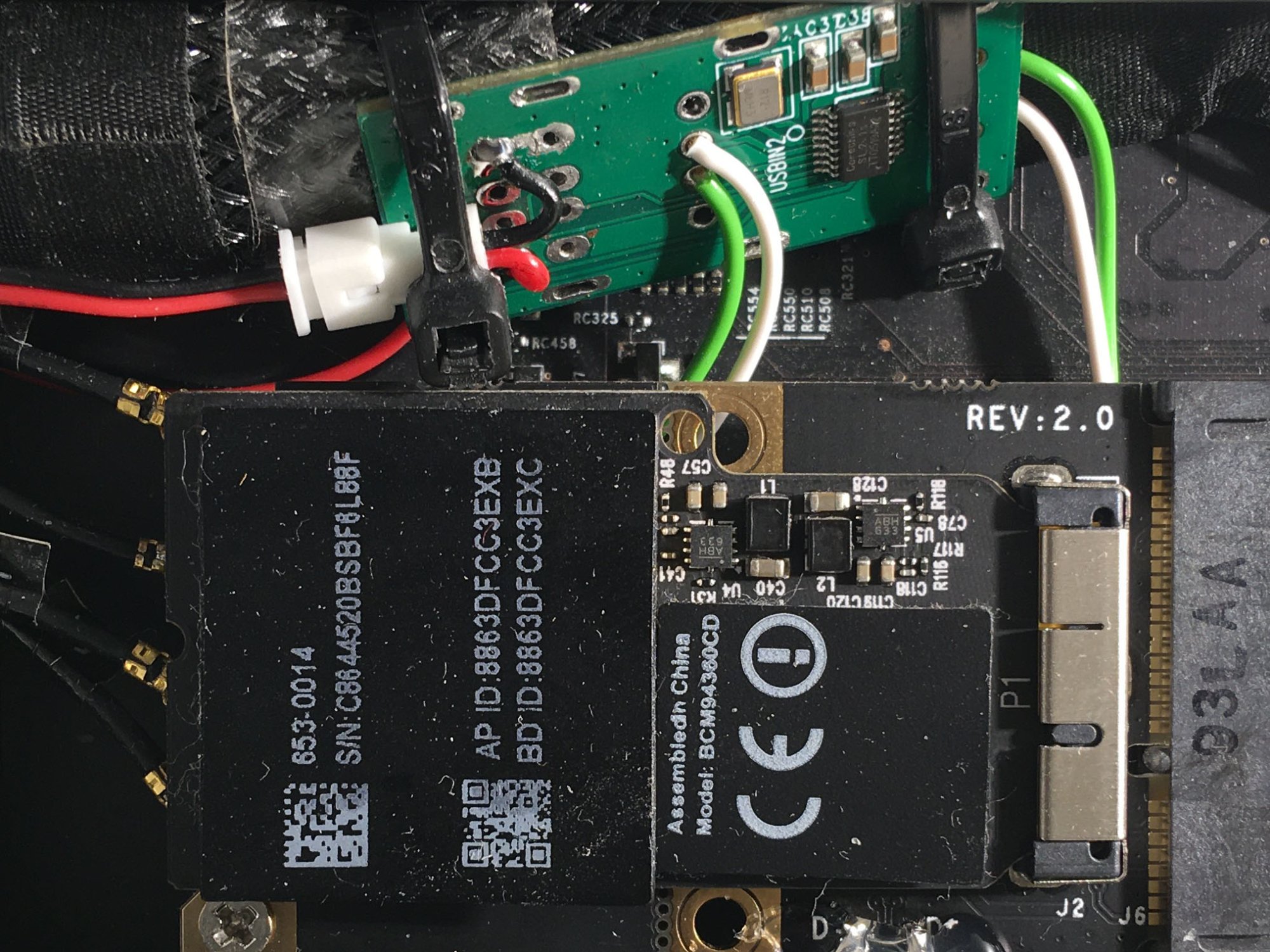

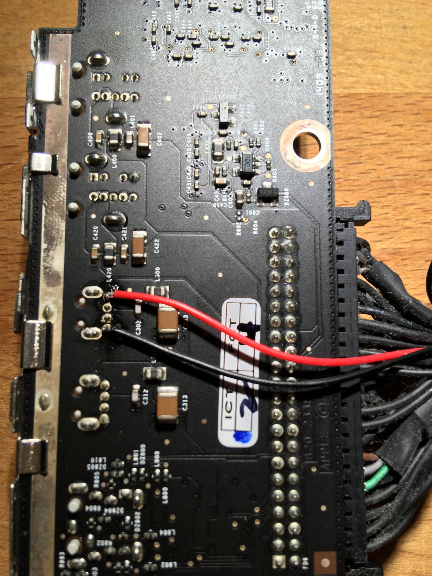

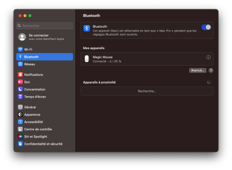

Today I installed in cMP4.1-5.1 a USB Hub (with SL2.1s chip) in order to get the Bluetooth in ventura.
I powered it with +5V by soldering 2 wires under one of the 2 USB ports of the front panel board.

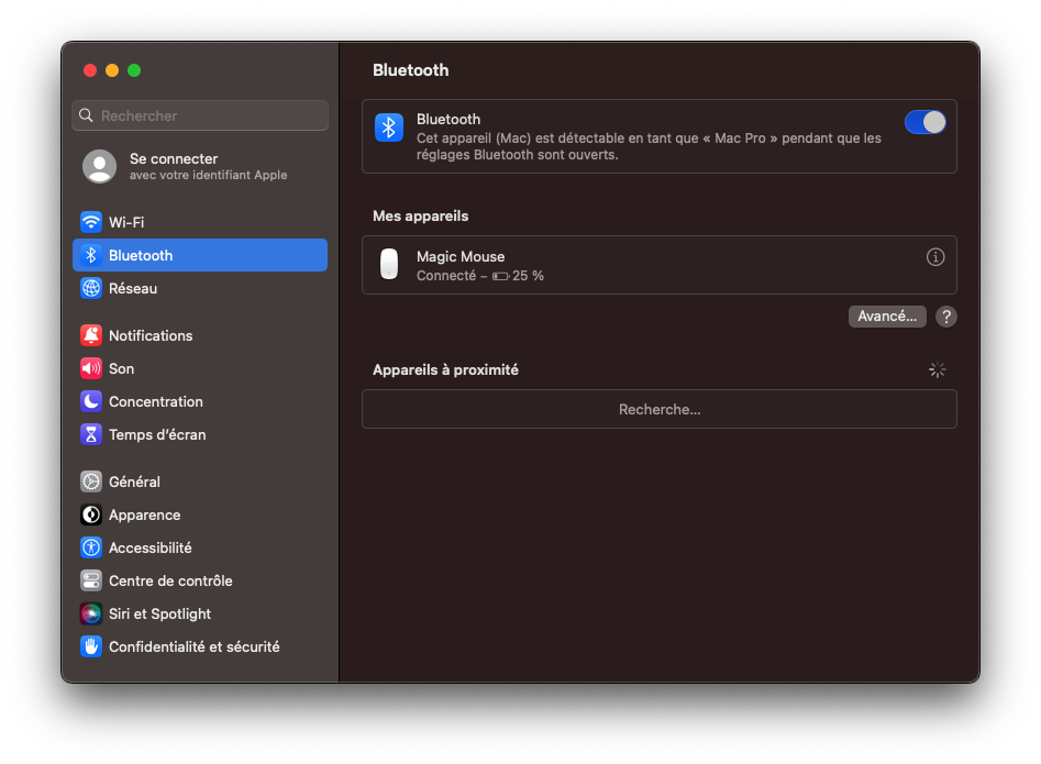

It's nice to be able to use Magic Mouse with ventura again...
Please would you provide more details of where you supplied the +5 V to the PCIe adapter board. Did you use one or both the R1 pads. I have the same adapter and BT board as you and have WiFi with D+ and D- wired to USB but cannot get BT even with 3.3 V supplied to innermost pad of R1.

This is a clever setup. Care to share how you did this? Where you were able to source the PC board and where you made the connections to the plugged in Bluetooth/WiFi card and where you tapped in the power for the PC board? It would be nice to share this information so that other's with the 5,1 MacPro can replicate this and regain bluetooth support, thanks.
Can these components be easily ordered? Can you provide a link? How about some schematics?

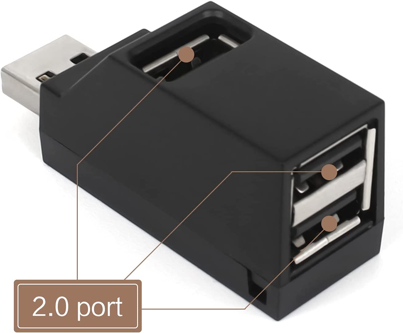

Hi @PeterHolbrook
I bought a set of 2 USB 2.0 hubs from Amazon.fr but you can also find them at Amazon.com and on eBay
I removed the plastic shell and unsoldered all the USB plugs to get only the board.
For those who don't want to remove the plastic case and desolder the USB plugs, there are ready to solder modules on eBay...
The wiring diagram has been published message #2671 by @Larsvonhier
@nekton1
as I said in my previous message, I powered it with +5V by soldering 2 wires (+5V —> red wire and GND —> black wire) under one of the 2 USB ports on the cMP front panel board.
The USB data, D+ (green wire) and D- (white wire) from the output of the Mini PCI-E adapter card connect to one of the 3 USB 2.0 inputs of the hub card (D+ with D+ and D- with D-)
The USB data, D+ (green wire) and D- (white wire) from the output of the hub card connect to the JST GH 1.25mm socket of the old Bluetooth card.
It's as simple as that...

I powered it with +5V by soldering 2 wires (+5V —> red wire and GND —> black wire) under one of the 2 USB ports on the front panel board.
I'm not sure I interpret this correctly. It seems to me that "the front panel board" refers to the cMP itself, correct? If so, does the soldering of those two wires somehow thwart the regular operation of the cMP two front USB ports? Will they still work after putting this USB hub in place?
Hi @PeterHolbrook
Correct, the front panel board I mentioned is the one from the cMP (with the audio output, the 2 USB ports and the 2 FW ports).
No, not if you weld correctly with the right tools.
Yes, only a very small part of the power supply of the USB port is used (I think I read on the datasheet of the SL2.1s chip that its consumption was between 50mA min to 120mA max) so this port still works after the installation of this USB hub. I made several tests with different USB sticks and external hard drives, all worked perfectly.

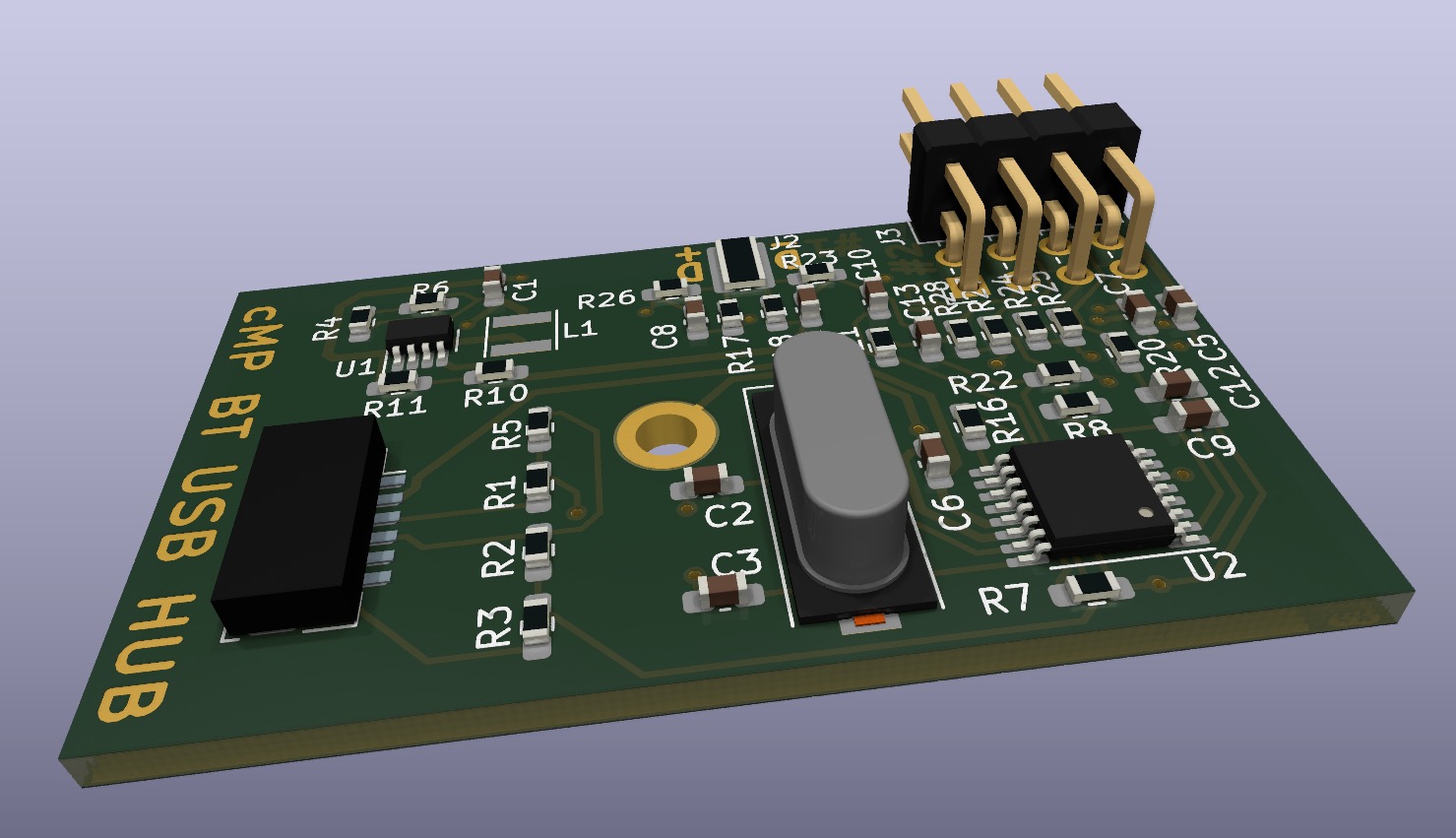

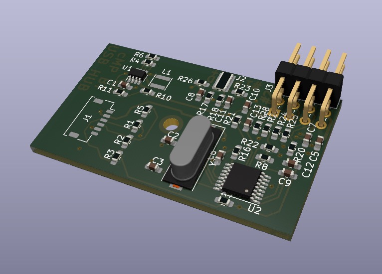

The place to take the 5V for supply from is a good one, esp. as it is not directly on the mainboard (who would want to solder there without a good reason). One improvement would be to connect to the "fat" ceramic cap nearby instead of the USB conn. pins. This decouples the supply better from possible ripples that occur when plugging in or detaching external USB devices to the outer front jack. Makes the BT hub function a bit more robust. (While it still does not cure the effect that overcurrent of external devices switches off the port supply altogether, thus disconnecting the BT devices...)
btw, the FE8.1s chip can be supplied by the 3.3V from the 4pin socket directly, perhaps that would be possible also with the SL2.1?
(On my upcoming board revision -see rendering- I´ll make use of that FE8.1 feature and will not need the additional USB supply cabling).

Hi @Larsvonhier
Right, the SL2.1s chip can also be powered with 3.3V (to use the power supply of the original Bluetooth card) but I would have had to modify the PCB of the USB hub... I didn't do it because I wanted to test quickly that's why I used the 5V power supply of one of the USB ports of the front panel. You are right I should have wired on each side of the C303 capacitor for more stability, but I almost never use this USB port (this modification will be for version 2.0 ;)).
However I really like your idea of a designed board to replace the old Bluetooth board as it simplifies the wiring.

Won´t disparage me at all, thanks for the link to the Titan-based solution with additional hub. Did not know about that...
For those who have not invested the $100 for the "Ridge", I still think my solution will be as compact and tidy as it gets.
Plus two optional OOB-working 2.0 ports that start working directly on power-up (for boot selection via attached keyboard, etc.)
Card is already in production (again) with the FE8.1 chip this time. Stay tuned...

ah, nice - so the only feature that my hub design will have is to supply a decent amount of current on the 5V it also generates (without having to hook it up from somewhere else) for external extra USB ports. Also the original Apple cable (that connects from mainboard to BT module) can be still used.
Besides, if demand is there I´ll manufacture some for interested users here.
If not, they go to the cMP equipment we use in our office... ;-)
Reactions: cdf
Yes, I think that's the novelty with your design. I focused on just the USB data lines (and TBT header logic in my most recent design). I was uneasy with drawing too much from the internal header as the header in the Mac Pro was designed really just for the original BT module.
