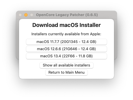

Apple has now fixed the error and now 22F66 is offered. It's only my third download...🙈
Did you actually get 22F66? I downloaded the installer pkg file from Mr. ... just now and when trying to use it with OCLP to create a USB installer it says "22F59" in the Use existing Installer window.
Not sure if that info is correct or a glitch in the build info reporting.

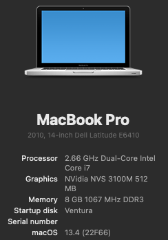

My upgrade from 13.3.1 (not RSR 13.3.1a) to 13.4 on my MBP6,2 (NVidia Tesla) using OTA was flawless. I started with 13.3.1 patched with OCLP 0.6.6n (17 May 2023) and was notified automatically about the existing 13.4 upgrade. I downloaded the upgrade through normal Apple OTA channels (didn't need a separate website or download link). The only minor issue was that Open Core 0.9.2 did not automatically choose "Install macOS" to boot after the first macOS installer reboot. I needed to manually select "Install macOS" from the OC boot picker. After the installation, OCLP automatically prompted me to re-install root patches. So far, 13.4 seems to run as well as 13.3.1 on my MBP6,2.

First, tried downloading the installer.pkg file from Mr. Macintosh's site, but when trying to use it with OCLP 0.6.6n to create a USB installer it says "22F59" (the real 13.4 version is build 22F66) in the Use Existing Installer window. Still not sure if that info is correct or a glitch in the build info reporting. Next tried using OCLP to download the install macOS, and I get the same "22F59"! Apple's servers are in error or the OCLP app doesn't read the build # correctly.
In either case, that makes for uncertainty!
Still 22F59 after tried 3 different sources including OCLP, gibMacOS, and Apple. It seems some caches on the server / Internet have not been updated: will wait for a day or so.
Just to make things even more mysterious, I used that "22F59" download to install Ventura on an empty SSD I had, and after the install, the installed Ventura version was 22F66. So I assume that the OCLP app is misreading the build version or the Apple installer file has mistaken info in the build.
In any case, your idea of waiting a while may be the best indeed.
