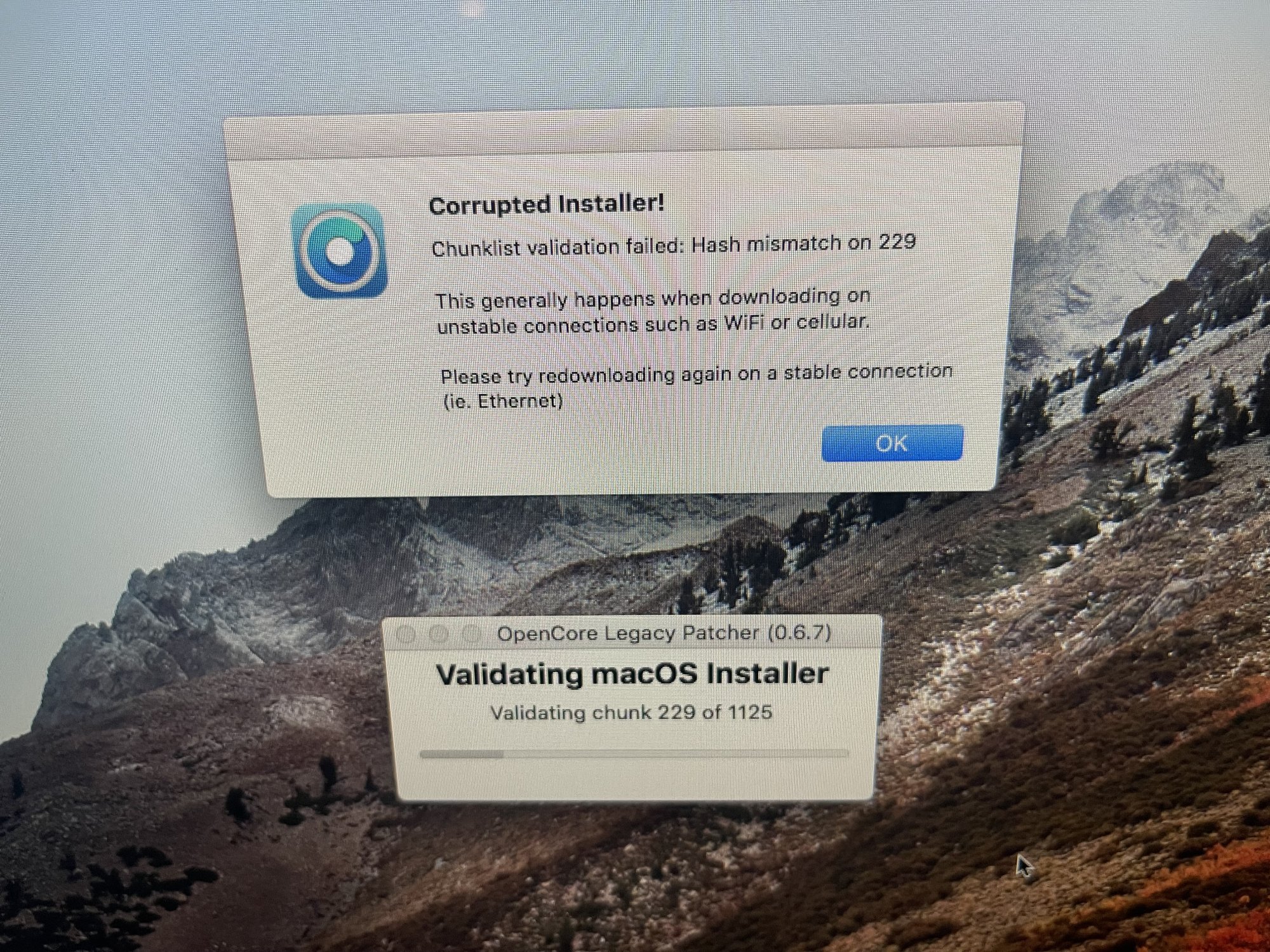

Update Cannot boot into safe mode: Acting on Howser's suggestion to reinstall OS, I recreated the USB installer using 0.6.7 and Ventura 13.4. I. Installed Opencore to disk. I was able to access Safe Boot without needing to reinstall Ventura OS. Thanks Howser for your suggestion. Much appreciated
Reactions: houser
Trying to create Ventura installer from open core legacy patch for my 2012 iMac 27” desktop, but always receive this error, see attached. Does anyone know solutions?
Thanks,
