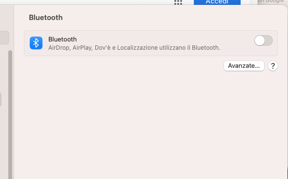

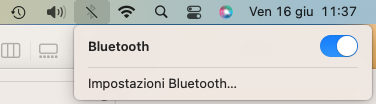

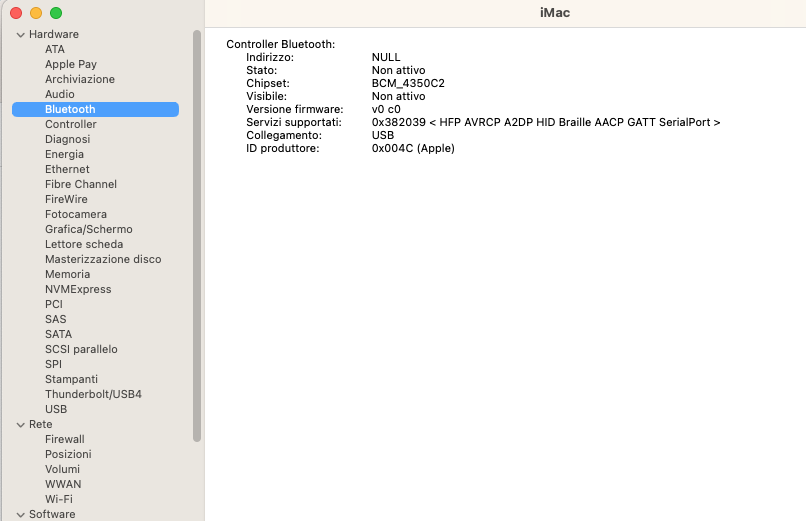

good morning... for a few days suddenly a problem with built-in bluetooth (BCM_4350C2) works partially... iMac 12.1 21" 2011, ventura 13.4 and OCLP 0.6.7 or 0.6.8n, when you start the mac bluetooth is disabled, it is possible to reactivate it but it does not detect anything and the icon says it is deactivated... I use the Magic Mouse which however works partially, everything except scrolling, but it does not appear in the list of devices... if I go to bluetooth settings the lever for activating the bluetooth does not work, sometimes it is possible to drag it and activate it but it does not detect any other device even though the Magic Mouse works partially; I had paired bluettoh headphones but now they are no longer detected ... in the system report the bluettoh appears NOT ACTIVE

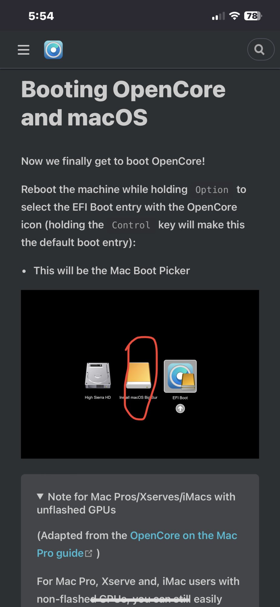

PLEASE HELP!
I only have one iMac 2011 and few hours ago I was trying to use this opencore legacy patch to upgrade to Ventura, I have read many posts before I actually do it, and I tried to follow it steps by steps, I accidentally click the “Install MacOS Ventura” before click into the “EFI boot”, then my screen went white with some green line pattern and STOP!
I have no choice but reboot my iMac, then it’s all black screen no matter how many times I boot it, zap NVRAM, SCM, and safe or recovery boot, it’s all black screen!!! I can see the screen with back lit light but nothing show up at all! I am so screwed now! Can anyone help and give me some hints or help??? PLEASE!!!
I'm not sure if this helps you (can only be determined with testing)...
The OpenCore EFI generated for your iMac12.1 includes two bluetooth kexts:
Problems with BlueToolFixup.kext that affected Ventura 13.4 (possibly 13.3x) have been fixed with new commits. These changes have fixed problems with Bluetooth on my MBP6,2. The fixes aren't available in current release versions of OCLP; however, if you are technically proficient with Open Core, you can apply these fixes to test without waiting for a new OCLP release.
Reactions: K two

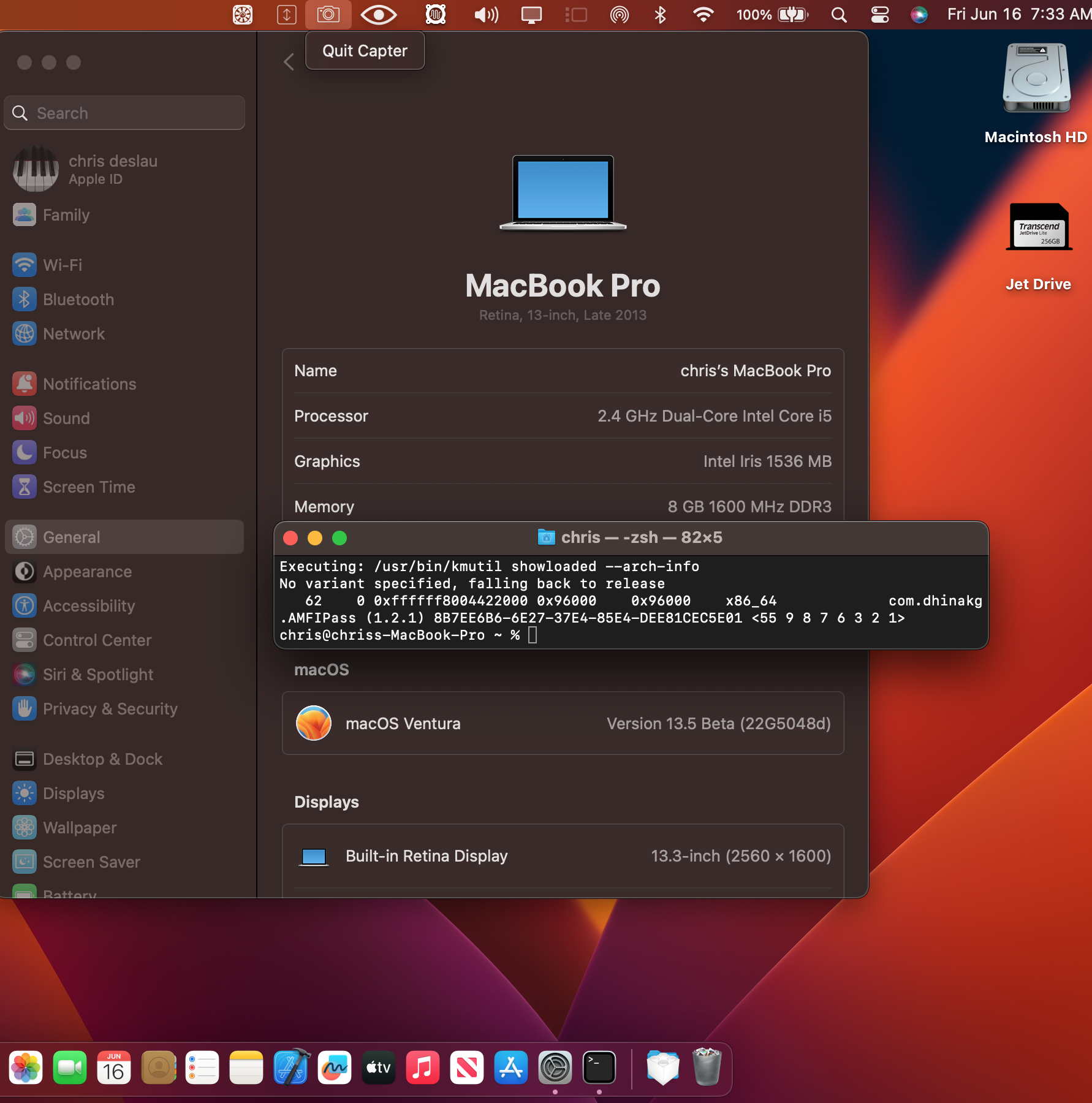

Imac27 late 2012/13,2, Ivy Bridge. I had been on the AMFI beta, I downloaded the 6.8n, installed, and noticed in the security settings the disable AMFI box was checked, I did not change this. I installed the new 16.5, beta 3, that went very well, and after rebooting was asked to patch again, after rebooting I opened OCLP again and the box saying disable AMFI under security was still checked, I did not change anything.
ok thanks… I'll check the links you indicated and try to figure out if I can solve it
View attachment 2219118PLEASE HELP!
Anyone able to help???
ok I injected, with opencore configurator, the new kext "BlueToolFixup.kext" version 2.67 dated June 12th 2023, 2.66 was present, but it didn't work, it seems to me, the problem with the partial functioning of the bluettoth remained.
I don't know if what I did was right... in the new packages there are also other kexts concerning bluetooth "BrcmBluetoothInjector.kext" and "BrcmBluetoothInjectorLegacy.kext" also version 2.6.7 but I didn't inject these
Which OS version were you upgrading to Ventura from? Have you created a USB installer for Ventura? Do you have a back up of your data?
My iMac os is 12,2, still in high sierra! Yes I made that usb installer according to the instructions, and luckily I do backup everything! But still, I want to fix it and hope there’s a chance to save it
Did you try to boot with alt key pressed ?
Did you update to the very last release of HS before trying to upgrade as there may be a firmware update needed if you didn’t.
