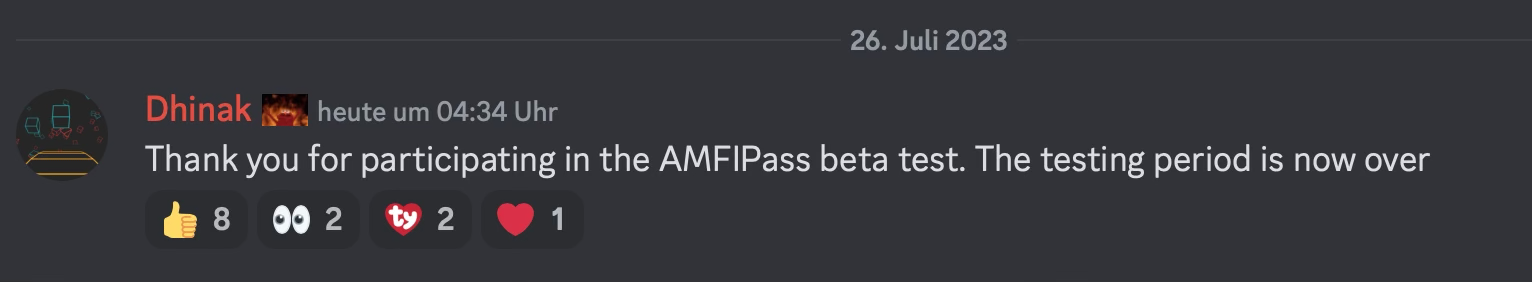

BTW: AMFIPASS beta has been finished - you all need to wait until a new release will be posted. No ETA.
OCLP amfipass-b4 Download gone

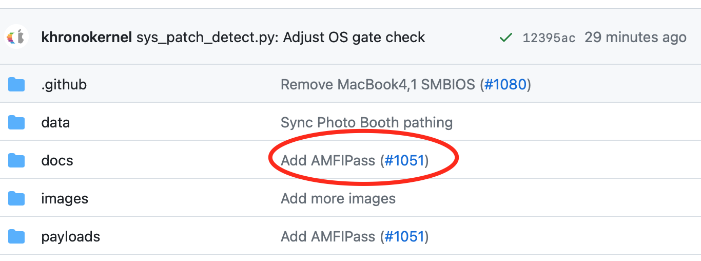

Hope that amfipass would be implemented in 0.6.8 😊

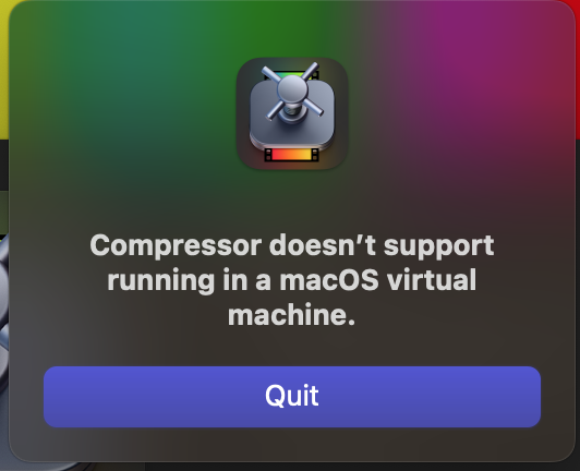

Also, OCLP 0.6.8 is still employing the "old" VMM spoofing (VMM kernel patching) instead of the new sbvmm fix for RestrictEvents.kext. This means that OCLP 0.6.8 users may still experience app complications with VMM.

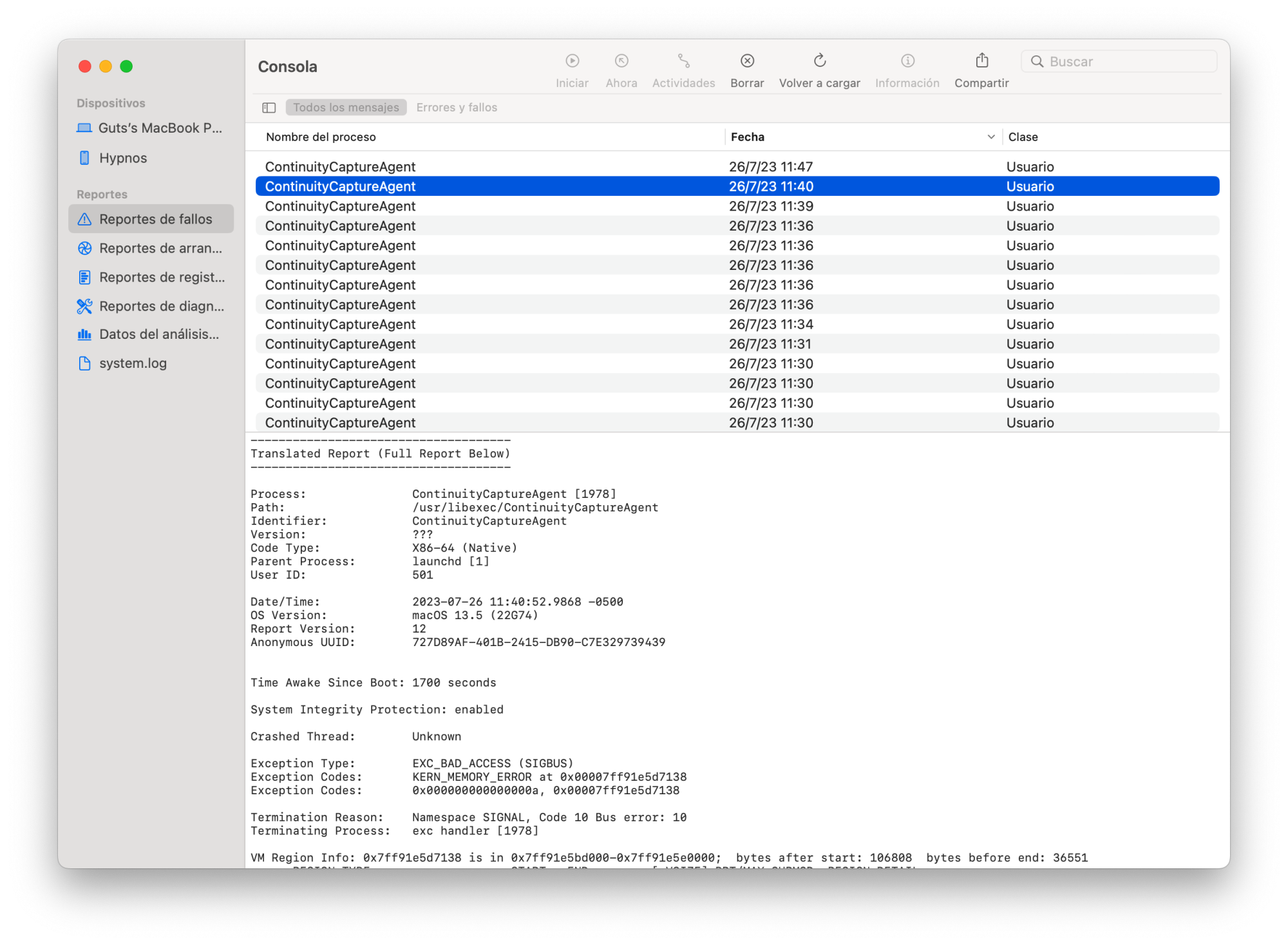

OCLP 0.6.8, continuity camera not working, always black black screen, always CRITICAL] -[AVCMediaStreamNegotiator initWithOffer:eek:ptions:error:]:477 Failed to init AVCMediaStreamNegotiatorSettings for mode=3.
