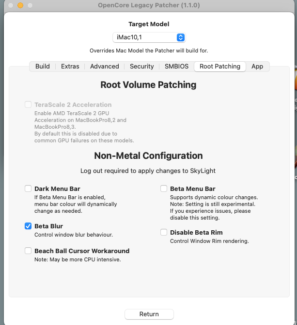

Except that for the time when I was running the patches, and before the needed restart, I actually had a normal looking menubar. White, reasonably thick and separated quite distinctly from the Desktop background. I thought that was going to last. Unfortunately, after the restart it's back to the thin, undifferentiated greyed out menubar I've been complaining about since I started this project. Wish I could find some way to get that back again.
Just a thought: Have you tried changing the menu settings under "Non-Metal Configuration" (->"Root Patching")?

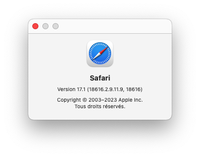

For macOS Sonoma, is Safari Version 17.1 included in the full-installer (InstallAssistant.pkg)
Which build is the latest Safari Sonoma Version 17.1 (?) ?
Thanks
Camelia
Hi @camelia
You are not on the right thread to post your question...
To answer your question I confirm what @INK1 said,
Safari 17.1 is contained in the installation package, after checking its contents it seems to be version 19616.2.9.11.7

My iMac 2010 is running Sonoma 14.1 and the Safari version is 17.1 (19616.2.9.11.7)

Hi @camelia
Thanks. What would you suggest trying there?
(Apologies for the blurry screenshot -- original looks sharp enough)
EDIT: just tried a number of them. Only one that has any effect is dark menubar, which helps a little for visibility.
