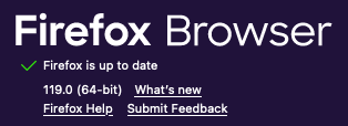

Not experiencing this "take a full minute" behavior with Ventura 13.6.1 patched with OCLP 0.6.8 on MBP6,2 (non-metal Nvidia Tesla).
Shouldn't need to run ESR, since Firefox still supports Ventura.

EDIT: Always post your OCLP and macOS version numbers when asking for assistance.
EDIT2: Are you requesting High Sierra support?
EDIT3: @RK78 I am guessing that if you are running FF115.4ESR in Ventura, that you upgraded to Ventura from High Sierra. If that is the case, you may want to upgrade Ventura Firefox to the latest version. If upgrading doesn't resolve the slow response problem, you may want to try removing and re-installing FF in Ventura.
