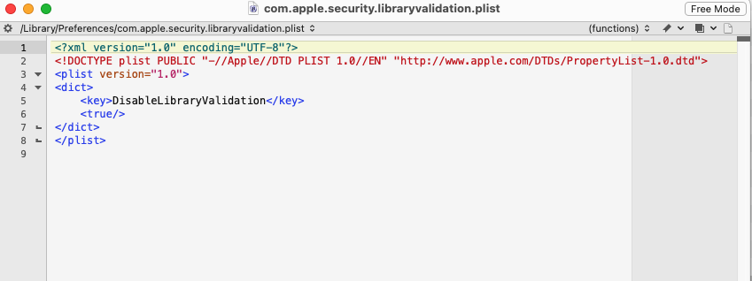

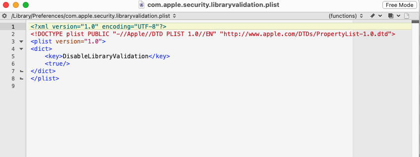

Can someone please tell me, re. Library Validation (not talking about Patcher Settings with option to disable): what should be the default, disabled or enabled? (Long story: ran sudo nvram boot-args=amfi_get_out_of_my_way=0x1, which appears to have disabled Library Validation, and which I have tried reversing so far with no luck).
Wondering if Library Validation disabled is needed to run OCLP
Seeing com.apple.security.libraryvalidation.plist set to disabled in /Library/Preferences
