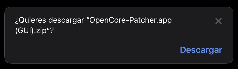

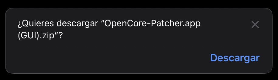

Thank you bu link is not working, 404
Do you have a GitHub account? It’s free. Without it, the file is not available. I can download the app from the posted link even in my iPad.
Reactions: shafez

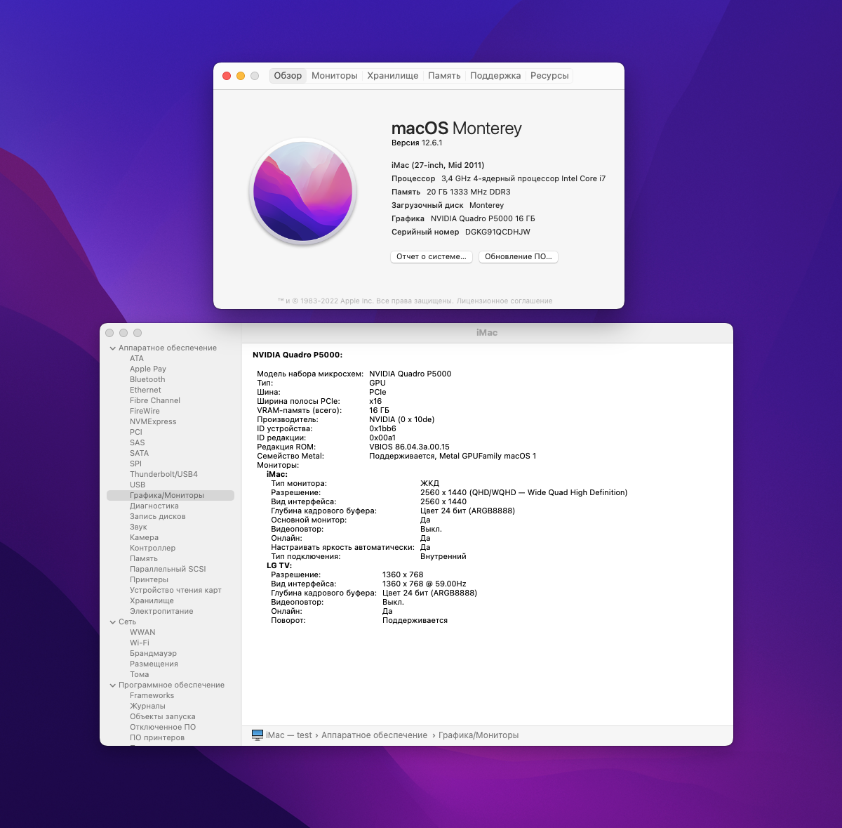

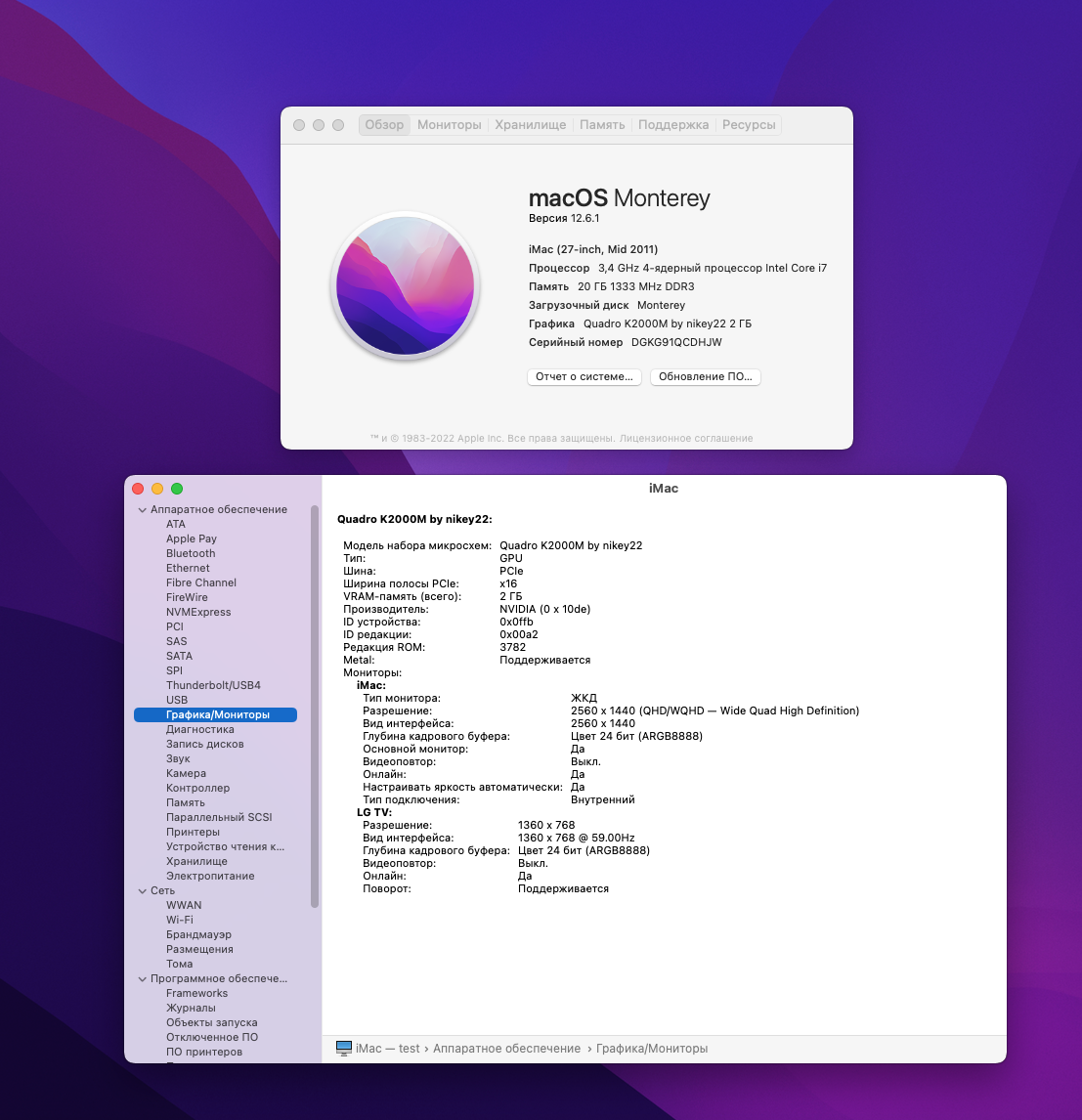

Quadro K2000M video card works in Monterey and Venture systems, metal works!
The Quadro P5000M graphics card runs on the Monterey system, metal works! And in the Venture system, it requires KDK. I don't understand. Why KDK??????????????????????? OCLP does not require KDK for K2000M. And for P5000M requires KDK. After all, the P5000M supports metal. I won't install KDK because it kills the graphics card accelerator!
Again, @Ausdauersportler already told you. Don't use the "Force Web Drivers" option. It forces your GPU into non-Metal rendering mode. The option is solely there for development purposes, no practical application for end users. I feel like I should put a paywall/password up on OCLP's settings.
And the reason there's a KDK check is the non-Metal would require a KDK due to the nature of IOSurface swapping. And there's no non-Metal support in Ventura at this time:
Also please be more respectful and stop acting like you're in authority. We have enough misinformation floating around due to this thread, would really like to clean it up. Remember, people a year from now will be reading this thread for research...

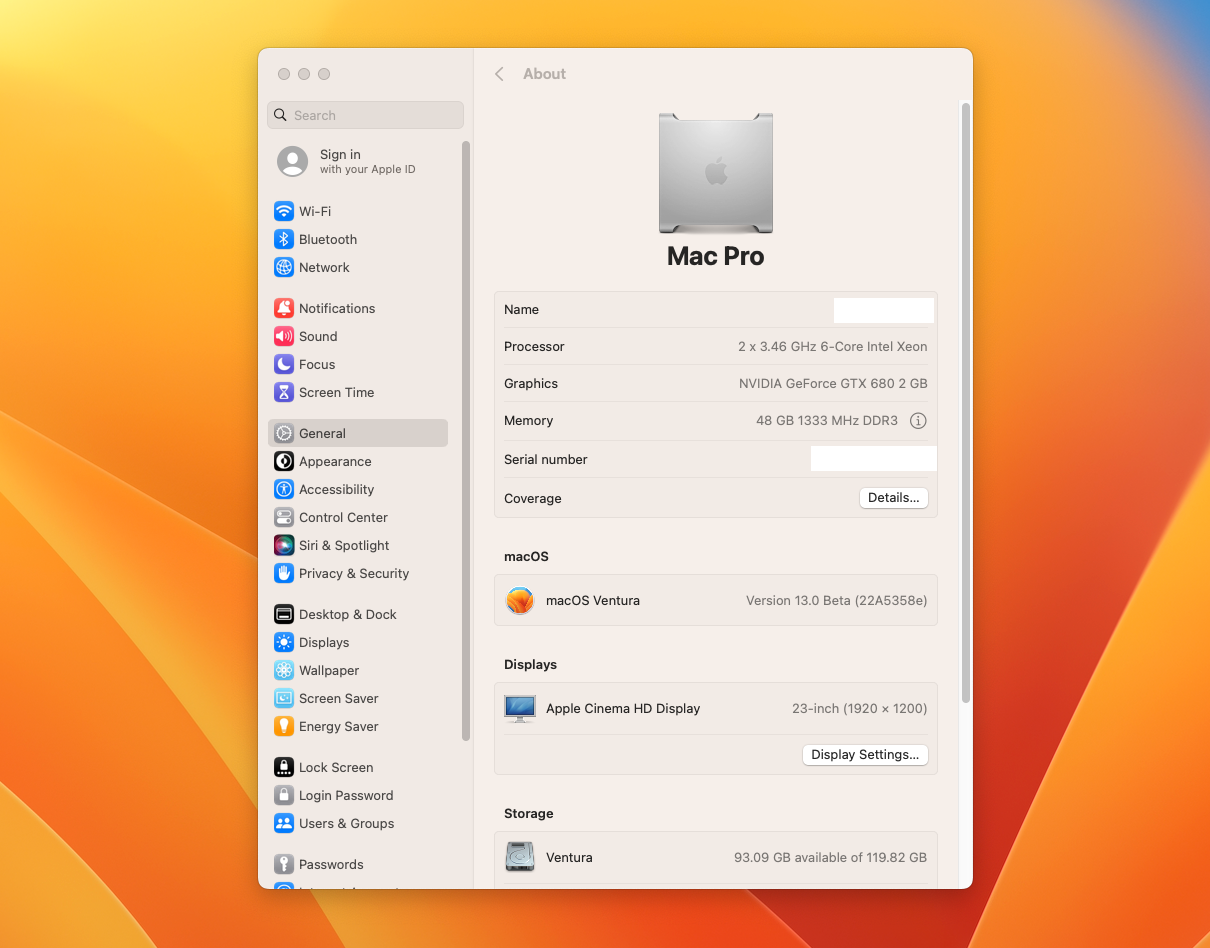

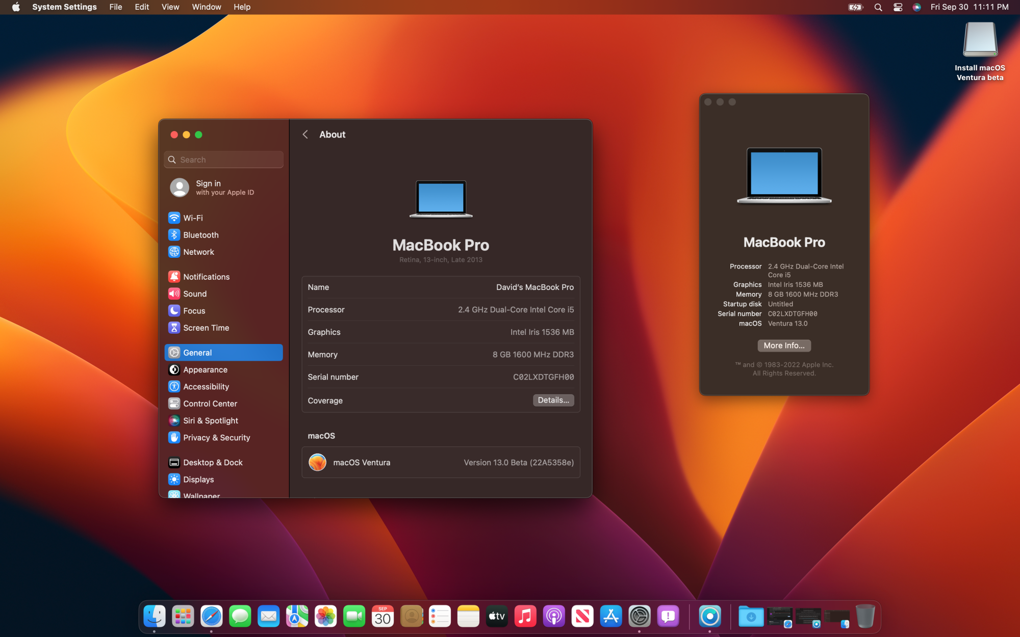

Welp I can say I successfully installed Ventura Beta 9? using the Alpha Patcher linked here on a 13" Late 2013 MacBook Pro MBP11,1 and it was incredibly easy too
Thanks For a Great Patcher

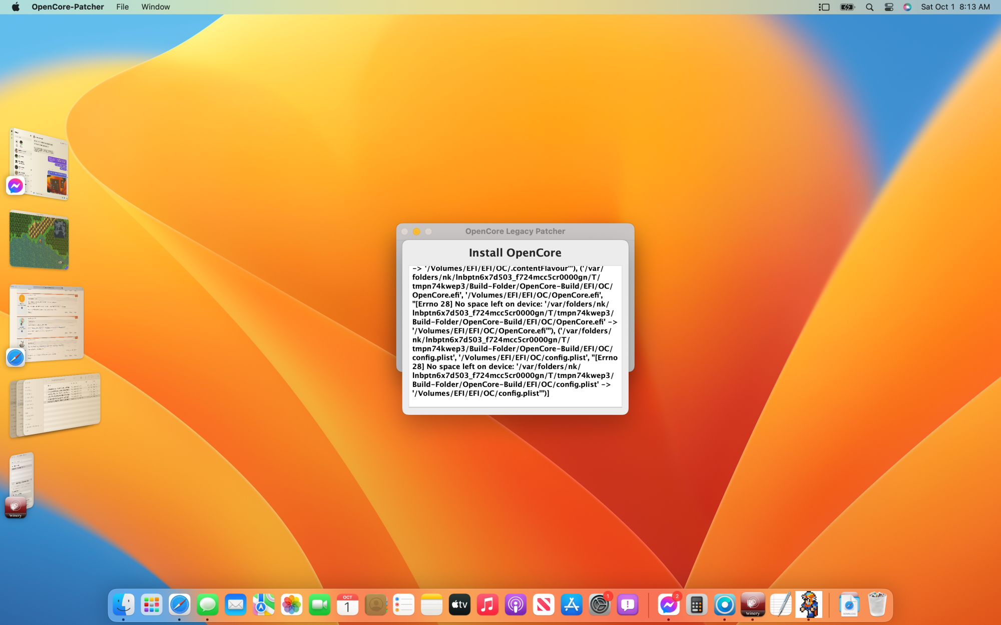

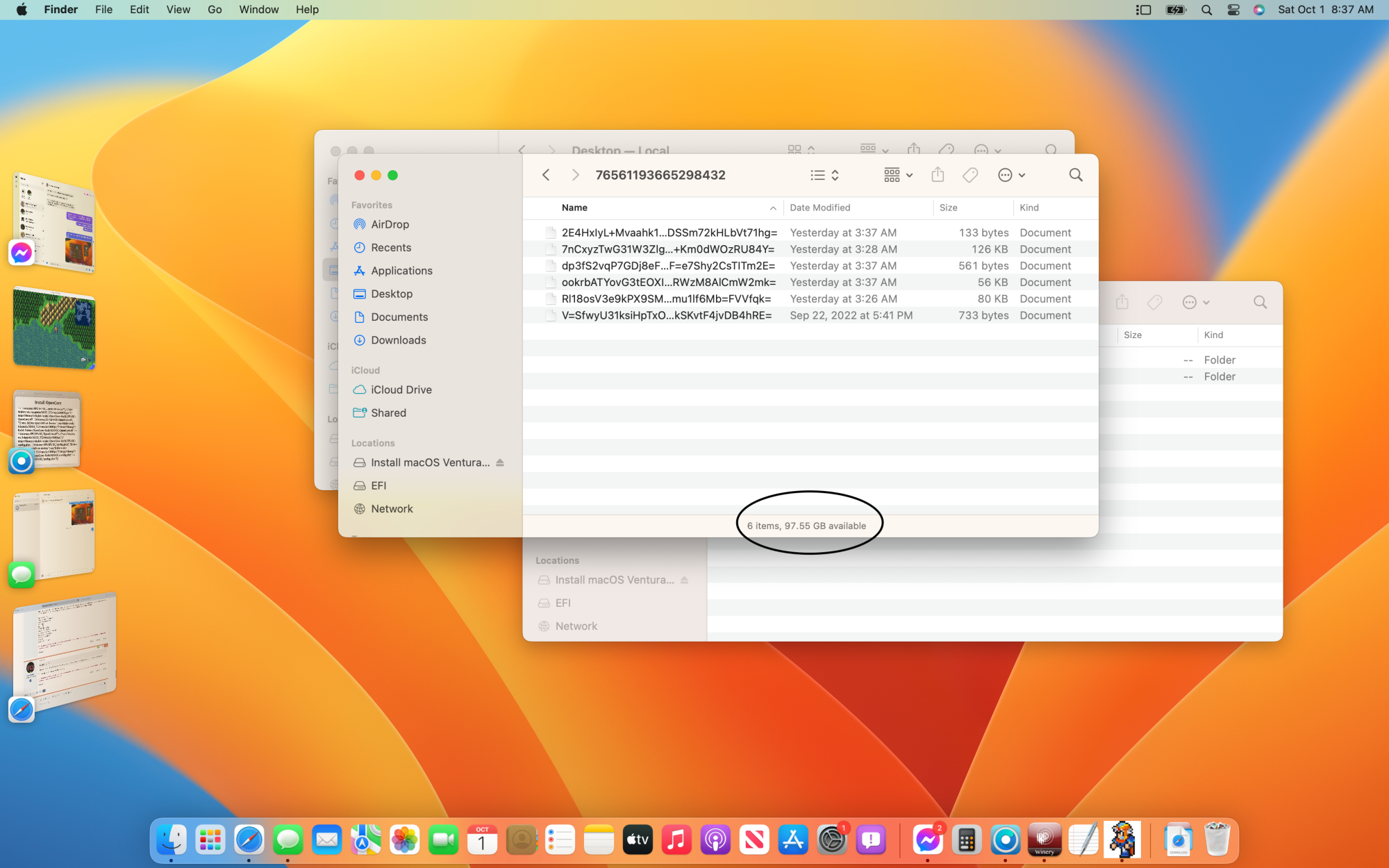

Question: when I try to install open core onto a 128gb apple ssd I get this anybody have a solution maybe a script or what?

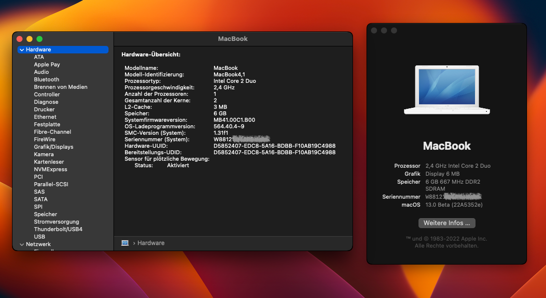

Extending the lower end...
Here is my MacBook 4,1 running Ventura. Of course limited by missing GPU acceleration (won't come, since it is an Intel x3100 type) and the USB 1,1 issue. So to get some access, I pre-installed Teleport and then transferred the SSD to the internal bay, just for the proof-of-concept.
Interesting side notes: The Ethernet hardware is seen as PCI express card (which is obviously isn't) but otherwise works fine. Same happens with FireWire on some machines. Could be useful for the devs, so I attach it here:

no I have 97GB left

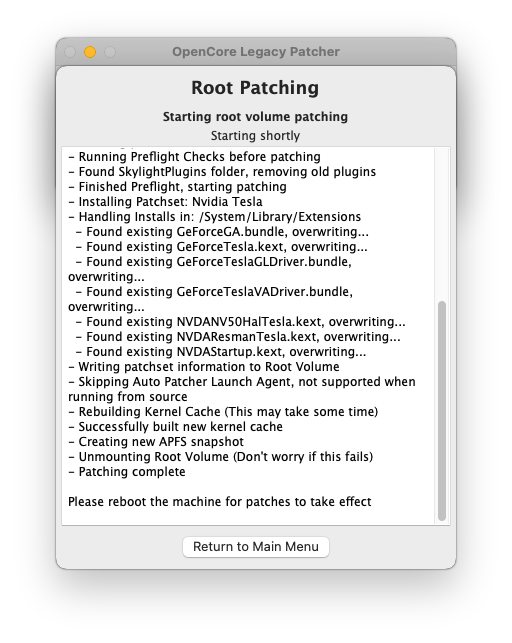

I'm continuing some post-install patch exercises on MBP5,2 (13.0b9, OCLP 050 from yesterday). I saw a difficulty to disable AMFI earlier (others as well?) and looked closer this time. AMFI should be disabled automatically but isn't.
I think it is likely a Python problem in resources/sys_patch_detect.py: the dictionary root_patch_dict has a conditional expression regarding "Validation: AMFI is enabled". This seems to be evaluated incorrectly. When pulling to expression out of the dictionary, works as expected.
(in the attached outputs never mind the KDK missing message - it is really not yet there).
python3.9 and 3.10 show the same problem. I could be on the wrong track of course.
Didn't investigate further (I think I was on the wrong track) - khronokernel made many improvements to AMFI and KDK handling meanwhile.
Now using the latest OCLP 050n (last commit: Verify path before iterating over, 22hrs ago).
Tried post-install patching of 13.0b9 on MBP5,2: AMFI is indeed disabled, KDK automatically downloaded/installed, with fallback to last available version which belong to b8. This patching test was successful, i.e NVIDIA Tesla stuff patched as foreseen. System still boots. No graphics accel of course as there is no patched OpenGL, but a little snappier, esp. mouse movement is perfect. Framebuffer probably at work (?). Visible effect is that it now shows the intended background picture. Nightshift works. Sleep/wakeup works.
