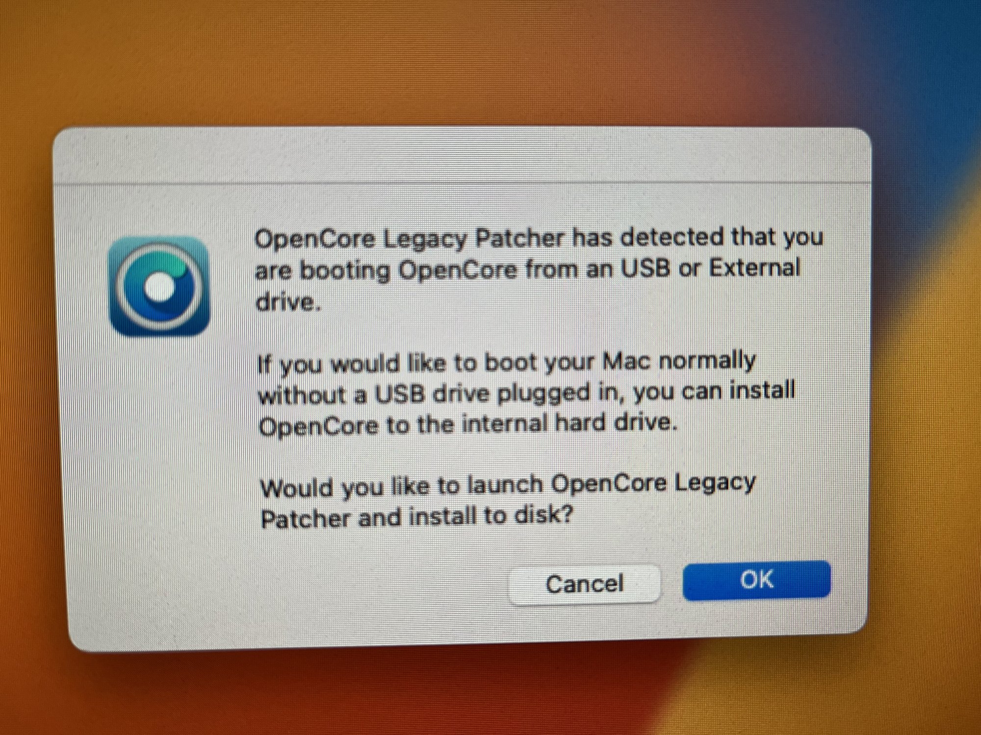

I have Cat and Ventura on seperate partitions on a 2012/13.2 27 Imac, last night I tied to install the latest .05 nightly, I am not certain what I did to screw it up, but then again I am accustomed to that. After trying many different approaches, I finally put in the Ventura USB installer made with OCLP instruction last week, and ended up in recovery mode, with install Ventura as the second option. The first option was Time Machine, I decided to give that one more try when I plugged in the SSD I got the message that it could only be used with migration(I think), then I went back to the first time machine window, that had listed both partitions--I had skipped those because I did think I would do anything, this time I clicked on the Ventura partion and it asked if I wanted to roll back to 10/24 or something to that effect. I clicked on that restarted and Voilà here I am back on the Ventura disk as if nothing had ever gone wrong.
I am going to install to disk again, I am sending this message about time machine because this rescue was not from a time machine backup, just from the time machine window.

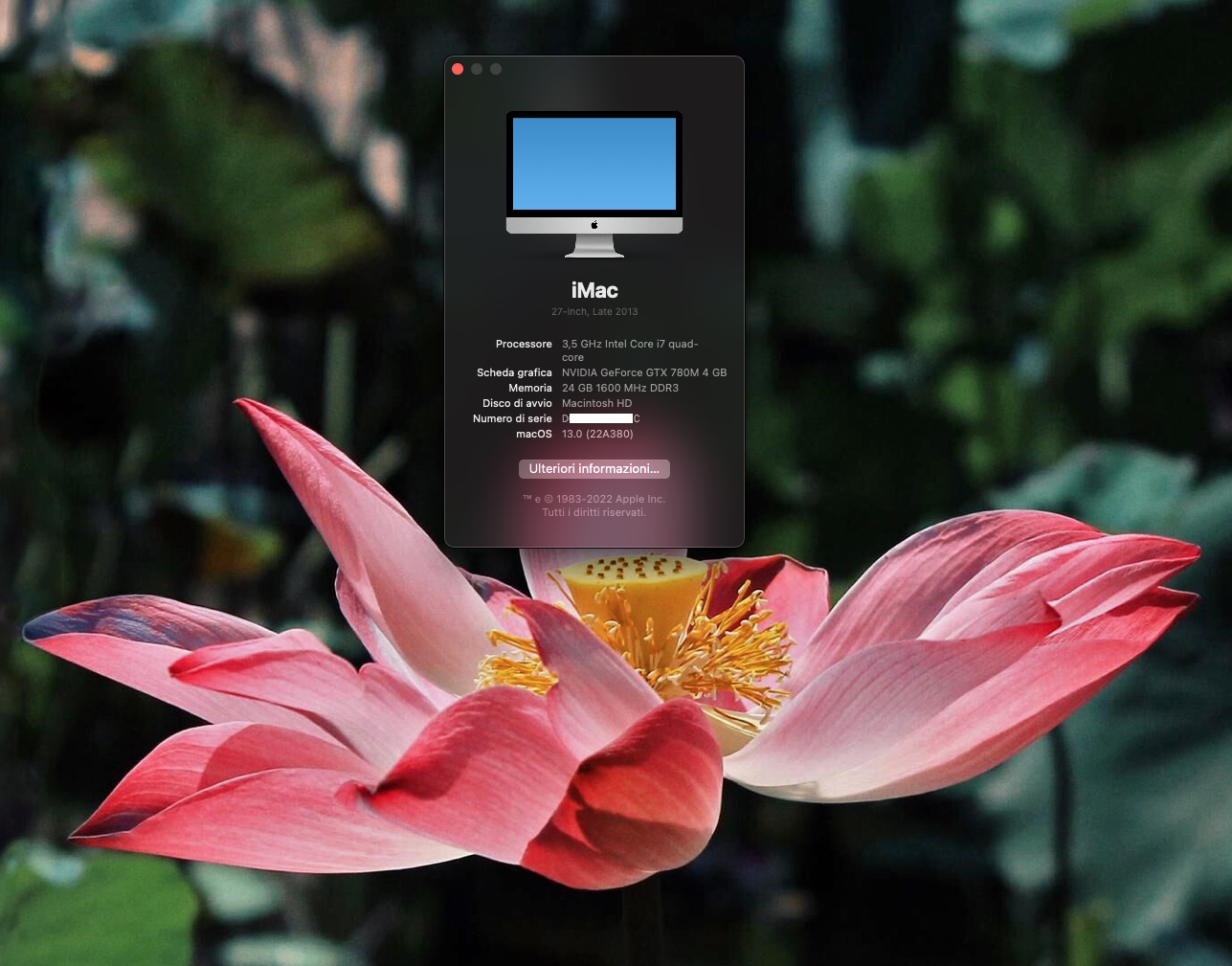

I was highly surprised at how quickly macOS Ventura installed itself!
I started the installation directly from System Preferences, after which the Mac prepared the update in a very short time, restarted, was "satisfied" with two quick restarts with the black background and then, when the Apple logo with the progress bar appeared... appeared written that there were only (hear hear !!!) 4 minutes. Oh yeeee!
Until now, however, since macOS introduced this update mode, the progress bar was always associated with the announcement that it would take at least 25 minutes...
I add that I use an iMac 14,2 27" late 2013 which would not be Apple supported (i7 CPU, 24GB RAM, nVidia GTX 780M 4GB VRAM), but which works great thanks to OCLP 0.5.0 official release.
All works (ALL!!!!!!!) well more than Catalina and Monterey and the result of Geekbench 5 tests are superlative!
Note: Safari sometimes takes time to open a page; but this depends on not well optimized sites because on other sites, even very complex ones, Safari flies. I was even able to pay my taxes quickly ;)
Thanks to the developers of OCLP and @khronokernel let's immediately make him Holy, in this life. :)

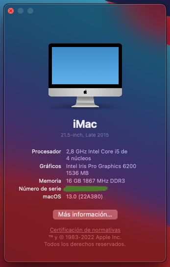

Oclp 0.5.0 ROCKS. Thank you developers.
iMac16,2 (iMac 21,5 late 2015) + OCLP 0.5.0 final release.
Successfully installed Ventura and root patch.
So far, all seem to be working fine (Weather app, Photos...).
Thank you OCLP developers!!!

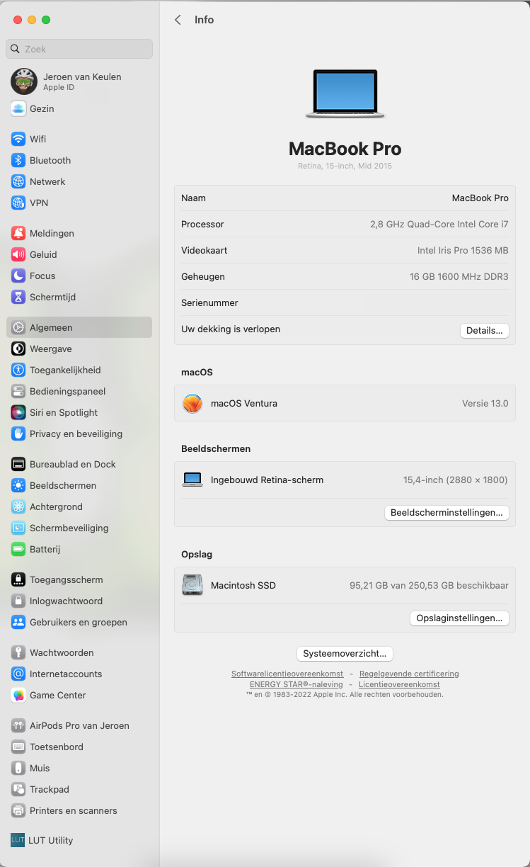

Just got it working on my macbook pro 2016. still cant believe that apple did not officially support it but alas. HUGE kudos to the opencore developers.

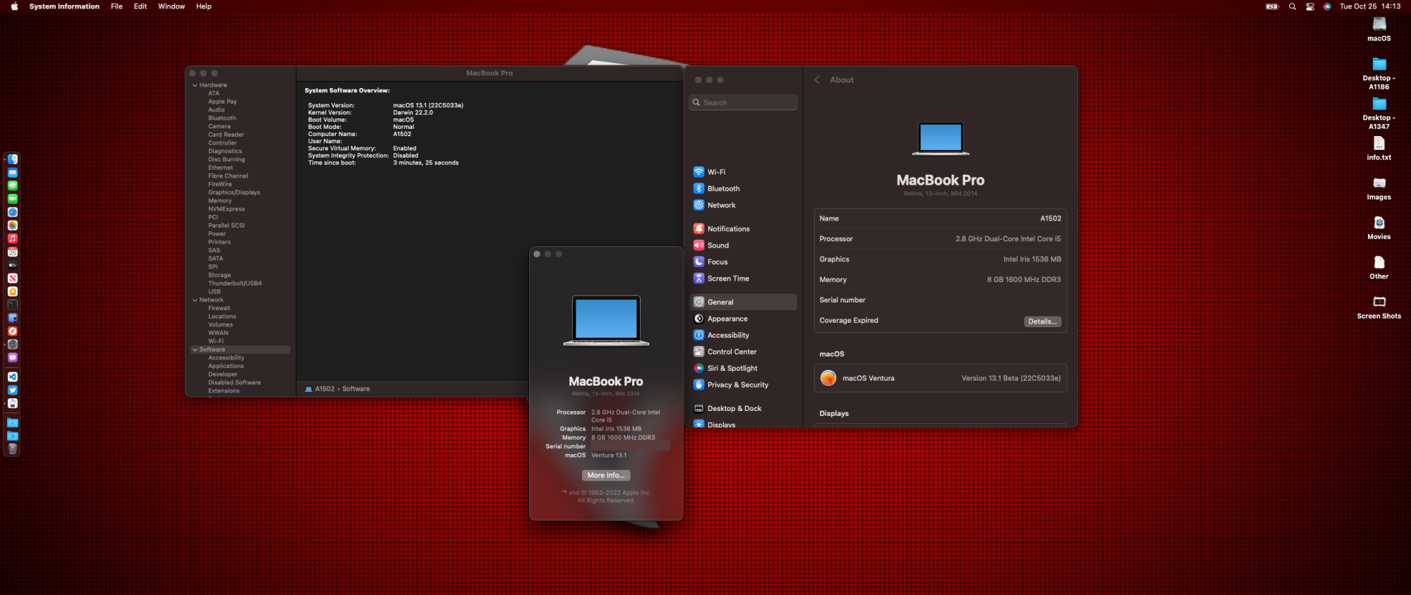

Updated from Monterey 12.6.1 without a hitch to Ventura 13.0 (22A380) using OCLP 0.5.0 (Infinite, infinite thanks and Credit to Dortania Crew!) via MacOS software update on MBP 9,1. All major apps working fine (Acrobat, PS, InDesign, Office 2021, Parallels Desktop 18) updated Xprotect with Silent Knight 1.21. Safari working fine.

Updated without a hitch to Ventura 13.0 (22A380) using OCLP 0.5.0 (Infinite, infinite thanks and Credit to Dortania Crew!) via MacOS software update on MBP 9,1. All major apps working fine (Acrobat, PS, InDesign, Office 2021, Parallels Desktop 18) updated Xprotect with Silent Knight 1.21. Safari working fine.
Could you please explain in detail how you did it? thank you

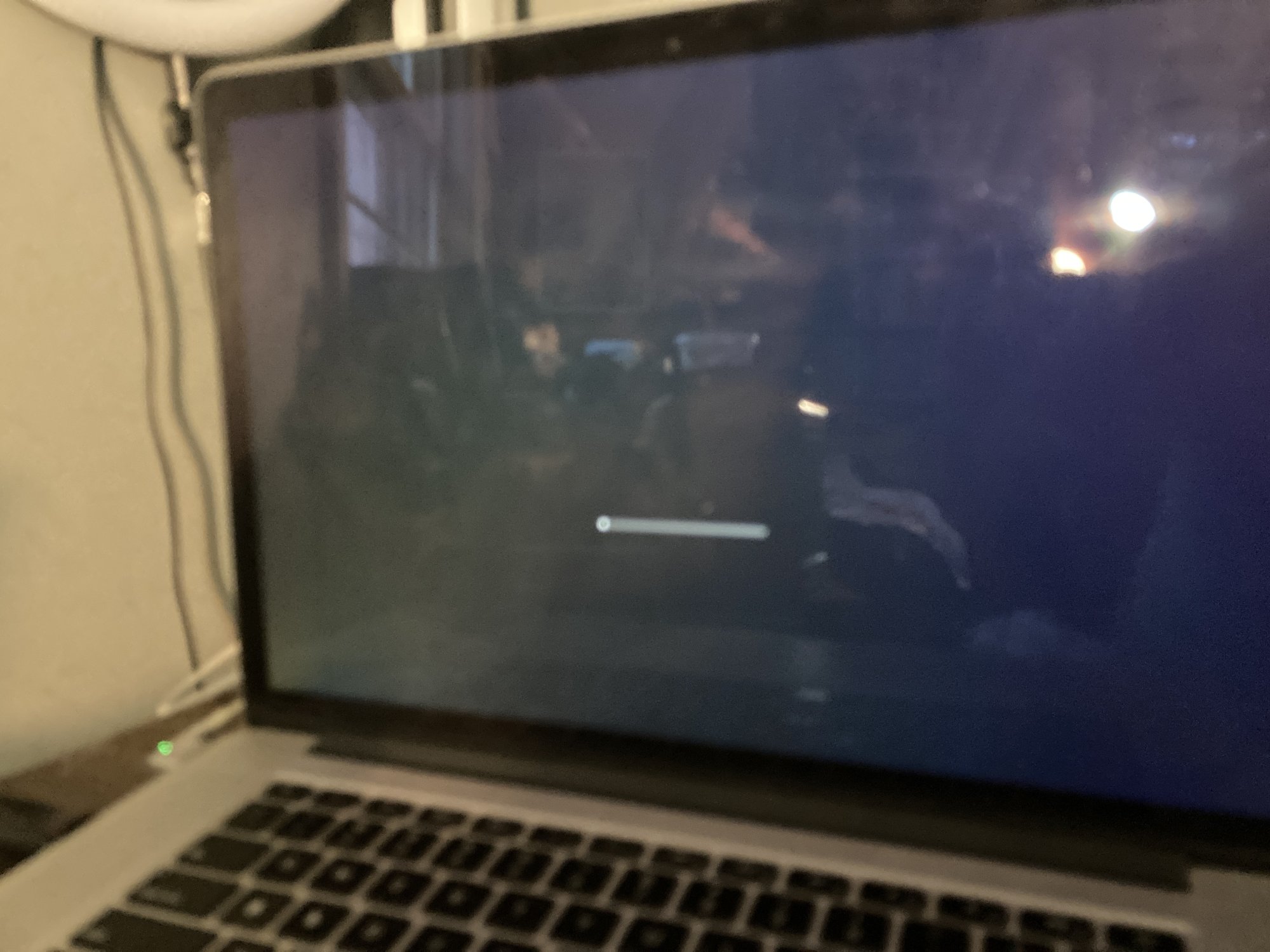

Trying to install Ventura on my 2015 Retina 15" MacBookPro11,4; I created the USB installer using OCLP 0.5.0, created the OpenCore EFI partition on the installer, and tried booting from it, but it just stays stuck in this position...
Or should I just let it sit a while?

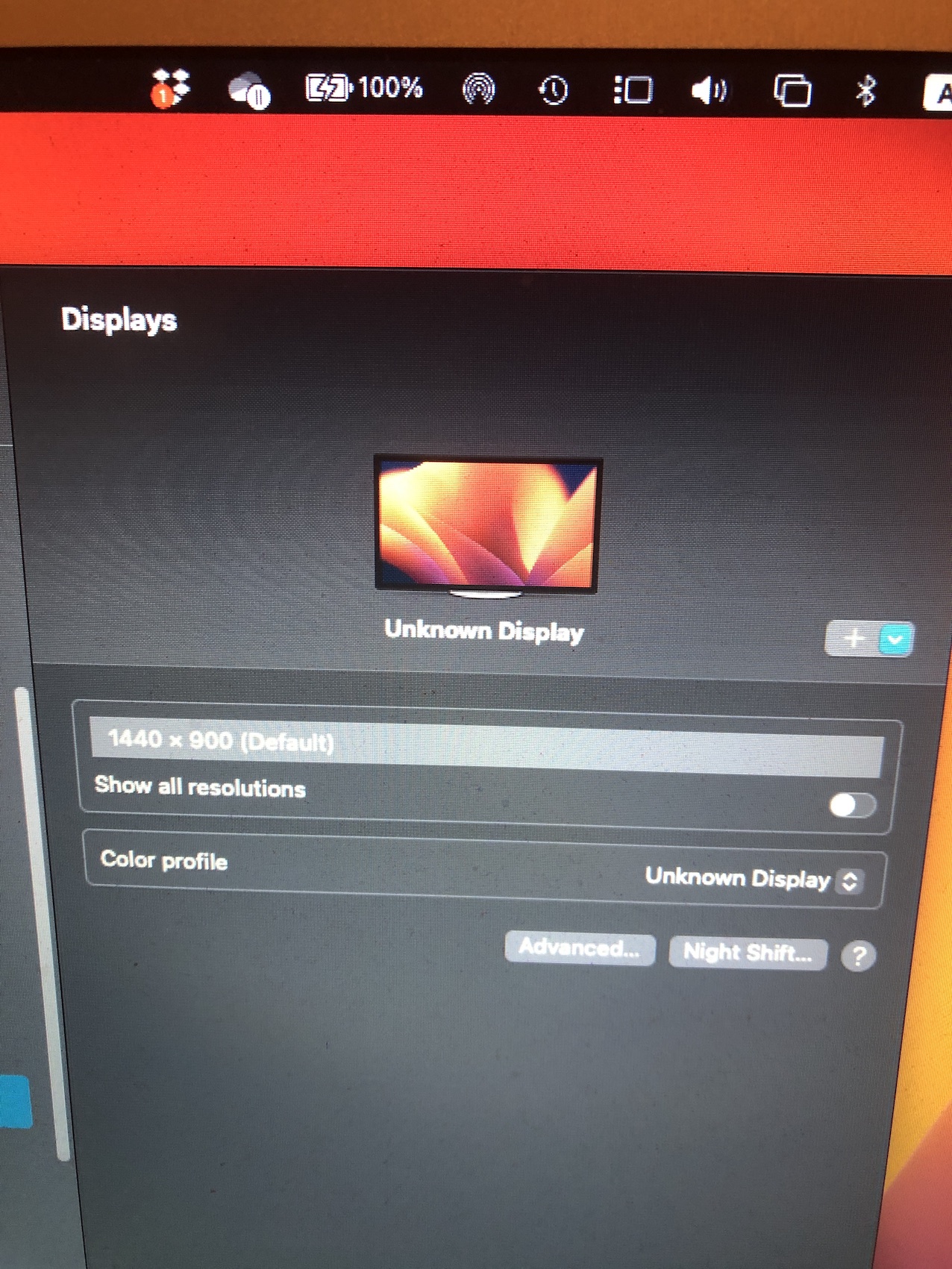

The two previously described issues (blank panes in Dropbox pulldowns and failure to really sleep--screen went gray but backlight still on and cursor displayed) are FIXED by running root patch using the GUI version of the latest 0.5.0 final.
Are you holding the option key to select EFI boot up disk? And next select Ventura disk.
Reactions: OKonnel
