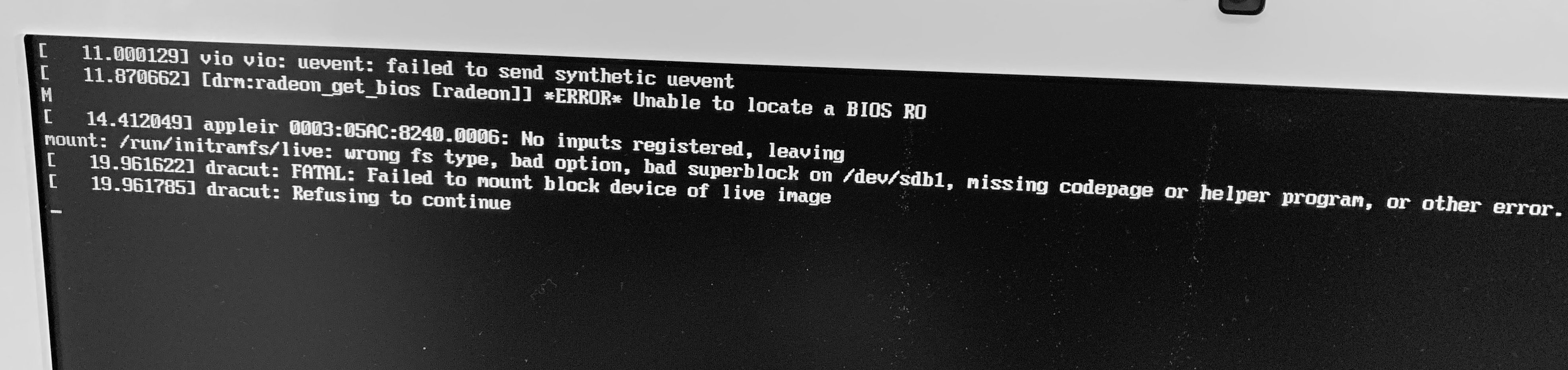

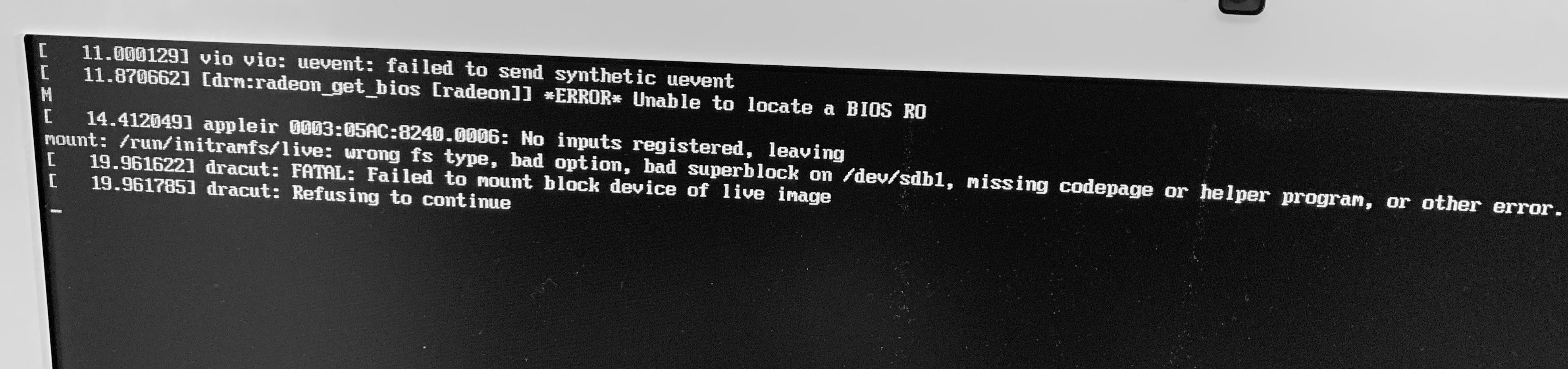

Ok, I did that. Then also did the apt get for hfsutils.
Followed the previous steps and rebooted. This time I didn't get the no OS icon ( Progress! :) ). However when it started to boot, I got the following:
I had this same trouble with my G5 Quad, yaboot can't read the ext4 partition.
I had to make a /boot partition and format it ext3.
