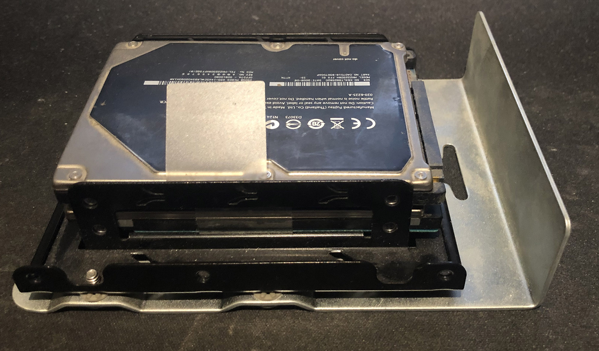

That's good news, but it seems like now you have replaced one overheating problem with another because now the video card fan is right up against the HDs in those bays.
The drives are not in the bays anymore. The drive sleds you see in bay 3 and bay 4 don't have any drives attached to them. They keep the SSDs you see in this picture from falling out.
macpro3-1-dual-2-5-mod-4-jpg.1731303
Why so an unstable constuction? With the right adapter and cables you can install it more stable.
Reactions: zedex
SSDs are not heavy. It's stable enough just sitting like that. I could make it stable by attaching the construction to the drive sled (drill some holes into the drive sleds and add fasteners).
There's not enough room for 3.5" HDDs in that orientation, but two 3.5" HDD's can fit in this space if rotated 90° and they won't require any space where the drive sleds currently are.
This positioning of the SSDs allows a double wide PCIe card to be installed in slot 4 as pictured in @zedex 's post at https://forums.macrumors.com/thread...ll-never-again-interfere-with-slot-2.2197527/ to satisfy @James Murray 's requirement of still being able to use the drive bays.
