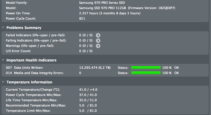

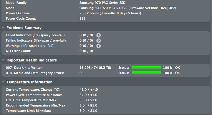

Just to you know how easy 970 Pro overheats, I just moved my 970 Pro, my main boot drive, to a non heatsink adapter to do some tests and 5 minutes after the boot, DriveDX warned me that the sensor 2 of my 970 Pro, was at 74ºC.
Reactions: AlexMaximus
Wow. Sounds like it would be worth be worth paying extra for a better adaptor! Would you recommend a better option than the 970 Pro with less overheating issues? Or should it be ok to use with the right adaptor with a good heatsink?
Every high performance M2 blade overheats and starts to throttle without a heatsink. I moved my 970 Pro to one of my Angelbird Wings PX1, now it's at 41ºC:
People that says his/her blade never overheats or throttle, say this because never ever monitored the temps or live in a freezer.
May I ask what software is that? Thanks.
