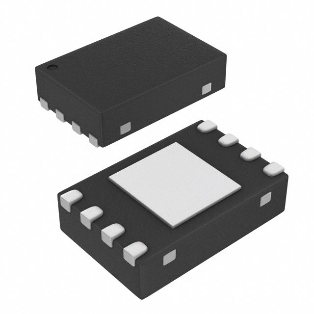

Ok so it seems that all your mosfets are working. Yes I just realized that I was looking at the wrong schematic. For the K6 macbook (Mid-2010) on page 57 yes the G3HOT circuit. I am not sure on the location since Im at work, but look for the following part, see attachments. You shoulld be seeing 16-18VDC on pins 6 and 8. And seeing ~3.425VDC on pin 2 and should see around ~1.25VDC on pin 1 which is created by the resistor divider of R6995 and R6996.

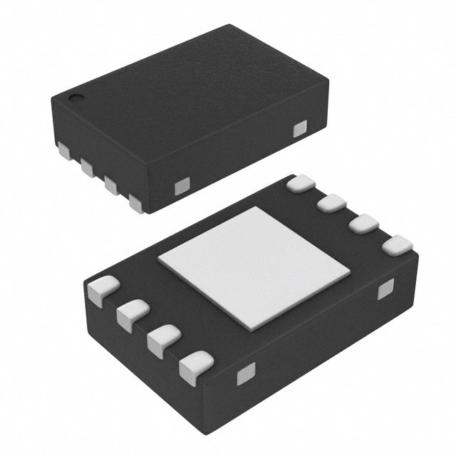

  • LT3470A.pdf
    LT3470A.pdf

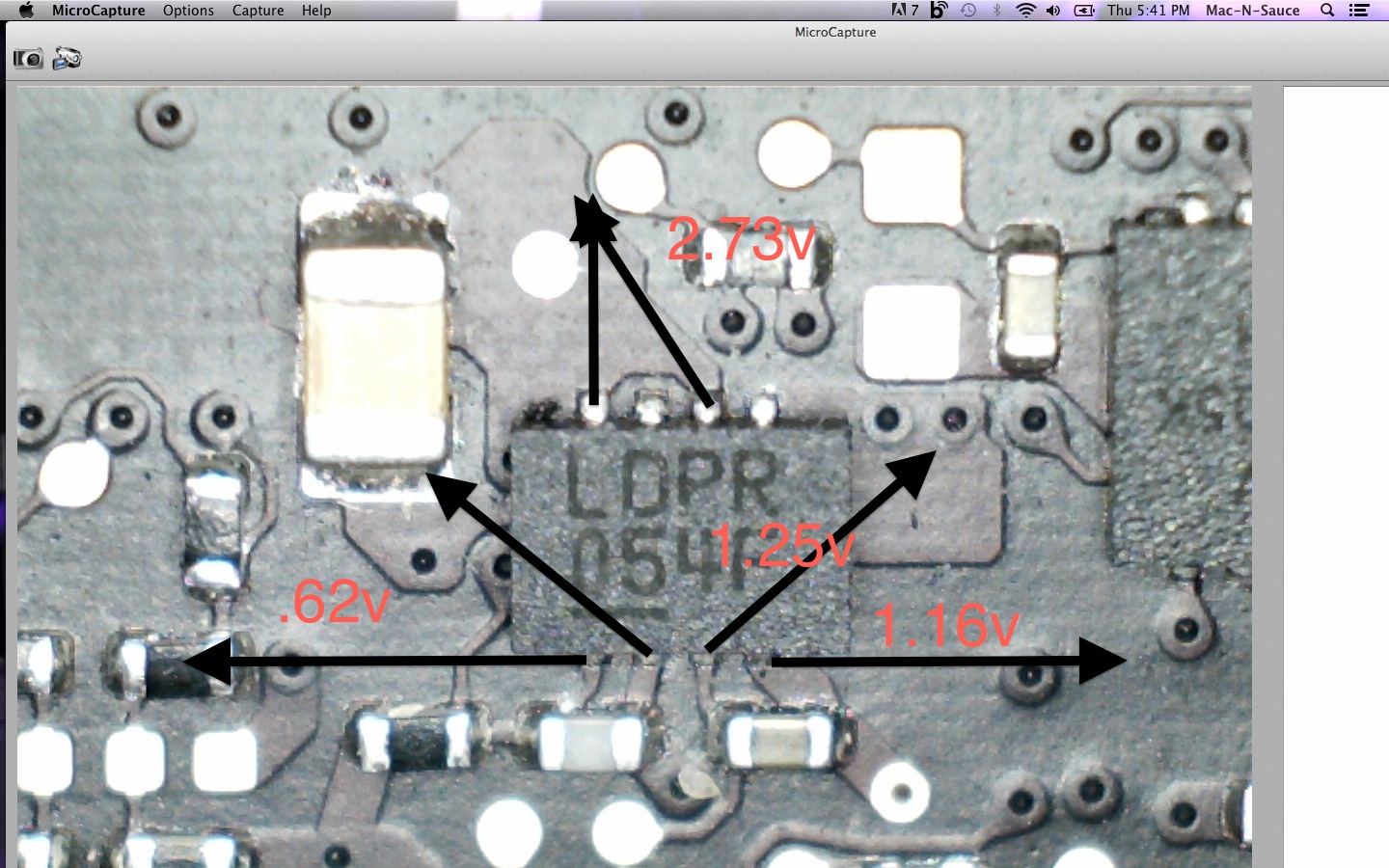

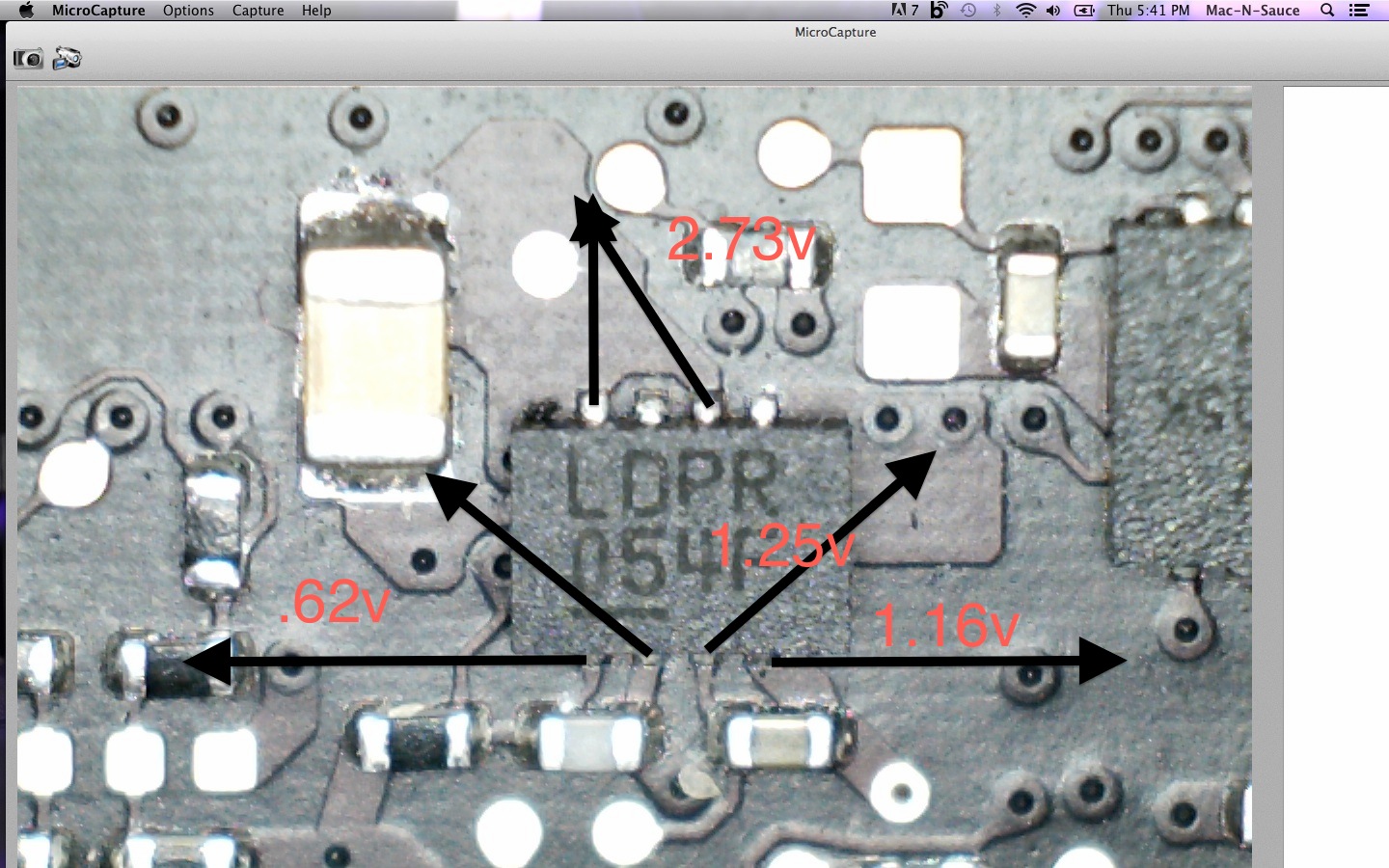

OK, I found the little sucker. 1.25" west of the LVDS connector.
I have attached a photo showing the values of the points.
Thanks again.

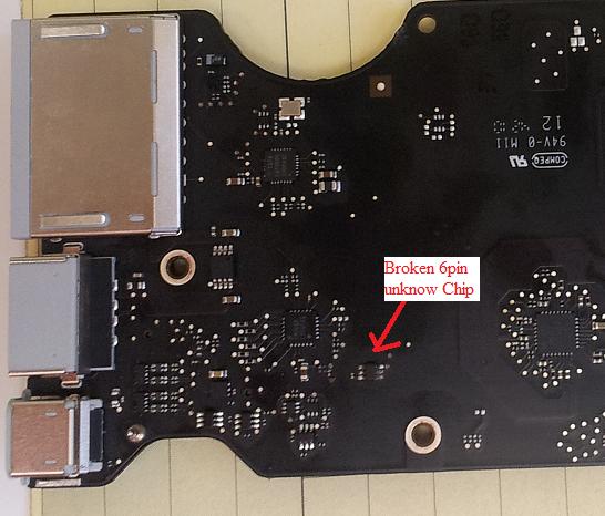

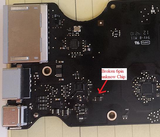

Macbook air A1369 2010 model no lcd backlight
LCD backlight issue, measure the fuse, it is fine and the only thing bad is a 6pin chip on the back which i couldn't identify. The label was on this chip is CEU(is it a customized chip?). does anyone know what this chip does? and what is the part number? I would appropriate if someone provide the board view and schematic for A1369...

Ok starting bottom left Where you have .62V I have the following.
1.254, 3.38, 6.97, 3.38
The two pins that have 2.73 I have 16.7VDC so to me that your first problem. Need to find R6905 and see if you have 16.7VDC on either side of it. If missing both then need to go further into the circuit to see where the open is occuring. You said that Q7080 and Q7085 had the correct voltages so my guess would be R6905.

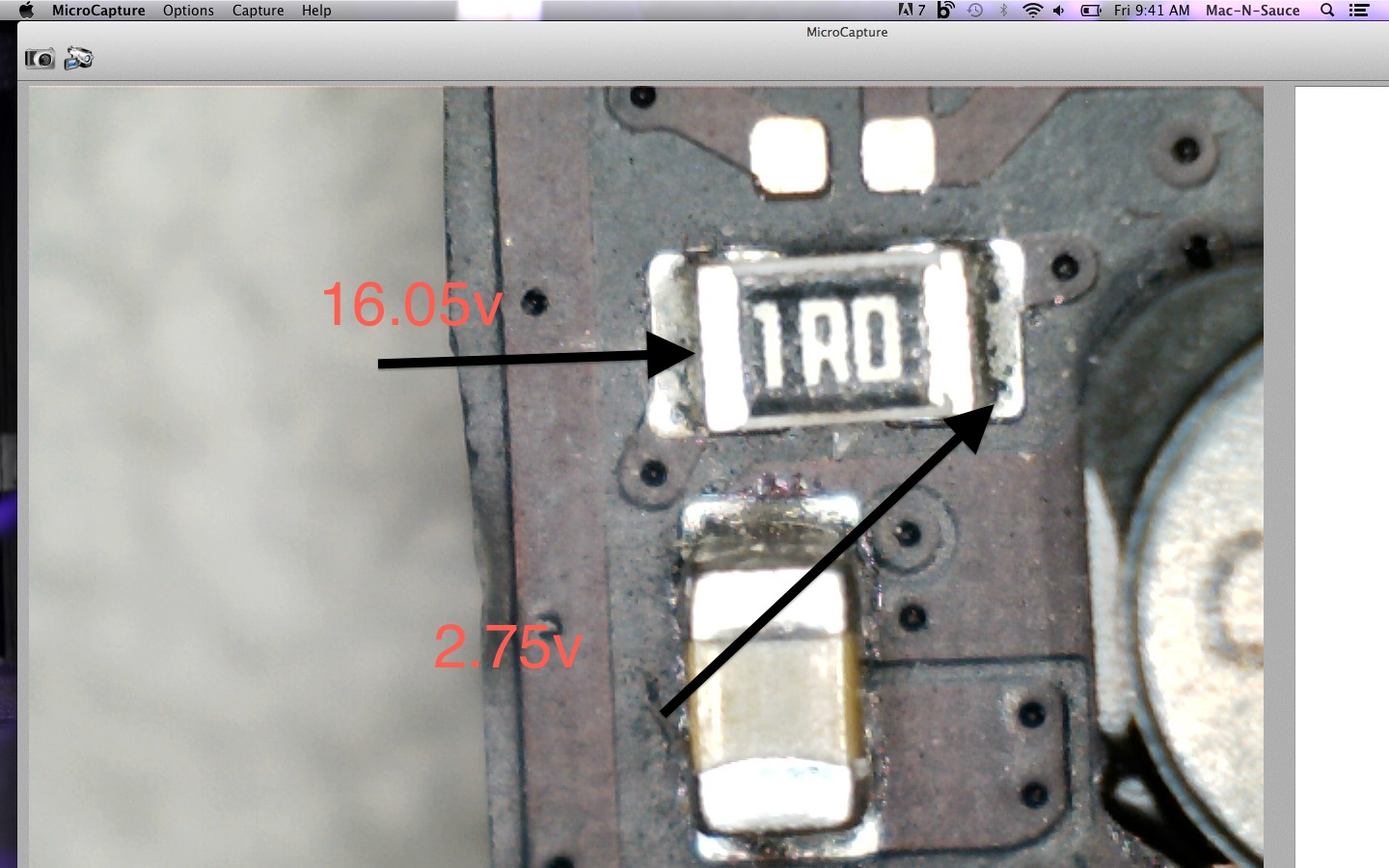

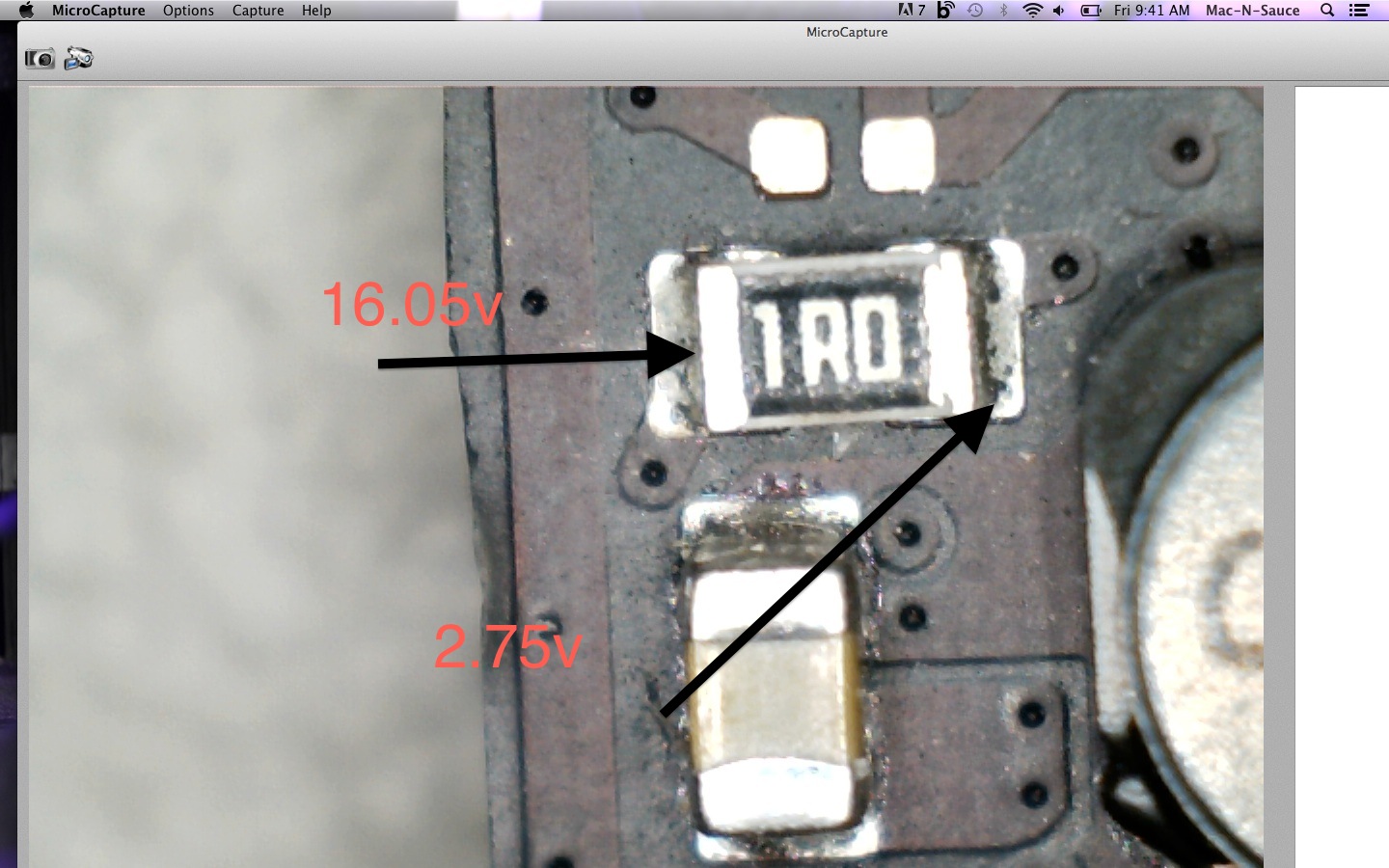

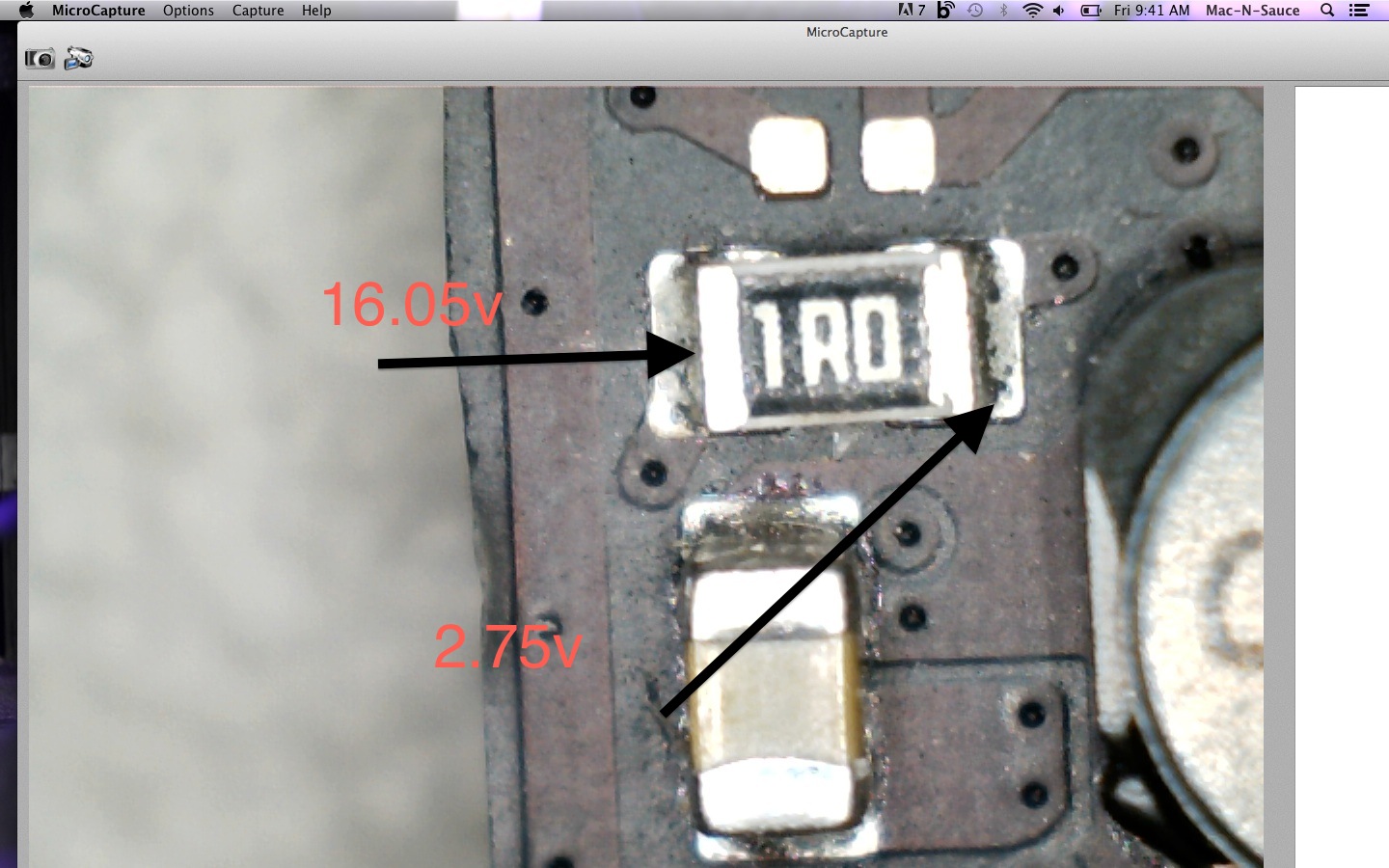

Attached photo of new values. I believe that this is the R6905 located on the top of the board. Could it be that this is the culprit?
Yea measure the resistance and see if it is 1 ohm is it isn't, and I suspect it ain't. Need to replace it.
Basically it's like a fuse.

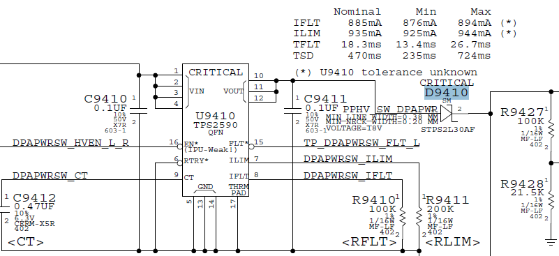

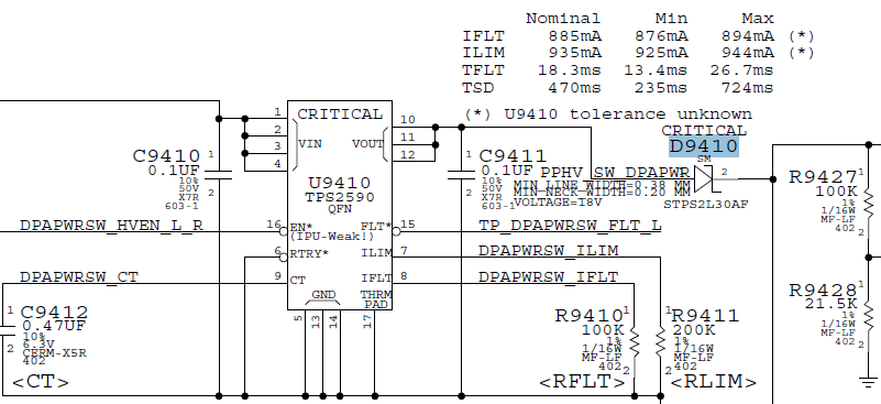

Got Power but won't pass the POST no beep

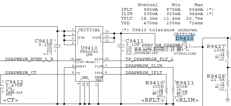

Hi Everybody, i'm back after working on other project. I got a new A1278 early 2011 LB 13' i5 that had no power. After few days I replaced few things and the LB is alive again! However, the problem is that I won't complete the full POST which means:
-no video
-no beeps when RAM removed
-after 30s the fan goes to full speed.
-Diode D9410 (Screenshot below) i'm getting 7V when compare to proper values I should be getting around 0V-0.8V. This is part of the High Voltage Power Switch Circuit so getting the wrong voltage here can effect that POST never completes or even start?
-tested with battery or megsafe which makes no difference
-megsafe turns oranage (I assume it charges battery properly)
-all tanl Caps by the battery connector including the fuse and green resistor getting 12V
Diadoh/Cmdrdata or anybody can give me some further pointers what can be the culprit here.

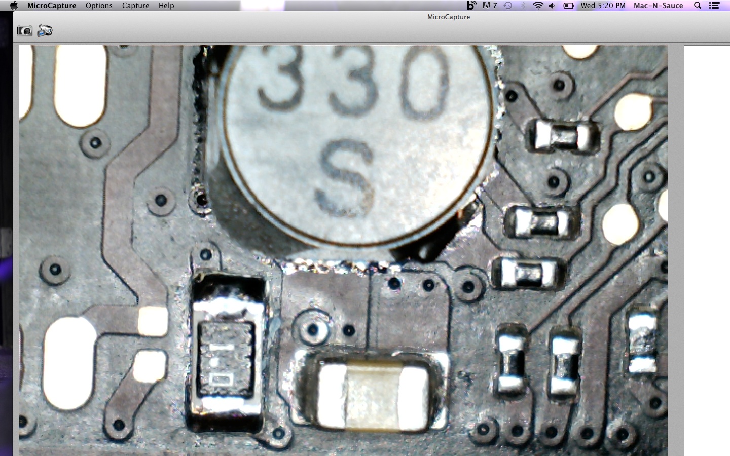

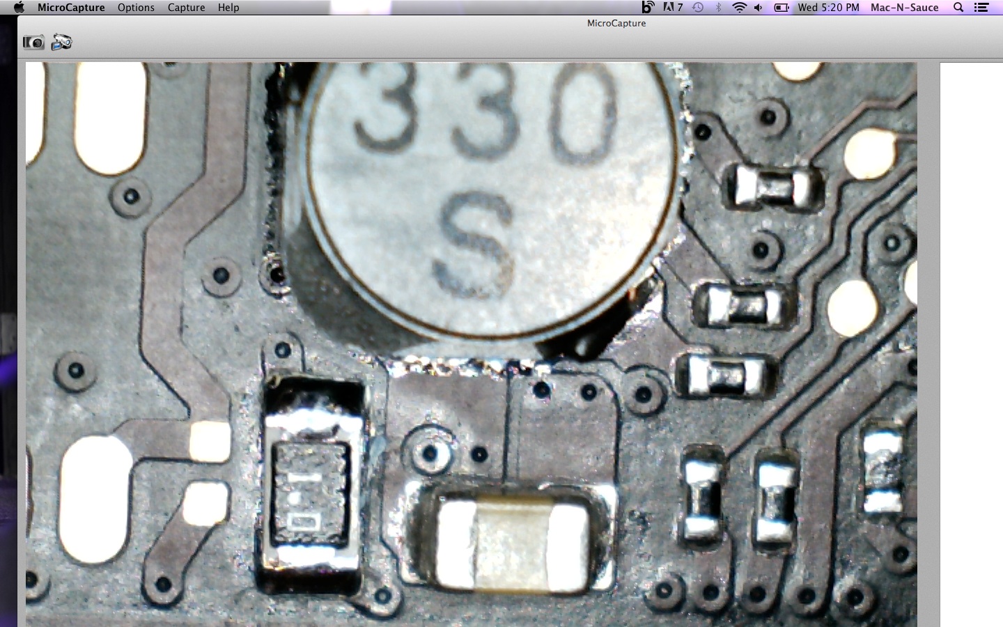

Ok, I have replaced the resistor with a new one. That was fun for my first solder job. Little tiny guy! 0805 package 1ohm. This is R6905 on the G3HOT.
I know have on the LT3470A(U6990):
Pin 1, 2 = .63v
Pin 3 = 1.98v
Pin 4 = .70 v
Pin 6(VIN) = 16.17v
G3HOT = .63 before i replaced the R6905 I Had 1.16v on G3HOT
I need help figuring this out from here. I have No magsafe lights at all.
Obviously no power on at all.
How do I determine if the LT3470 is bad, or where do I go from here?
Also, I have no power getting to the battery connector.
