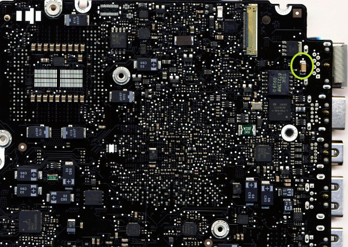

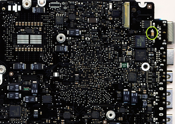

MB13 unibody silver 2008 a1278
Hi all,
welcome Back Dadioh, luckly mr data was producing the goods in your absence .
My question is ethernet port not working , internal system recognizes hardware but there is no power or data being transferred.

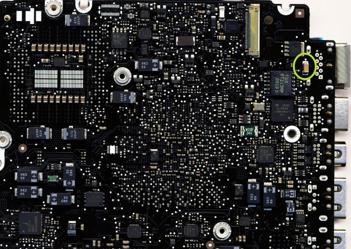

So is this fuse supposed to be open ... see pic
and if not what is its value... so i can replace
also the same board suffered compression damage, force trauma around that same area and its causing mag safe to flicker green vigorously and it still powers on, then a solid green light forms. after then turn off, the green light flickers again.
voltages are unstable through out so i need to single out the stabilizing packets, its as if the sense line is beings manipulated by inconsistent voltages or there is too much power being supplied and its overflowing everywhere. any ideas?
many thanks in advance

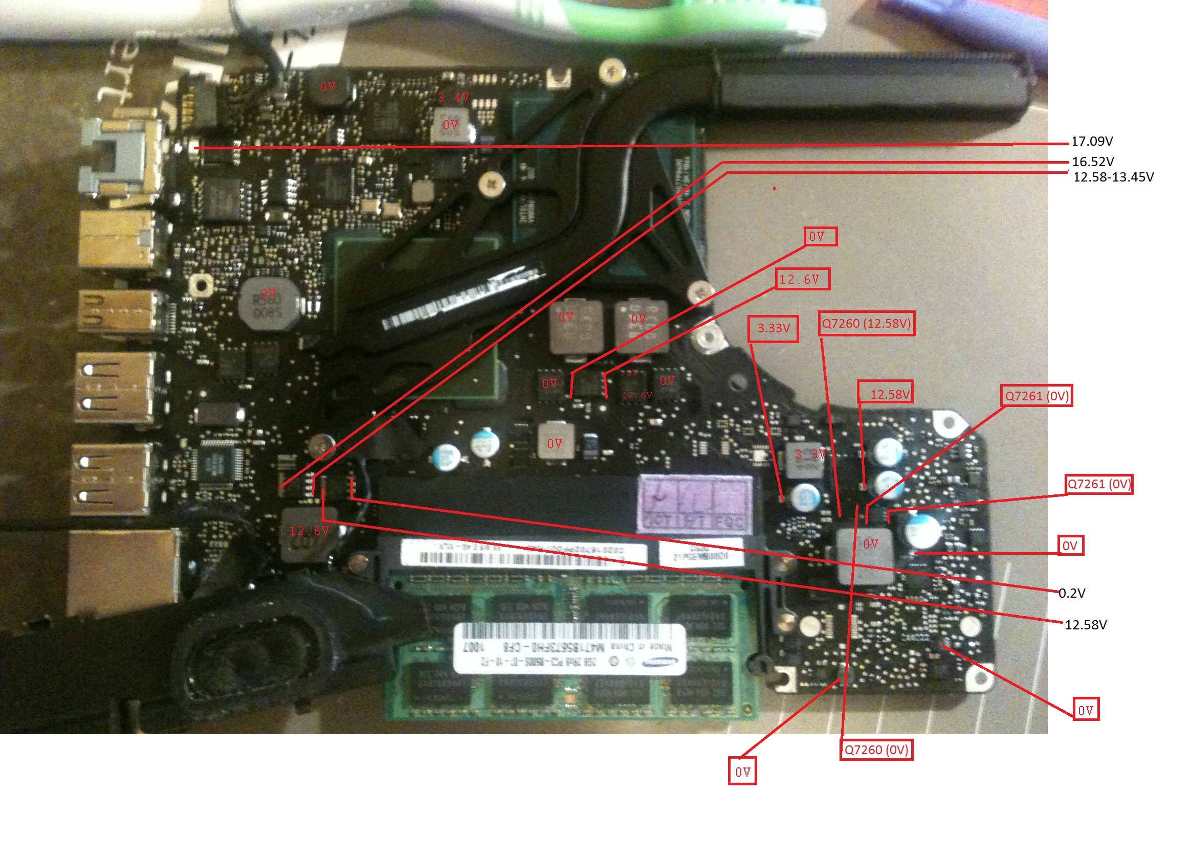

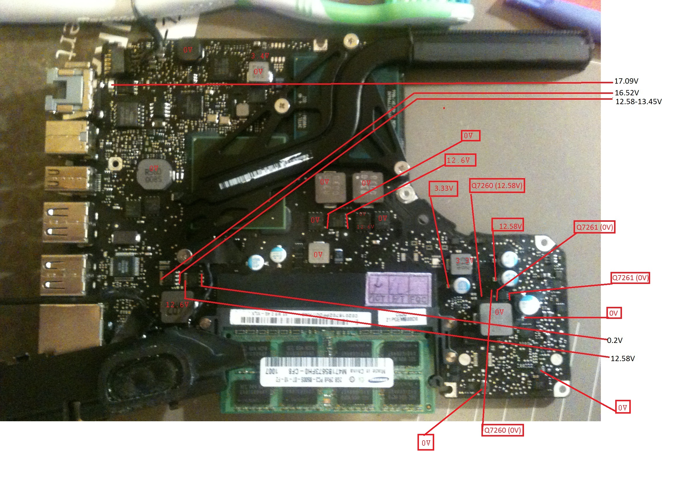

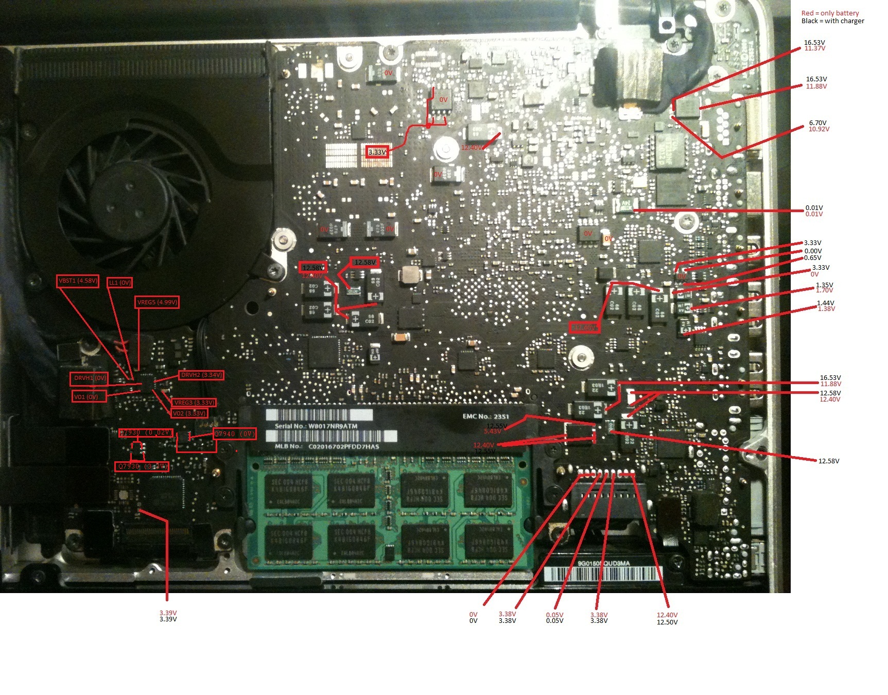

Macbook Pro 13 2010 A1278 EMC:2351
Need help on this to find out why it wont fire up. I have added some mesurements on the pictures.
Thanks guys 🙂
Thanks guys 🙂
I have the exact same issue. Have you tried to taking out the RAM and turning it on. If you hear a beep at least you know the cpu is in order. No beep bad cpu.

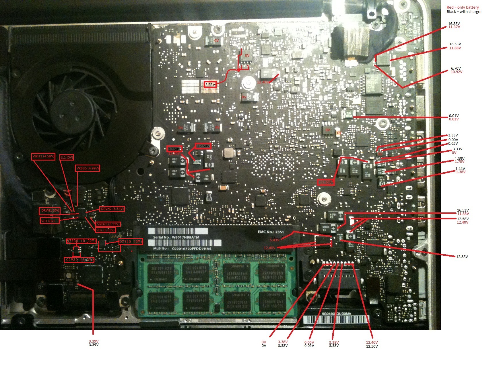

The voltages look OK. Check the 5V and 3.3V power as well. It is the small device near the wifi connection. I can't remember the exact points to measure but there are test points that can be used so you don't have to probe on the chip itself.
Hi Dadioh, I checked for Voltage in that area with no sign of power. Do you have a specific point I can try? What is the solution if there is no power in the area. Thanks so much....
great pics btw
i need you to run ASD 3s144
i think its going to fail on one of the sensors (a nor) maybe?check pic for area
wont know until you run the test.
You can test on the ends of some of the caps around the 5V/3.3V chip (don't have a board in front of me right now). If you don't see any voltages that would be a big part of your problem. Check the schematic for the 5V and 3.3V supply to verify further but it sounds like that guy is bad.

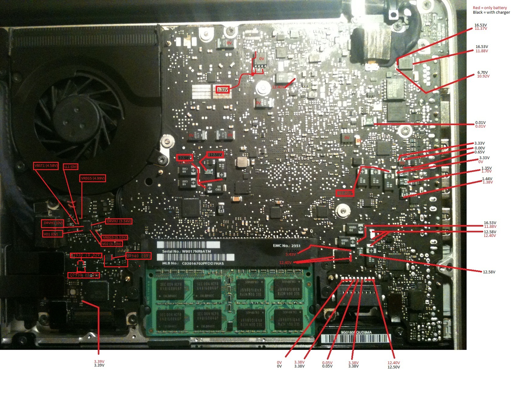

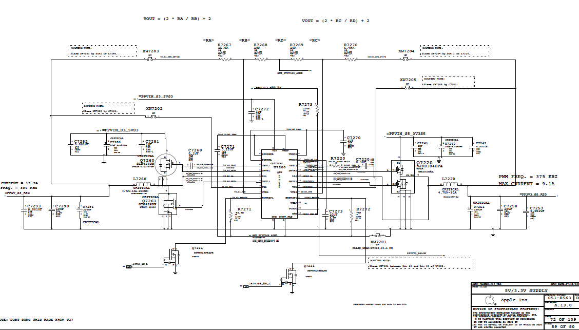

Anyone have some mesurements around an working 5V/3.3V regulator(U7200) to compare with the one I have taken?
Thanks so much for getting back to me! I found VREG5 with no Voltage (should be 5V??) Also, no voltage at Q7930. I don't have a schematic so i can't trouble the 3v/5v supply.
Here's a typical 5v and 3.3v schematic for mid 2010 MBP13U.

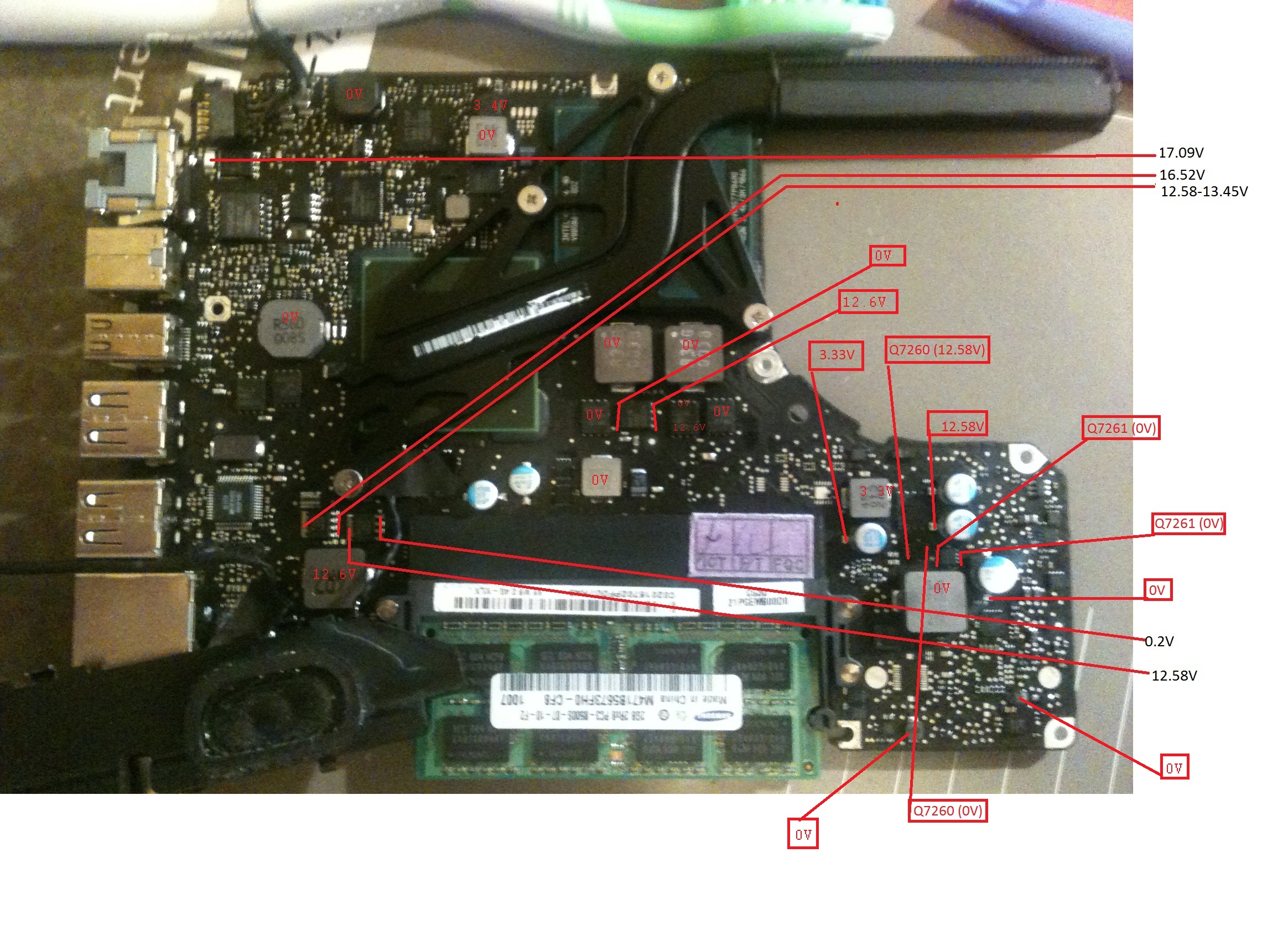

Now to what brings me here. Same deal as most people, power problem with the Macbook Pro, though it's a 15 Inch, 2010 model, and though it's been mentioned throughout this thread, I've had trouble getting the basics of what I need to test out. I've the done the general business, including isopropyl cleaning and compressed air etc. and now I've just reached the point where I've had enough of wishy washy online tech forums and just want to get to the bottom of this so I know where I can go from here.
I've attached a multimeter reading of few of the points I feel I should include,
Let me know if I should upload anymore/I have a feeling looking at some of the other uploads that I'll be testing many more points.
I have tried shorting the Power Pads, but unfortunately it doesn't come to life, though the power pads do show a voltage difference.
