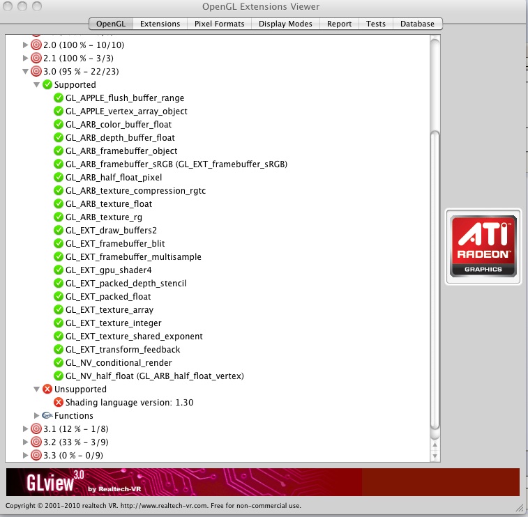

OK so i did this and it works perfectly in my mac pro 1,1 ZSFR 4890 card. Quarts extreme enabled. openGL only supports up to 2.1 it seems what is missing is "shading language version: 1.30
But right now im happy so thanks so much to this board for all of your help!😀
