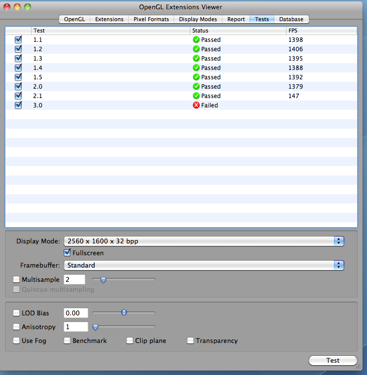

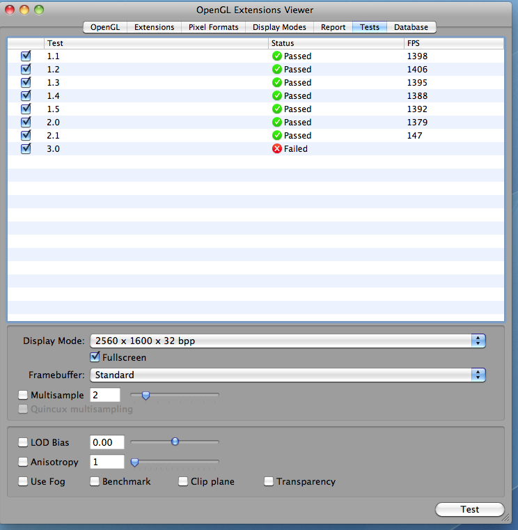

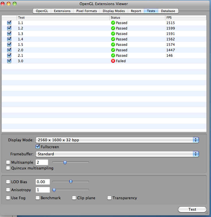

I bought a pre flashed card from ebay here in Australia. It replaced my ATI 1900XT in my then first gen mac pro. I noticed an improvement straight away in Aperture and iPhoto. I then sold my 1st gen mac pro and bought a mac pro 3.1, this came with a 8800GT card installed.
I pulled the 8800GT and installed the ATI 4890, to my surprise the previews in Aperture and iPhoto were slower than the 8800GT!
I have since ran OpenGL Extensions Viewer and this also indicates that the 8800GT is faster than the 4890. I have attached two benchmarks of each card. The test was carried out on a 2.8 Mac Pro running 10.6.3 and a 30" Cinema display @ 2560 x 1600.
Any help/advice as to why the 8800GT is showing greater results would be much appreciated.

put a load on it
move AA to 8, Multi to 4, check them both, and hit the "Benchmark" button.
Did your Ebay seller provide files to make it run in 10.6.4? Tricky thing for 4890.

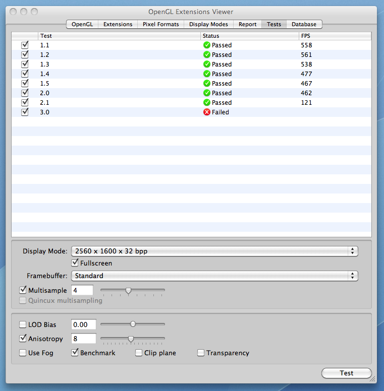

OK, i did that and the result is attached. Is this in line with everyone else?
