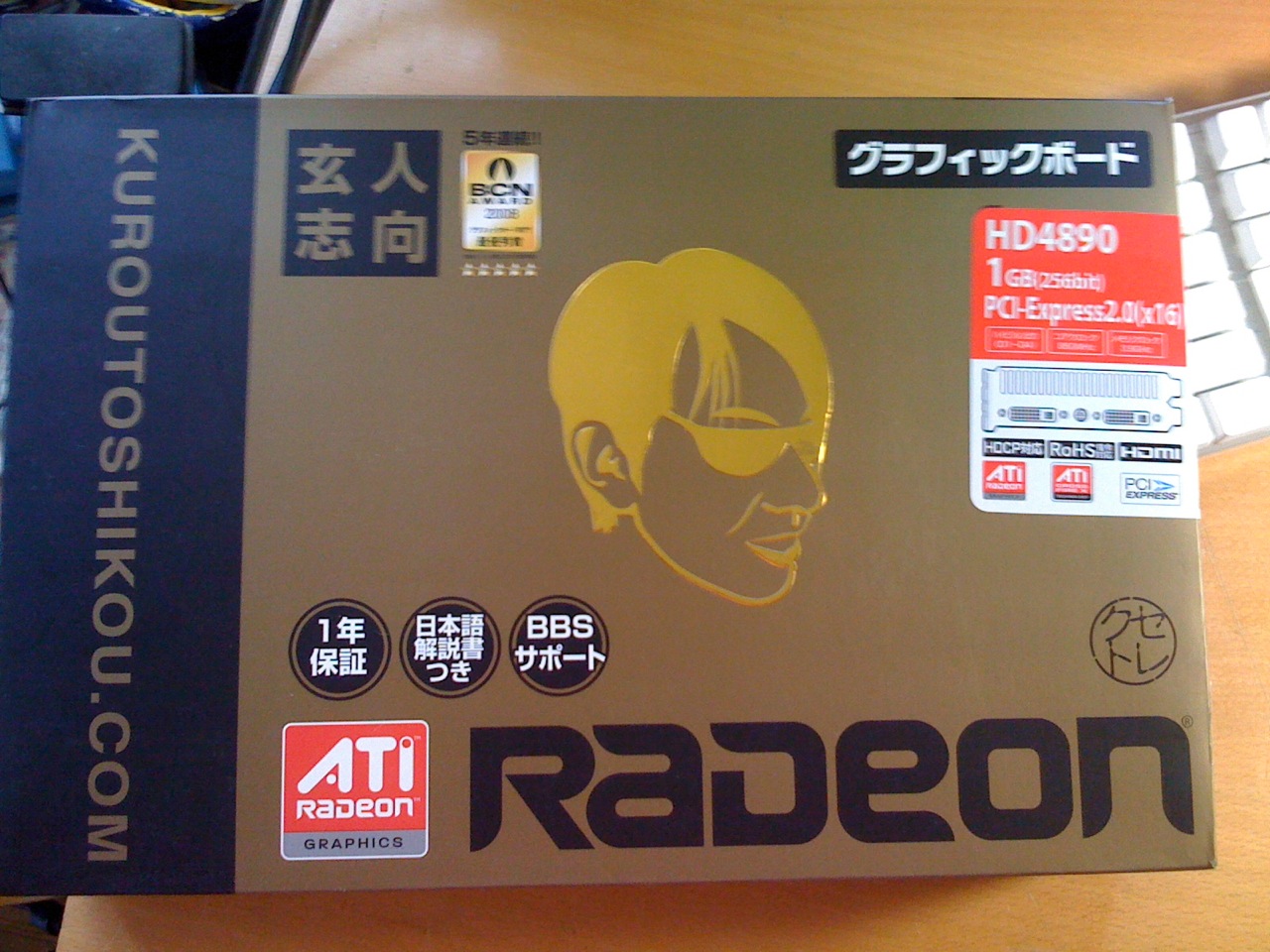

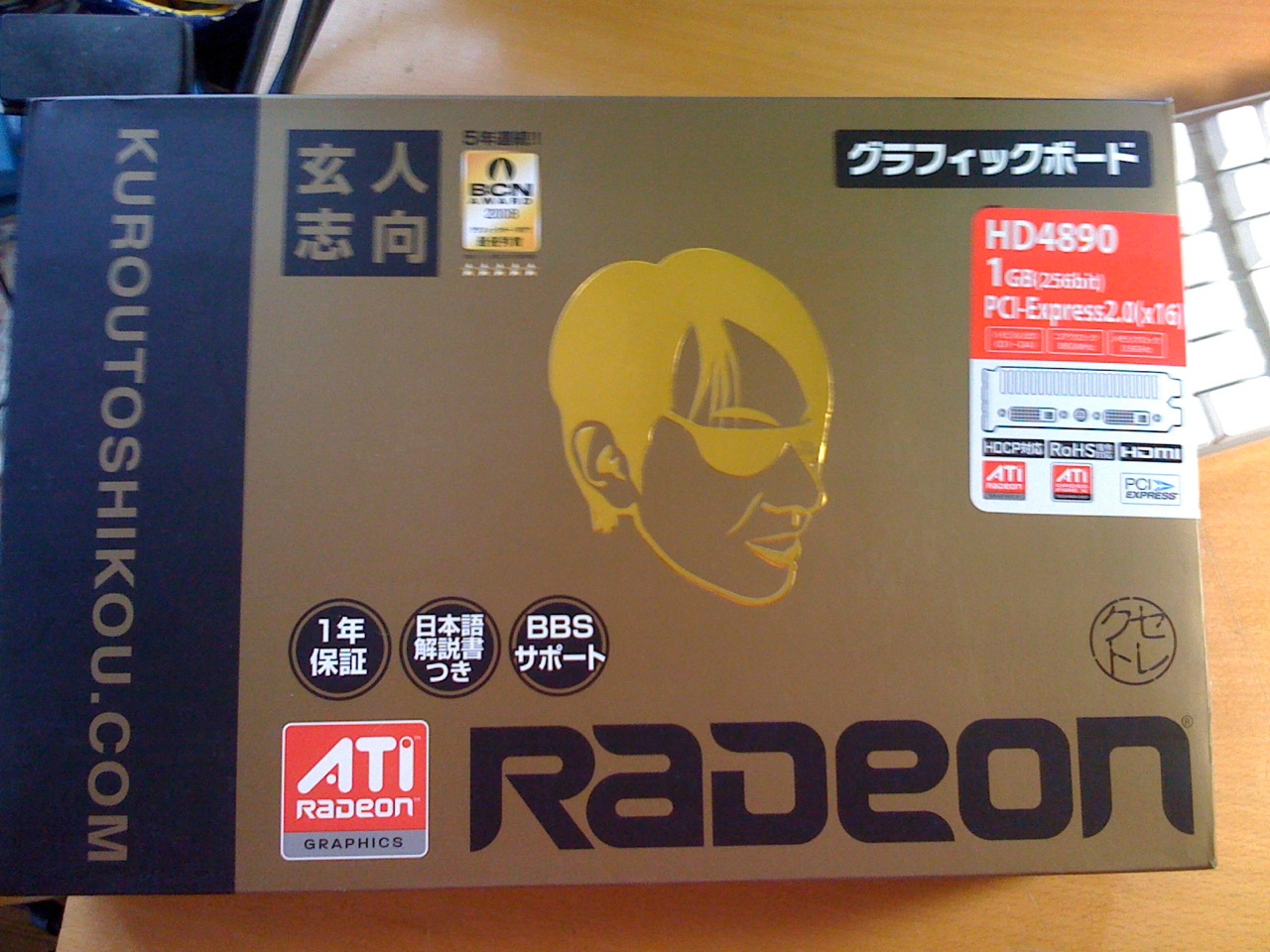

These are a much lower-cost option (about $120 to $130) than Sapphire 4890 but may only be available in Japan.
high school graduation week, I'm mostly on the run, using windows computers or iphone, and probably not sober enough to be making you anything anyway. try out making one for yourself, you have even more detailed explanations of the process now in the posts above. if you fail I will help you in a few days. Kurotoshiko also makes 5xxxx series cards and if they identical to Sapphire 5xxx series, they might be a money saver too when the time comes!
