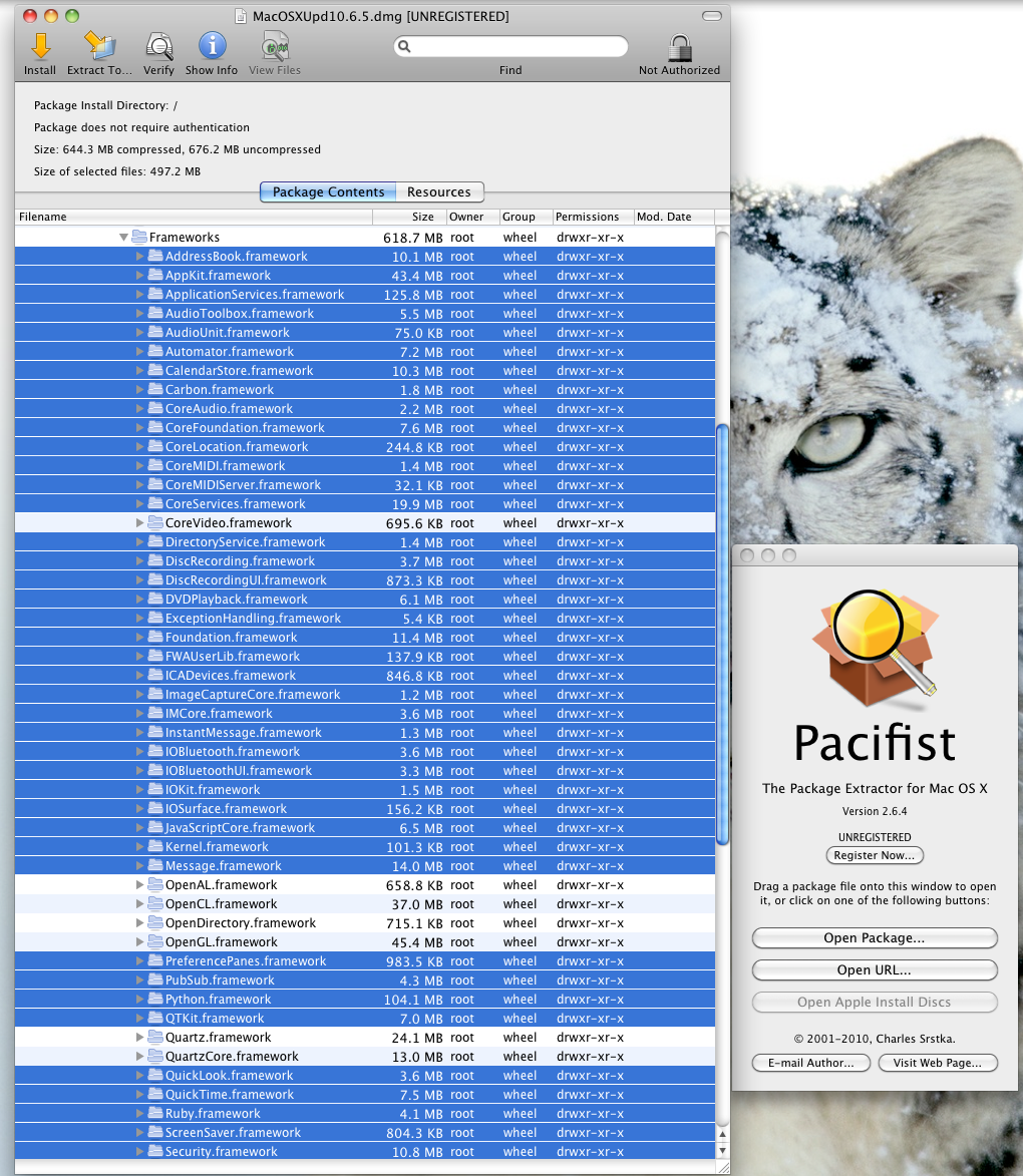

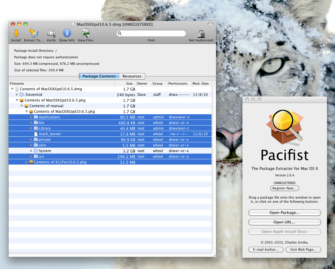

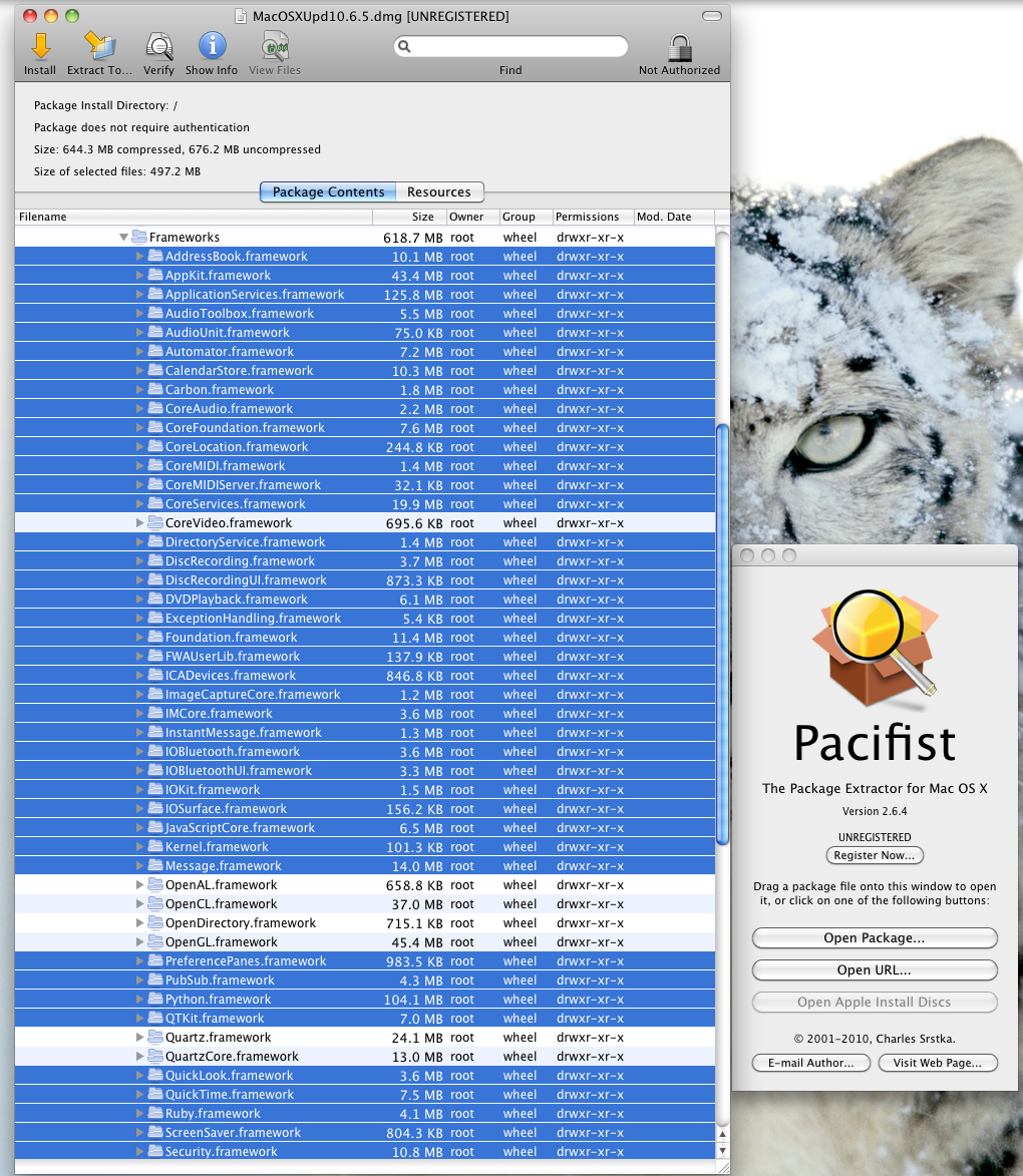

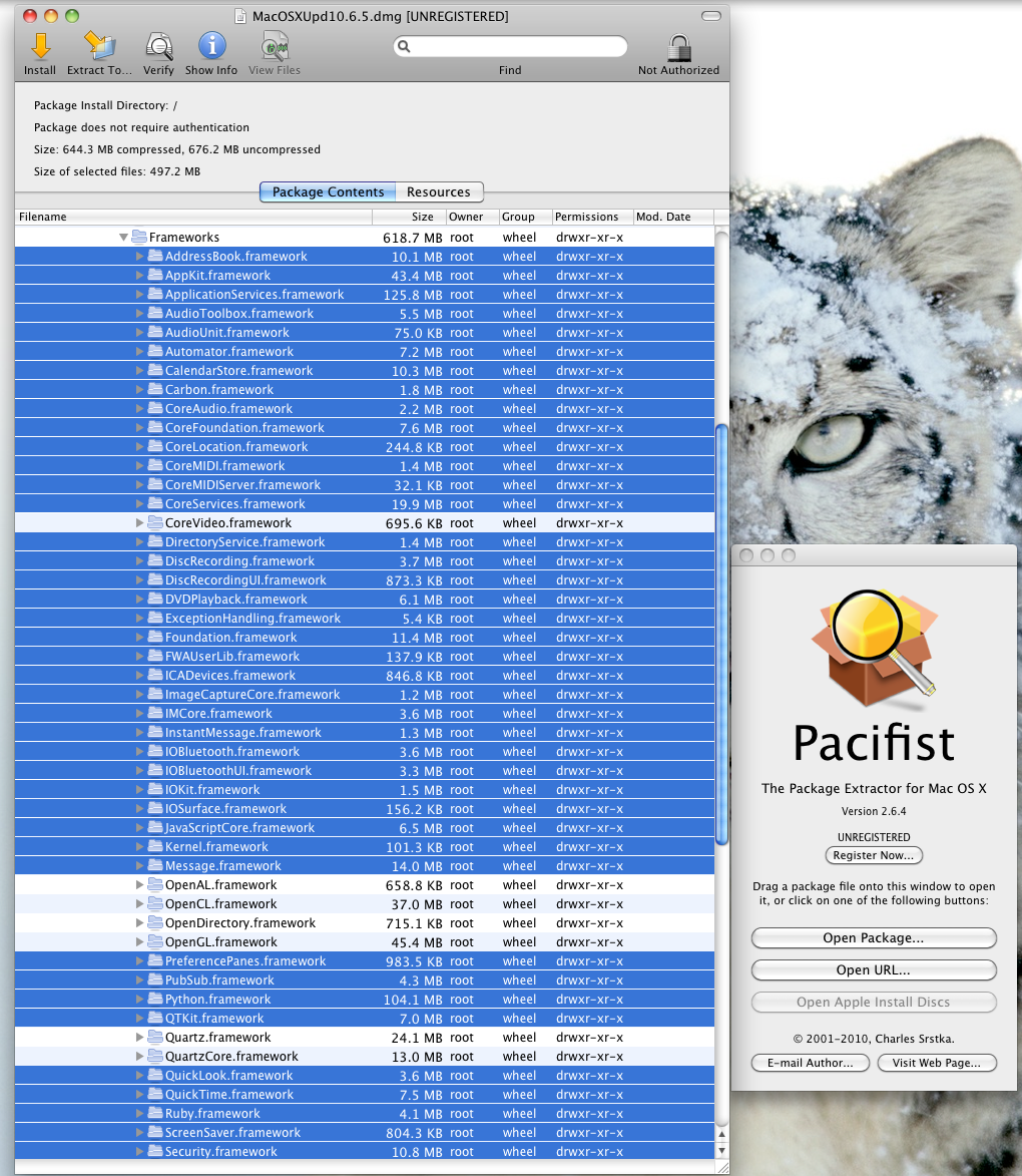

I am using Pacifist to install the 10.6.5 update piece by piece. So far I have installed the Applications, Library, mach_kernal, System.kext, and many of the items in the System Library folder. I have enough pieces in place so that About This Mac reads 10.6.5 and Software Update no longer asks to update to it. So far I have not needed to install the exotic patch, the one from my 10.6.4 + Graphics Update is still working.

Hi. Just install everything from the 10.6.5 update except for the files that correspond to the ones you used to patch your system the last time and the OpenGL and OpenCL framework files.

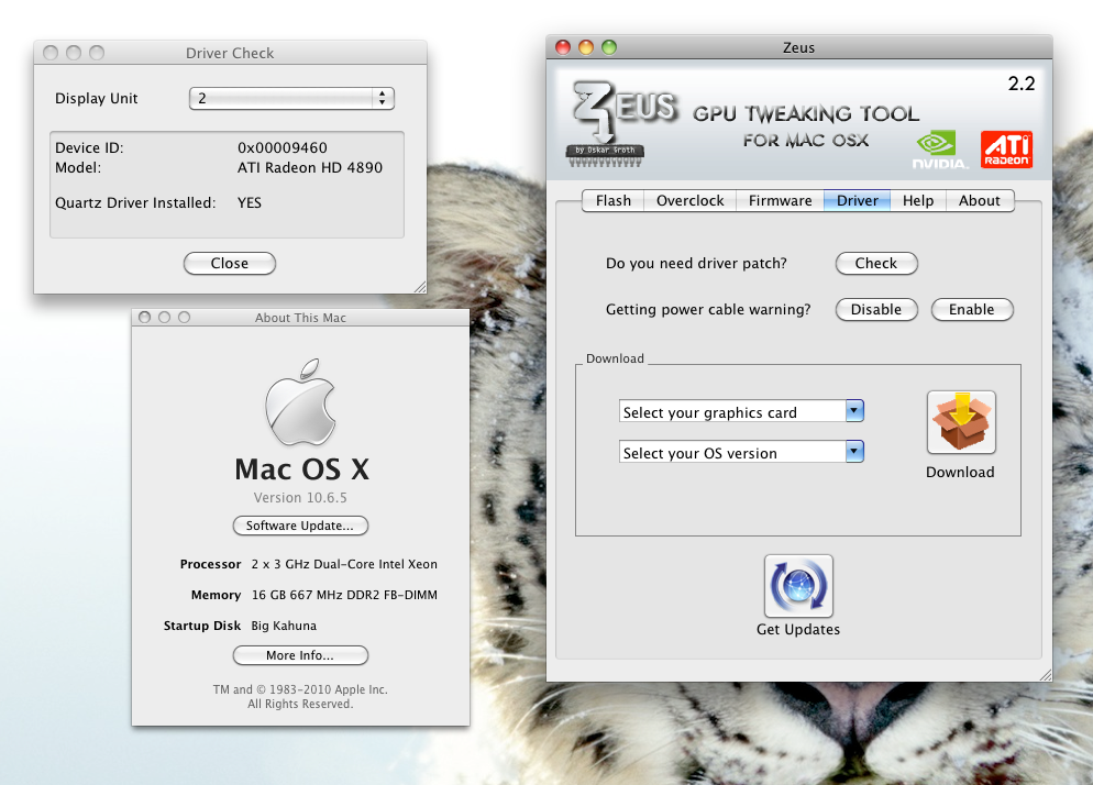

Success with 4890, 10.6.5 and QE/CI

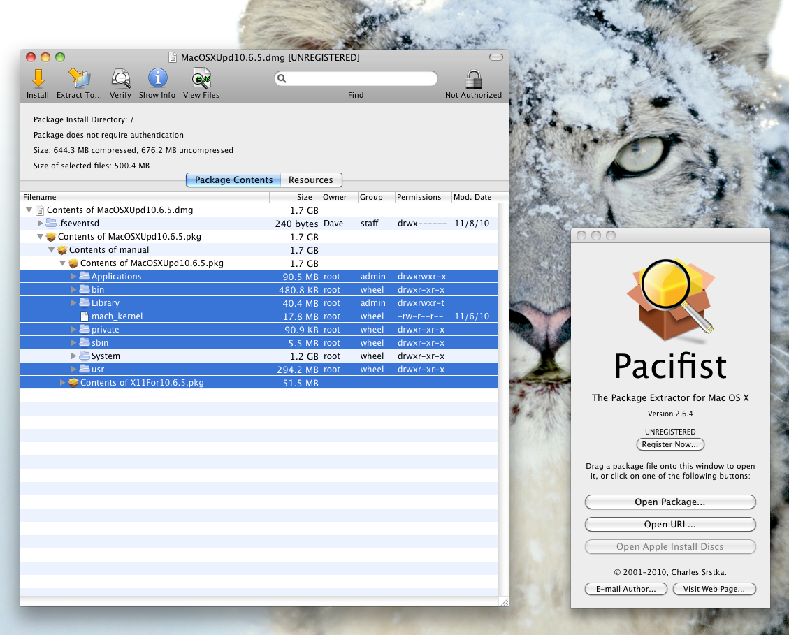

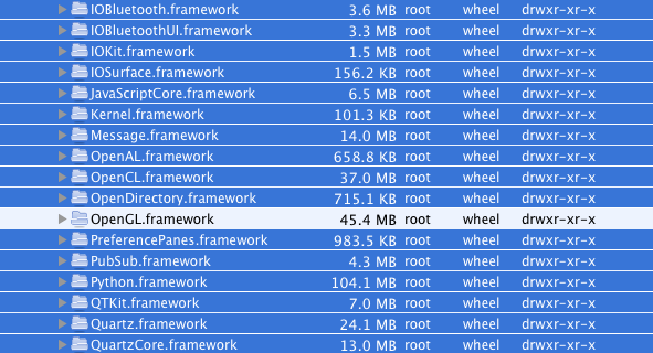

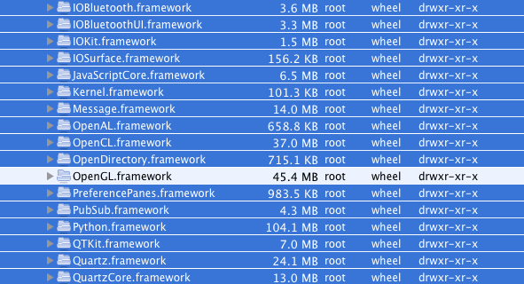

I used the latest version of Pacifist to install all parts of the 10.6.5 update except the System folder- see screenshot 1. From the System\Library\Extensions folder I put in the System.kext, the AppleIntelCPUPowerManagement.kext, and the AppleIntelCPUPowerManagementClient.kext. I then added most of the frameworks, avoiding anything that looked remotely graphics related- see screenshot 2. I also added a few other extensions (USB, Bluetooth, etc.) that looked like they had nothing to do with graphics. All the Applications, the Sleep function, and most importantly QE/CI have been tested and are working properly.

It is definitely those two frameworks. Unfortunately you have to use a package to install the frameworks not pacifist(after updating to 10.6.5). I do not believe pacifist optimizes/register the installed files, hence the graphics corruption.

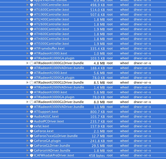

UPDATED Success with 4890, 10.5.6 + QE/CI

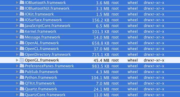

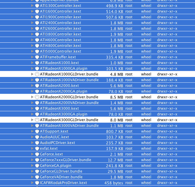

The problems in the 10.5.6 Update seem to be associated with OpenGL, the specific components are located in: System\Library\Frameworks\OpenGL.framework
System|Library\Extensions\ATIRadeonX1000GLDriver.bundle
System|Library\Extensions\ATIRadeonX2000GLDriver.bundle
System|Library\Extensions\ATIRadeonX3000GLDriver.bundle
I used the latest version of Pacifist to install 10.5.6 without these 4 parts and it is working perfectly, no issues with starting up, sleep, or any applications. Kind of strange however, as I was testing it bit by bit on my backup drive everything went smoothly but when I tried install all the working parts all in one step on my main drive it didn't work, I got the blue screen; I erased the main drive and cloned the backup drive to it, it works fine. So, I recommend updating in stages:
1. First and most importantly, back up your current working system and download the latest version of Pacifist (consider registering).
2. Use Pacifist to install everything BUT the System folder. From the System folder use Pacifist to install 3 extensions- AppleIntelCPUPowerManagement.kext, AppleIntelCPUPowerManagementClient.kext, and System.kext
Repair permissions and restart.
3. Use Pacifist to install the System Folder, everything BUT Frameworks and Extensions. Repair permissions and restart.
4. Use Pacifist to install System\Library\Frameworks, everything BUT NOT OpenGL.framework
5. Use Pacifist to install System\Library\Extensions everything BUT NOT ATIRadeonX1000GLDriver.bundle,ATIRadeonX2000GLDriver.bundle,ATIRadeonX3000GLDriver.bundle
