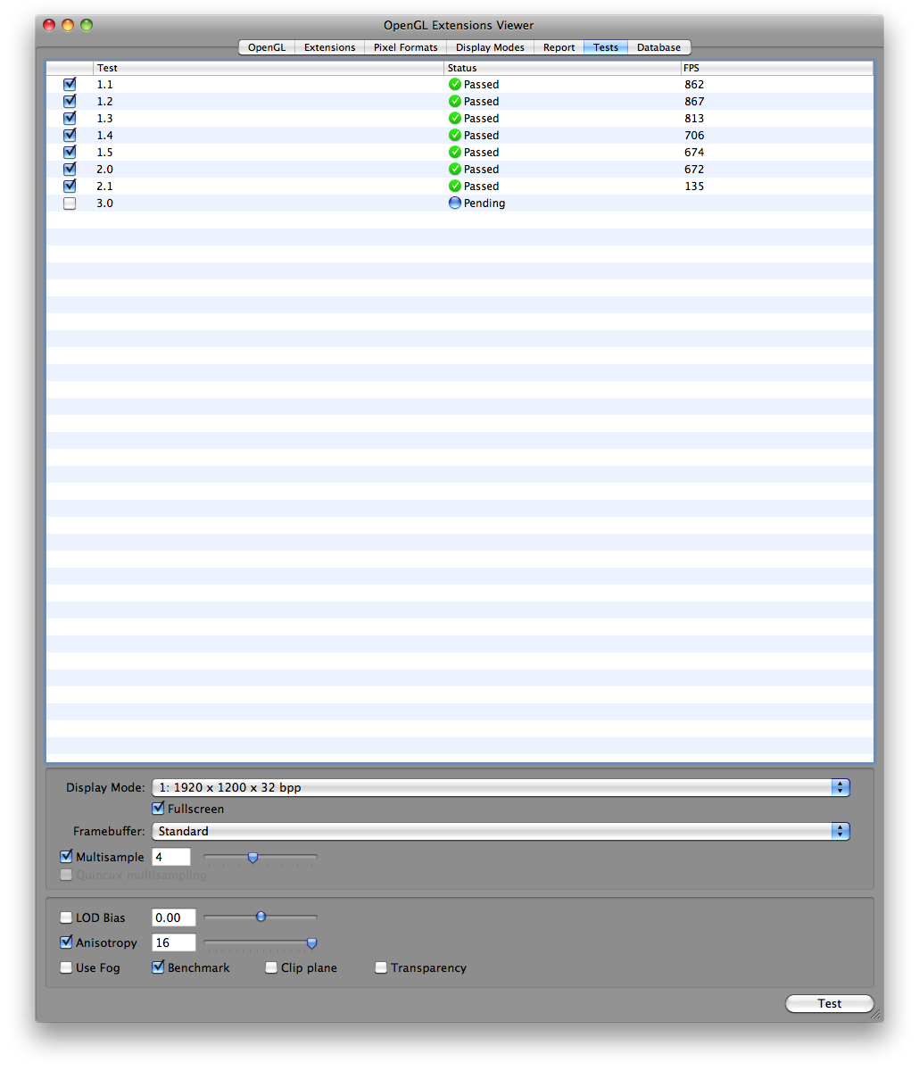

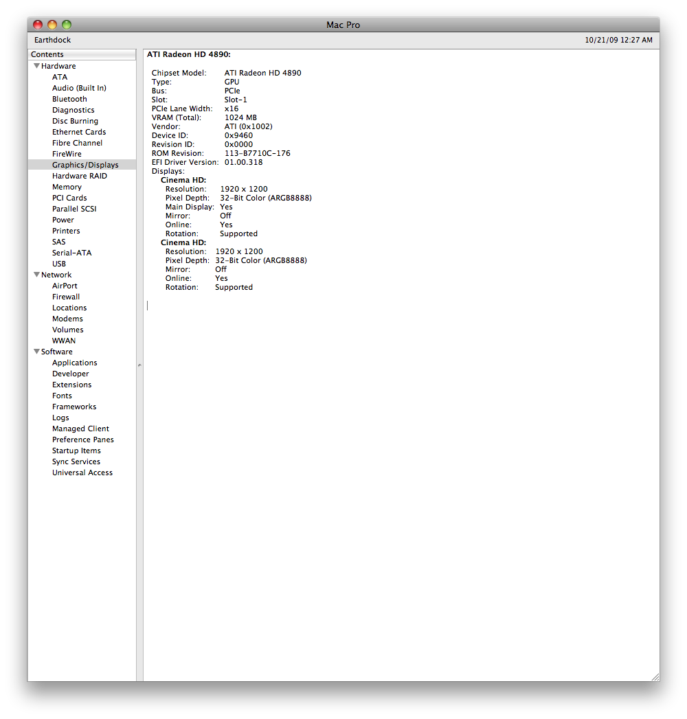

I can confirm another successful flash of the HIS H489F1GP and it's working just fine under OS X. The only odd thing I've noticed is that it's scoring lower in Xbench then my old 8800GT or even the previous X1900XT. Hopefully this isn't a ROM issue. Another strange thing is that under the Graphics/Displays pane of the ASP it doesn't even list QE or CI for either display. SameOle can you verify this as well?
qe ci is not supposed to be listed
try play video in VLC, or a game, if it works, you got it.
for the score, Xbench suck for benchmark
even opengl benchmark sucks,but it sucks less
http://krull.se/macpro
I already know QE and CI are working as expected, Dashboard widget ripple. The only weird behavior I've noticed is that quitting VLC with a video playing causes it to beachball before closing. If they're not supposed to be listed then please explain the bottom left attachment in this post.
might be cause it's an apple display
maybe third party displays does not list it
anyway not listed for me and I assure you everythings working, I've been running the card for 5 months.
Mine is still running fine after nearly 24 hours.
Fan is idling and spinning up properly under load, everything is much snappier in general for me.
Running on a 23" cinema display and a 24" ASUS display, both DVI.
QE/CI are not listed if you are on Snow Leopard. They have been removed from System Profiler for some reason.
I too can assure you QE/CI are working. Transparent dock and ripple effect for dock icons confirm this. Also, I read that opening DVD Player will throw an error if you don't have QE/CI enabled.
