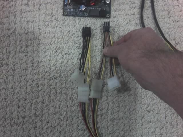

Quick question about the electrical... the HIS 4890 H489FT1GP has 2 power plugs on the gfx board: One 6 pin socket, and one 8 pin socket. My old ATI 3870 has only *one* 6 pin socket of the same type which is on the 4890, and this is attached to a cable that goes to the MacPro1,1 mother board.
The card also came w/ 2 cables: one 8 pin rectangular which splits to 2 molex, and one 6 pin rectangular (same as the 3870) which splits to 2 molexes. Do I use BOTH the 8 and 6 pin cables and then one molex plug from each of them into the first of the two molex splitters i obtained separately?
Or, do I plug the 6 pin socket from the mo-bo into the six pin socket on the 4890 board, and then use both of the 8 pin socket's split molex's into the first of 2 molex cables which i obtained? But basically the cable from my mo-bo fits into one of the 2 plugs on the 4890 board (the 6 pin). I'm under the impression I should combine the 8 and 6 pin into one cable going to the single molex plug available on the optical drive 2-plug power cord.
I hope that makes sense...

Okay, now I'm really confused. Mine is a blue board H489FT1GP... one 8 pin power socket and one 6 pin power socket on the card. I believe this is what is meant by "8x6" and "6x6"?

Is this the same card as yours? It shows a red board, but mine is blue w/ the two 8x6 plugs. The insert with the card said "HIS does not recommend putting a 6 pin plug into an 8 pin socket" but is that what you've done? You stated earlier it was powered from the optical drive - but from your image it looks like you have TWO 6x6 cables and I cannot tell if one or both of them is attached to the mother board...
I currently have an ATI 3870 with one 6 pin power socket, and it uses the Mac Pro cable included which seems to go direct to the mother board... no molex involved, and it does not go to the optical bay as far as I can tell (I know they all go the same place eventually, but I am not sure if I should use this cable AND the 8 pin or get both cables to the optical through what is pictured).
I am under the impression that on this new HIS 4890 I need BOTH the 8-pin and the 6-pin socket filled. The card also came with 2 cables: 8 pin to 2 molex and 6 pin to 2 molex. I am getting ready to plug both in, and then connect one molex from each to the first molex splitter in the chain of 2? And the second molex splitter is just for length to get it up to optical bay?

Is that what you did? Alternatively, I can plug the 6 pin cord into the mo-bo, and the 8 pin cord has 2 molex which both can go to the optical drive power supply through my two molex splitters. But I don't know if it can do 6 pin -> mo-bo and 8 pin to optical drive. Too much power? I'd rather err on the side of too little power.
Basically, I'm terrified of frying this thing in a ~$200 experiment... Anyone who knows electrical stuff might be able to get a free ATI HD 3870 from me if they know for sure!!

Plug the 6-pin into the motherboard. Take either the 8-pin or 6-pin (honestly, it doesn't matter one bit) and then plug in one of the molex plugs into the second optical drive power plug-in. I wasn't able to do that without removing the optical drive itself and having it sit on a stack of books outside the machine 😀 but you could always grab an extension cable if you don't want to wait a week for ATI to ship you another 6-pin PCIe cable.
The discrepancy in how I had the card comes from this: at the time of the earlier post, that was how I had it. At the time of the pictures I'd posted, I'd received my new power cable from ATI and was using that. No, your card isn't the same as mine - you have the Turbo edition, mine is similar but has the standard clock.
Yes, I put a 6-pin PCIe cable into an 8-pin slot. No power issues at all, it runs exactly the same as it did when I was using the molex cable. Both the PCIe cables are attached to the motherboard - if you'd like more pictures I can take them.
It looks like from the picture you've posted that you have the cables plugged into the molex adapters properly, but I can't see the other end of them so who knows what's going on down there. 🙂
