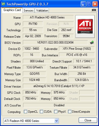

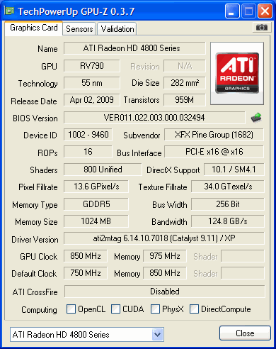

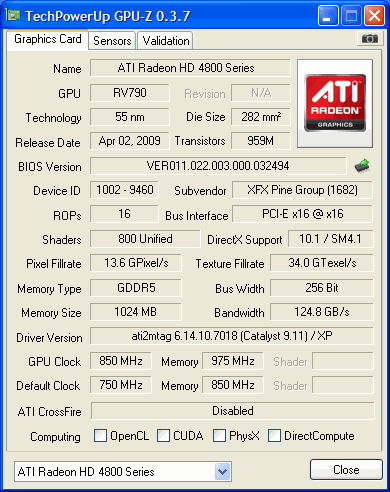

This is the rom from the card which should be the sapphire new edition hynix rom. Unfortunately I did not save the original rom 🙁
http://dl.dropbox.com/u/137795/ati4890/RV790-hynix.bin
Screen shots of card and box:
http://dl.dropbox.com/u/137795/ati4890/box2.jpg
http://dl.dropbox.com/u/137795/ati4890/card2.jpg
Hardware info reported in OS X:
http://dl.dropbox.com/u/137795/ati4890/display.png
http://dl.dropbox.com/u/137795/ati4890/pci.png
Screen shot from GPU-Z:
http://dl.dropbox.com/u/137795/ati4890/gpuz.gif
Thanks

H0M3R, so that is GPU-Z dump, after the card was flashed with hynix rom in ROMS.zip ??
because that rom you posted is not the same as hynix from ROMS.zip or SAPPH_NE_HYNIX_EFIROMFX.rom (those two are identical anyway).
which leads me to believe that the flashing is not done successfully and that you are still on your original PC rom.
are you using ati flashing tool 1.2?
do you get a flash completed message?
Thanks

Correct, the ROM posted above was dumped after the card was flashed with the hynix ROM in the roms.zip.
I am using version 1.2 of the flashing tool and got a flash completed message and the flasher.app does appear in the dock. Could there be something running in OS X that would prevent flashing?
Maybe I should try flashing in DOS or Windows? Are there instructions posted about how to do this in DOS?
Thanks again.
Thanks again.
