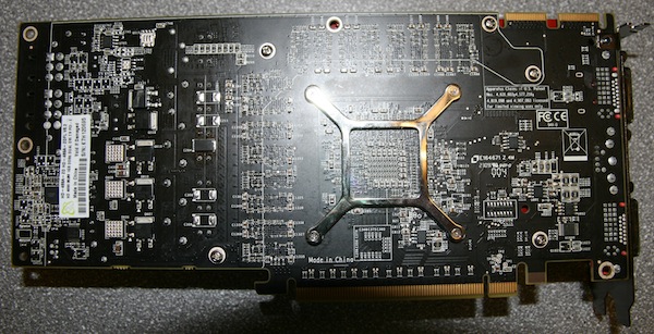

Will this work?

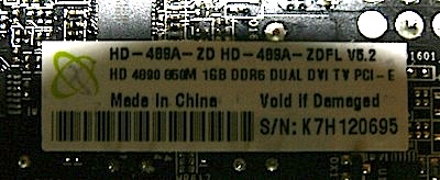

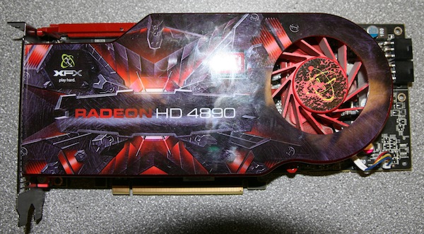

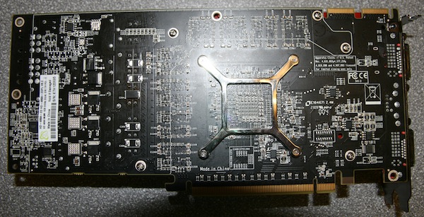

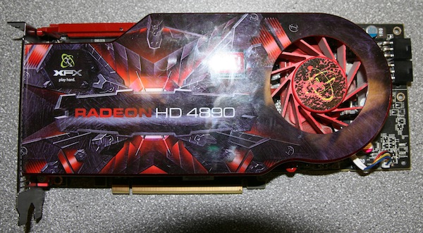

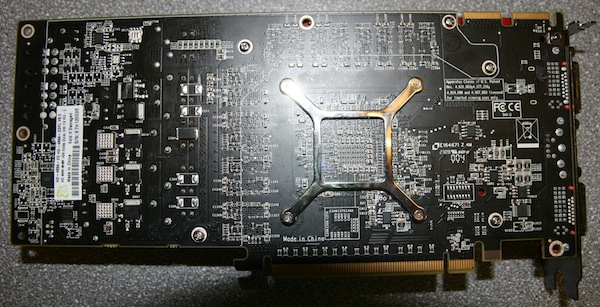

I have an XFX HD-489A-ZDFL ver 5.2 I'd like to use in my Mac Pro early 2008 2,1.
I've tried the XFX rom from the 1st post and it didn't work in either Windows or Mac, so I've flashed it back to the stock firmware. I can upload the original firmware if that helps.
Any idea how/if I can get this card working?
Xfx Hd-489a-zdfl
Thanks Cindori
rom attached
MD5 : dd6fd24c0fdac7037006027833b1d793
Pictures included for reference.
  • RV790.bin.zip
    RV790.bin.zip

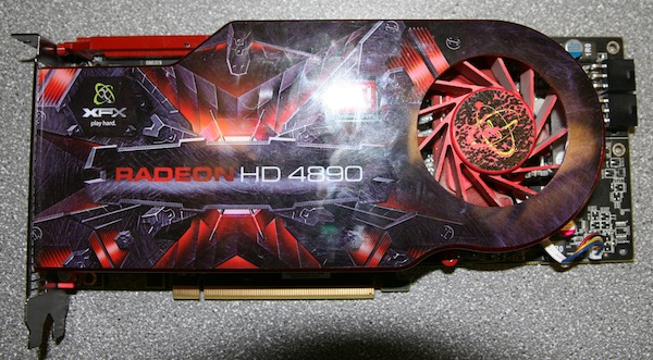

Success
it works!!! Thanks a lot Cindori.
Couple of minor issues.
No QE, but the patch in the ATI Flashing tool sorted that.
I get a power cable warning message. The card is connected to the power connectors on the motherboard with a couple of cables I got from eBay. Should I try the molex route or will this always come up?
Finally and most annoying is the noise. I think the card was designed to run upside down where it's pretty quiet. The right way up, the fan drops and rattles. I might have to get hold of a different cooler for it unless anyone knows a fix.
Once again thanks a lot guys, brilliant work.

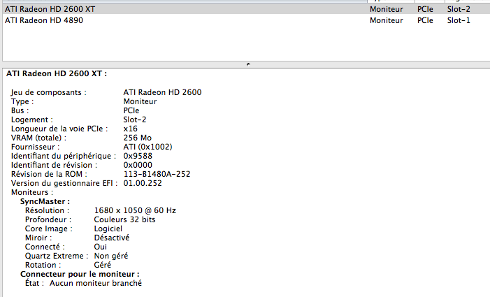

Hi all,
I am at the end of my knowledge and really frustrated:
I bought a Sapphire Vapor-X HD4890 1G GDDR5 PCI-E HDMI/DP/DVI/VGA card.
The SKU is 11150-05-20R
Zvoni
modified your rom
http://groths.se/Saph_w_hdmi.zip
when you flash with AFT, check the dock. during the flashing process, an icon appears. if it only stays for 1 or 2 seconds, it means it cant find card, so you'll have to flash with Bootcd.

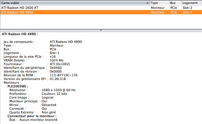

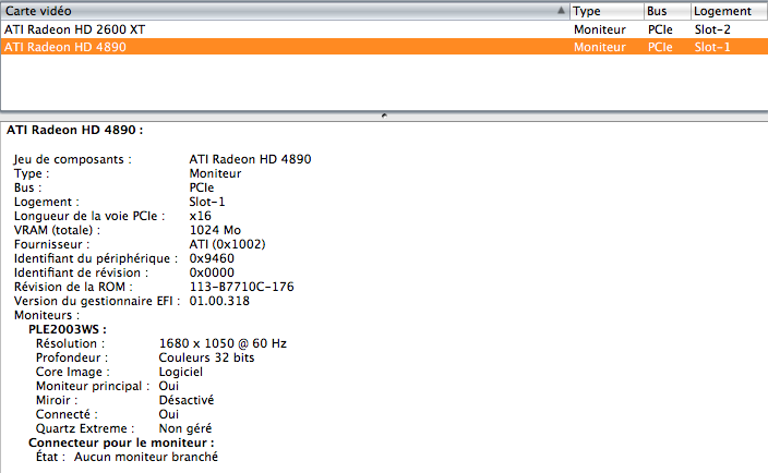

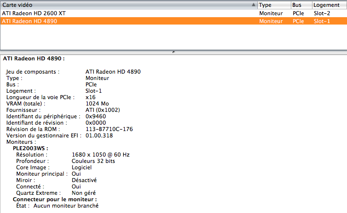

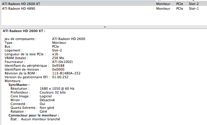

With same card references (PN 288-1E115-020SA), I succeded in flashing it with aft and the "special" rom from Cindori but tried to get QE with package for exotic cards but I don't get it...
Thanks for help !
Mac pro early 2008 3,1 MacOS 10.5.8
