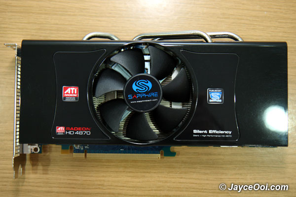

I purchased a used Sapphire 1gb HD4870 PN 11133-04
And just wanted to make sure the bios in your download for the sapphire 1gb is correct, the image you have with the file is with the newer heat sink and fan.
Thanks for you help!
attachment.php
you can save a backup and then try whatever rom youd like, if it doesnt work then upload and ill modify your backup
