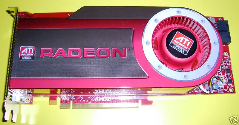

My graphics card is XFX HD4890 XFX 4890 HD-489X-ZSFC Rev 1.6 that looks like this: Click for Picture
I attached the new rom file I used. I flashed it using the boot cd.

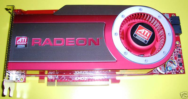

4870 1gb
Hello!
I'm new in this forum and I have got a question about the 4870 1Gb Version (100% the same fan as the apple one). Is it possible to flash the card with the original Apple rom or do I need a special rom?
And is it true that this card (if it would work with the apple rom) would be plug and play (no osx patching necessary?)?
I haven't found anything about this card in this thread!
Picture of the card below.
Thanks
Just having the same fan doesn't mean anything. My 4890 has the same fan as the Apple 4870. 😉
Provide a bit more information (manufacturer, revision, etc) and dump the ROM via GPU-Z in Windows, if you'd be so kind.
i think what he's trying to say is that the card is OEM as in 100% like the original reference ati card that the apple one is based from.
no, you can't flash with the apple rom because it is for 512mb card.
upload ur rom and i'll fix it for u

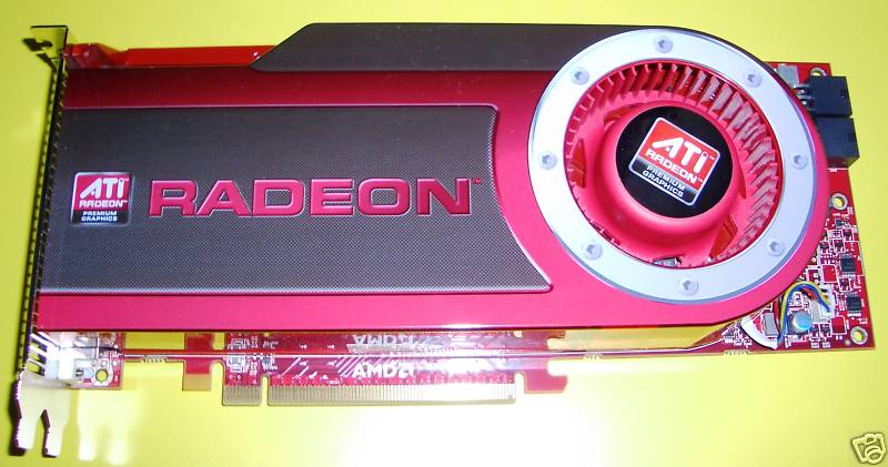

I can get an XFX originally purchased in 8/09, or a Sapphire Vapor-X also purchased originally in 8/09, both for the same price. Should I choose one over the other?

I'll get the product code and see if it's one of the overclocked or standard.

Ah, interesting. Insofar as you're aware, has anyone gotten the Vapor-X to work fully?
that looks pretty reference, I think it will flash straight away with the xfx rom in the ROMS.ZIP in the ATI Flashing Tool thread. But make sure to save rom first with gpu-z.
kernel_mach worked great, saved me a complete reinstall, thx😉
