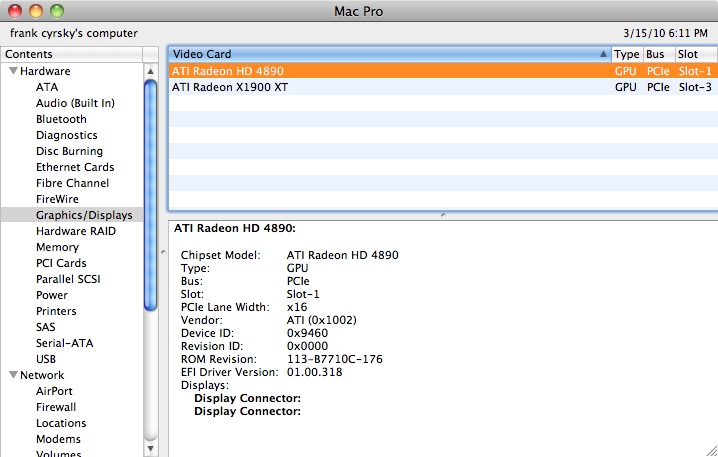

well, with my existing 1900 in slot 1, the xfx4890 in slot 2/3, with expansion slot utility (found in system/core services) and the setting changed from the default 16x, to 2/3 slots 8x-- ain't gonna cut it:
black screen...period. maybe, a 7300 has less bandwidth requirements. I suspect so. Shame my 7300 died @ a month ago; otherwise I'd might be another successful 'hot pa-tootie'!
So, I'll look into what I need to do...not discourage a bit.
here we go: I installed the new power cables to the 4890, molex cable to the 1900XT connected to Cine display. 4890 in slot 1, 1900XT in slot 3. Booted, screen came up along with expansion slot manager—showing 2 cards recognized! Sys Profiler showed the 1900XT and in slot 1, another generic described 'device'.
Zeus loaded the natit & ATI, during the driver install, a 'kernel panic' forced a restart. Now the 4890 is fully recognized in system profiler in detail(?) So, I went to flash the rom. Can't find my MODIFIED.ROM? Did it flash? And disappear?
flashing should not consume rom.
Nor did it. But I can't figure out where I stashed the new rom. So, I downloaded what I had 'attached' yesterday in a post. And it works. minor horiz. lines (pixels) when I drag the mouse. Any ideas on that Cindori?
No, power cable missing message—after I removed the 1900XT. So it was the lack of ati cable(s)—and using the molexes that were underpowering the 4890(?) going to boot into Win and see whats-what.
I booted into my 1.5.8 HD and and no horiz. lines with mouse movement. Just perfect! I wondering why SL on my install HD has that problem...
Now, I booted into my other 10.6.2 HD and ab-sol-ut-ley perfect! Just the power cable warning. No artifacts. I'm a hot pa-tuttie now!
Big thanks, Cindori, Rominator, Netkas!! Big thanks! XOX =OP
