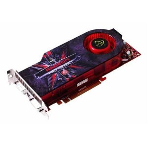

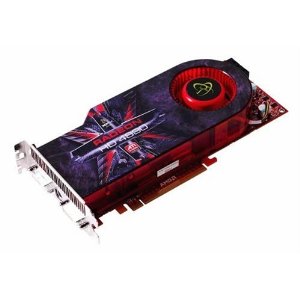

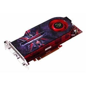

This is for Mackilroy
The website that you just gave confuses me a bit because it doesn't show the same picture that resembles what is on the "Golden Guide" pics (http://www.groths.org/?page_id=74). And what about the model numbers? They too are not on the "Golden Guide" page. Whatever help anyone can give would be awesome, thanks PNugg...
Here's more detail for anyone who reads this
