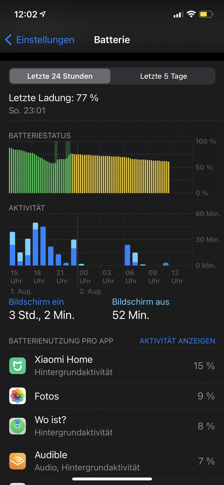

Looking not so good.

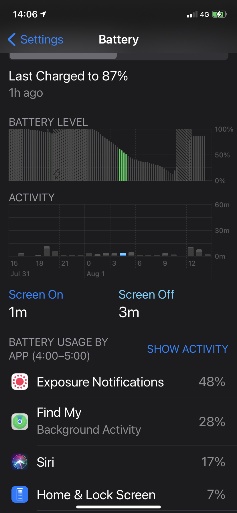

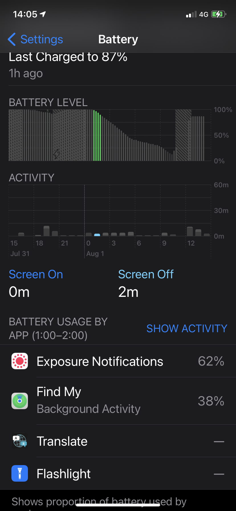

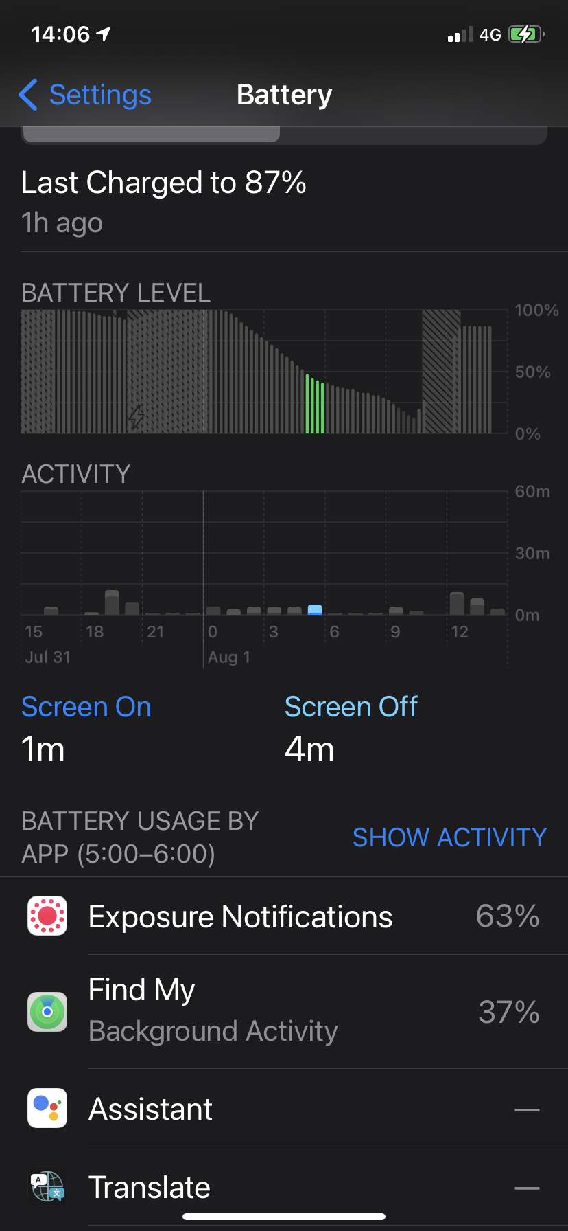

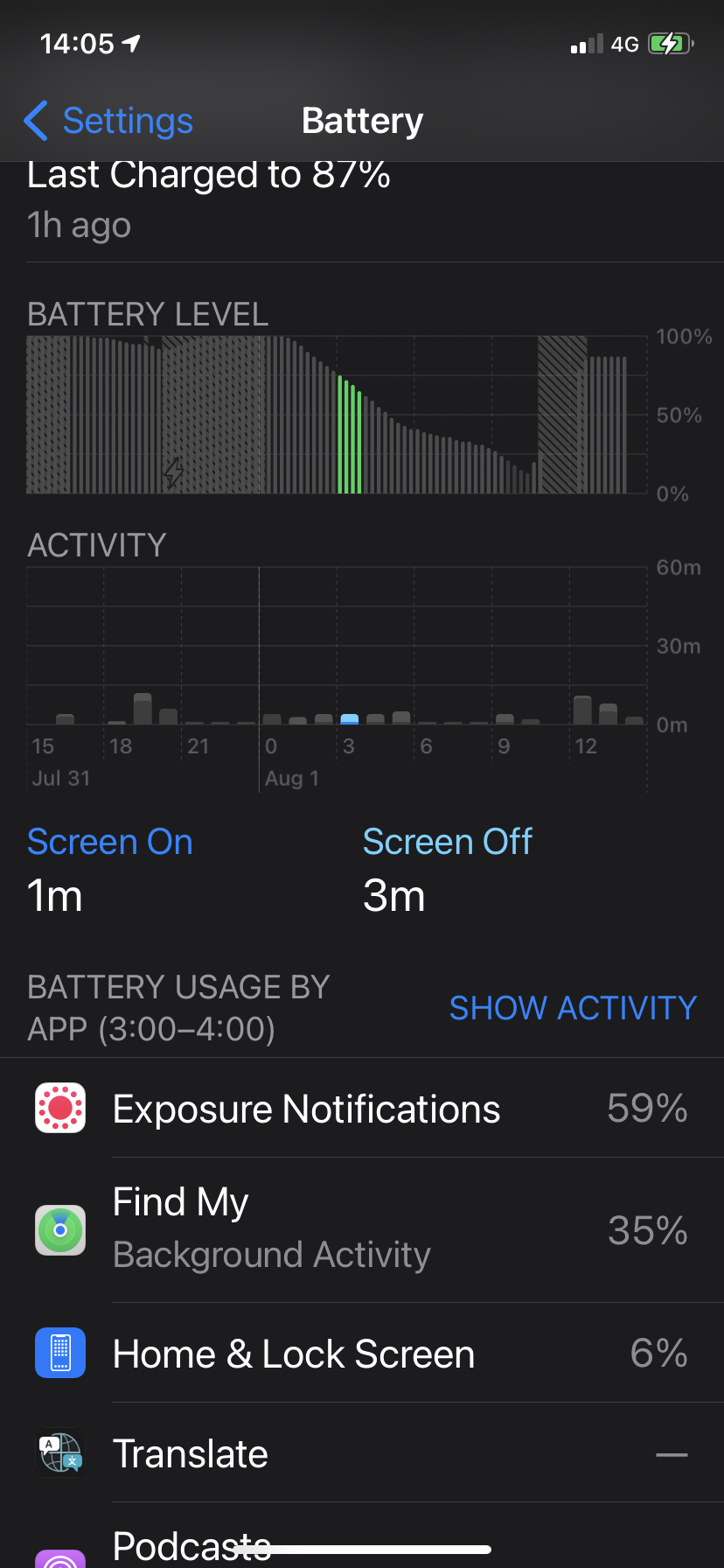

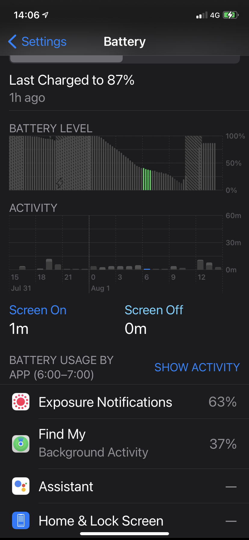

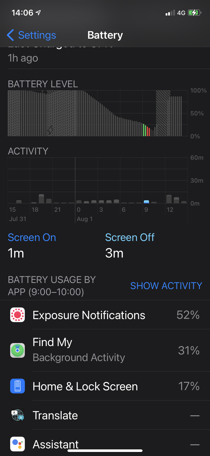

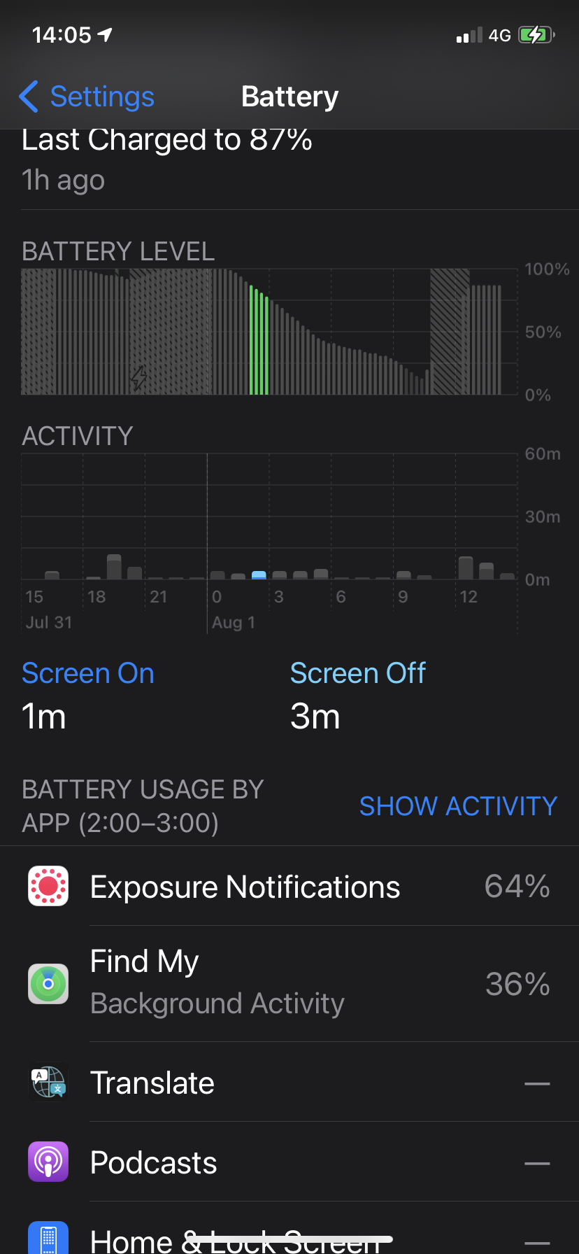

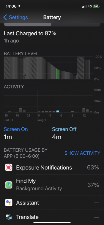

This happened on my iPhone 11 last night. When I woke up this morning, the phone was warm. That never happens. And the battery was in the red at just a few percent (from 100% 8 hours earlier (I think)).
In my case. though, there were two culprits:
1) Exposure Notifications (Japanese COVID app)
2) Find My
Since both of these use bluetooth scanning, my guess is this is not an AirTag problem specifically; it is a bluetooth scanning problem on the phone.

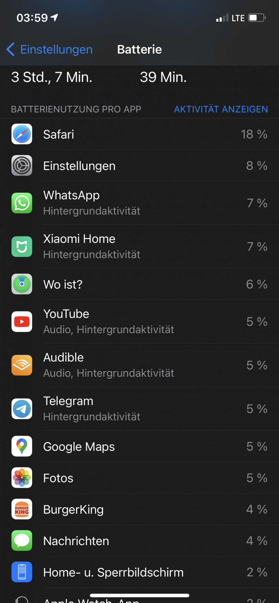

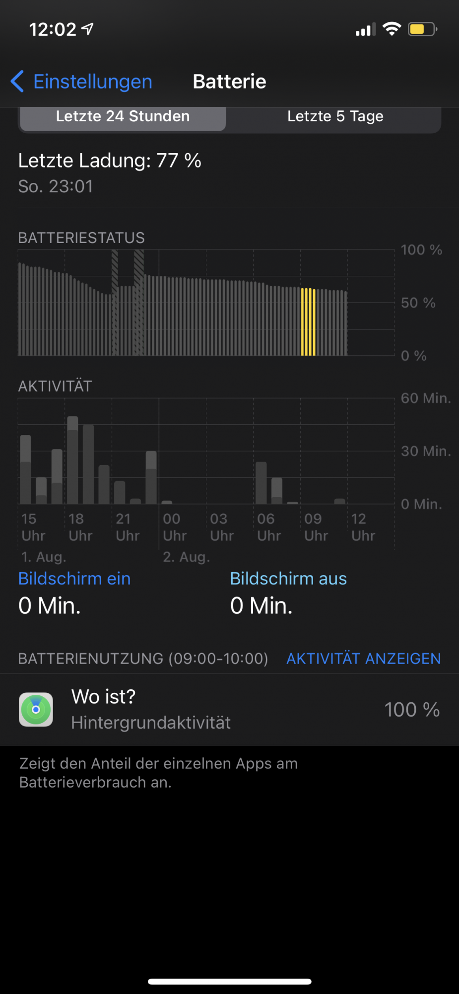

So finally decided Air Tag are the worst. Its leeching my battery like hell from my new (no backup setup) Iphone 12. Even though I noticed my iPad 2018 behaives the same.
Uninstalled Air Tags again.
Here are the results
