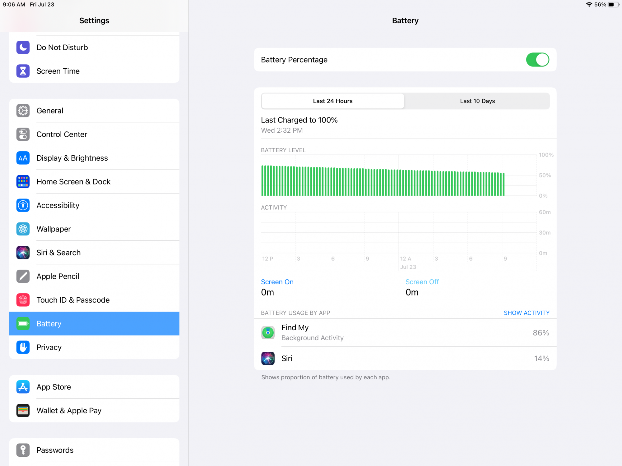

Do nothing with the app. Let it sit idle over night.
Battery dropped from 89% to 87% with the find my was 8% usage. I'll keep it going for 24 hours. I have 4 Airtags. So I am not experiencing the battery drain others are experiencing. I did trigger the app when I made sure that the air tags were showing up on the app. so the app is running but nothing else.

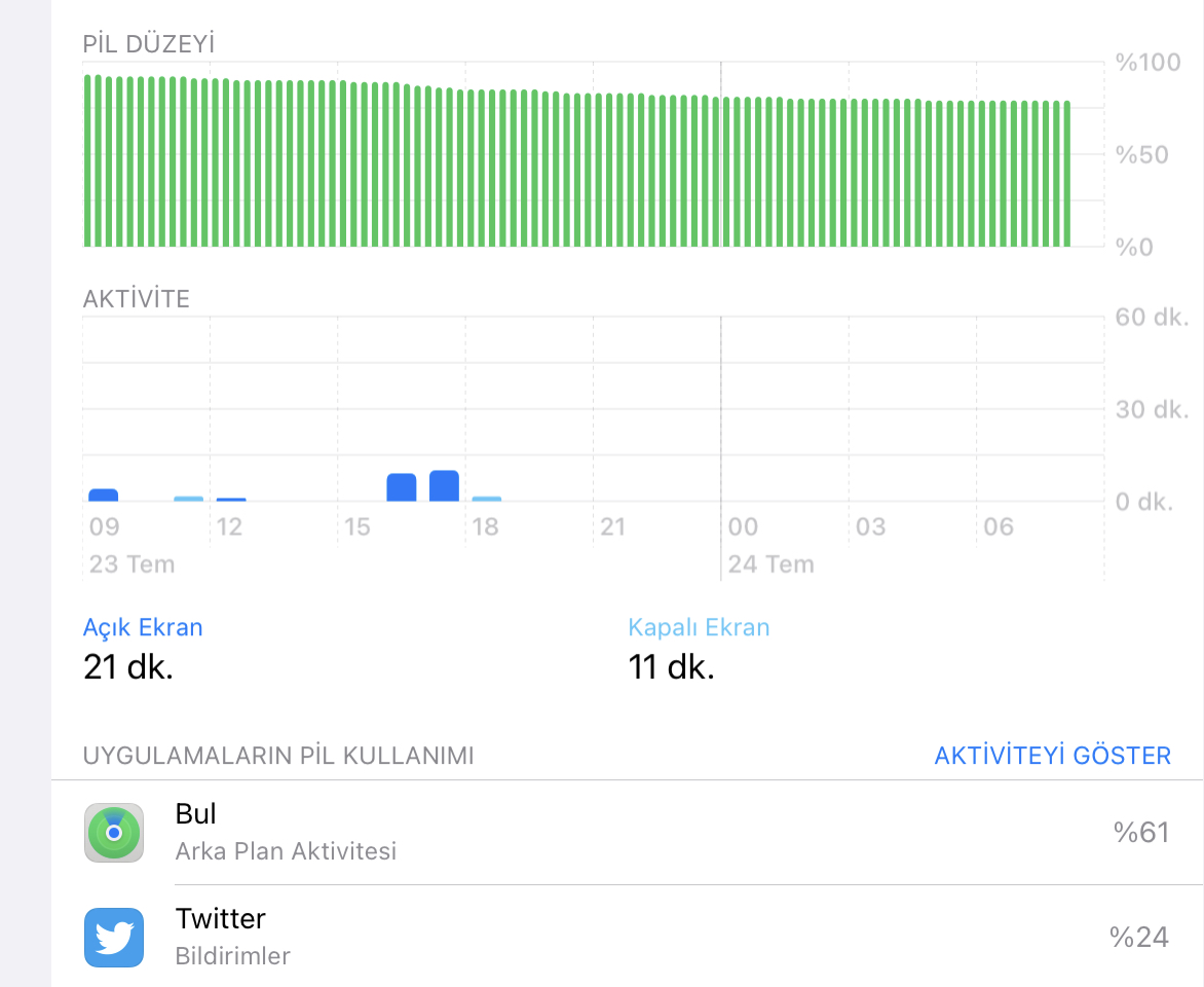

OK 24 hours later... My device has gone from 89% to 87% and the find my ... is at 21%. Since I am not seeing the huge drain I am standing by my initial theory, the loss of battery time is due to stuff running in the background. But what do I know about anything. I do know how to use punch cards, a dec writer, and owned a TRS 80 with a stringy floppy. bye all, this thread is boring.

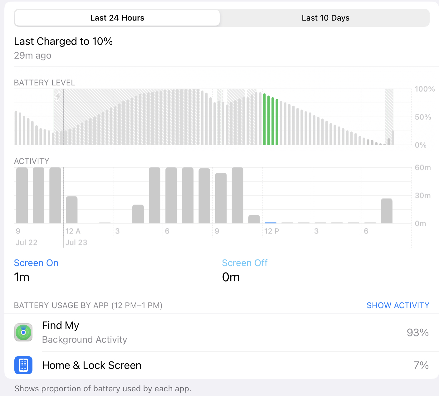

Never had a problem with Find My. Today I left the house around noon with the iPad charged to 95%. I came back before 7 PM — the iPad was dead. Complete battery drain with the main culprit evidently being the Find My app. It ran at around 93% for the entire time I was gone. Had my iPhone and my AirTagged keys with me, but I often do this and never had the issue before. I have 14.7 loaded on everything. Hope this is a fixable bug.
Report it to Apple. I have several times.

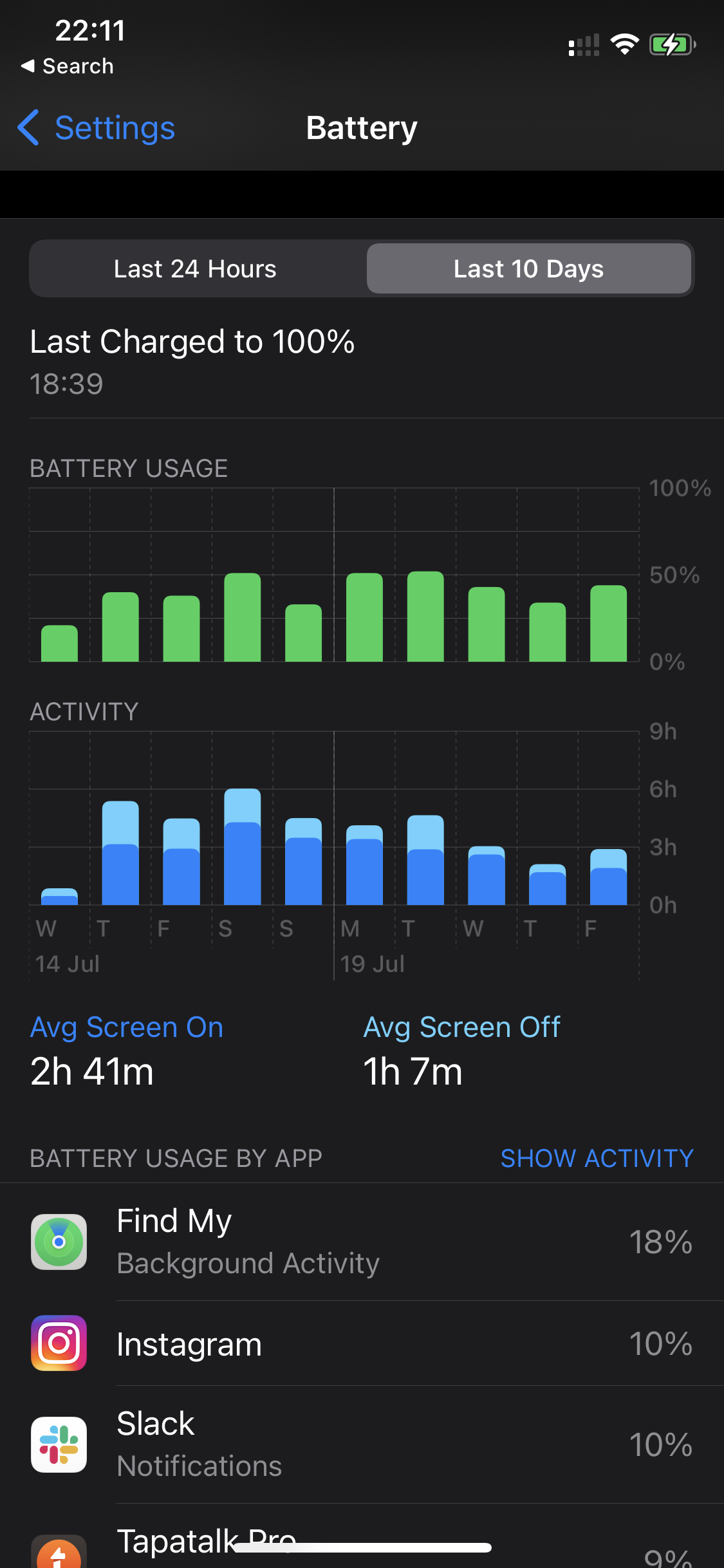

Funny, FindMy battery usage was around 10-15% in average. I have 3 Airtags connected. After I removed one (with two still connected), the battery usage went down to 3-5%.
1. Keys.
2. Bicycle.
3. Car.
I removed the car AirTag.
