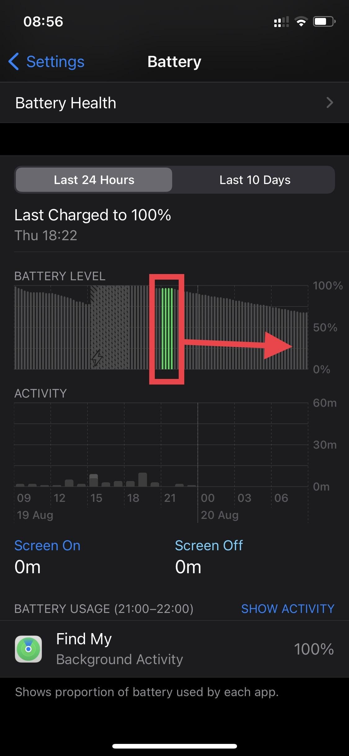

Looks like my situation is no better either. Here’s what I had last night and the red marked battery drainage is only due to Find My and it’s background activities.
