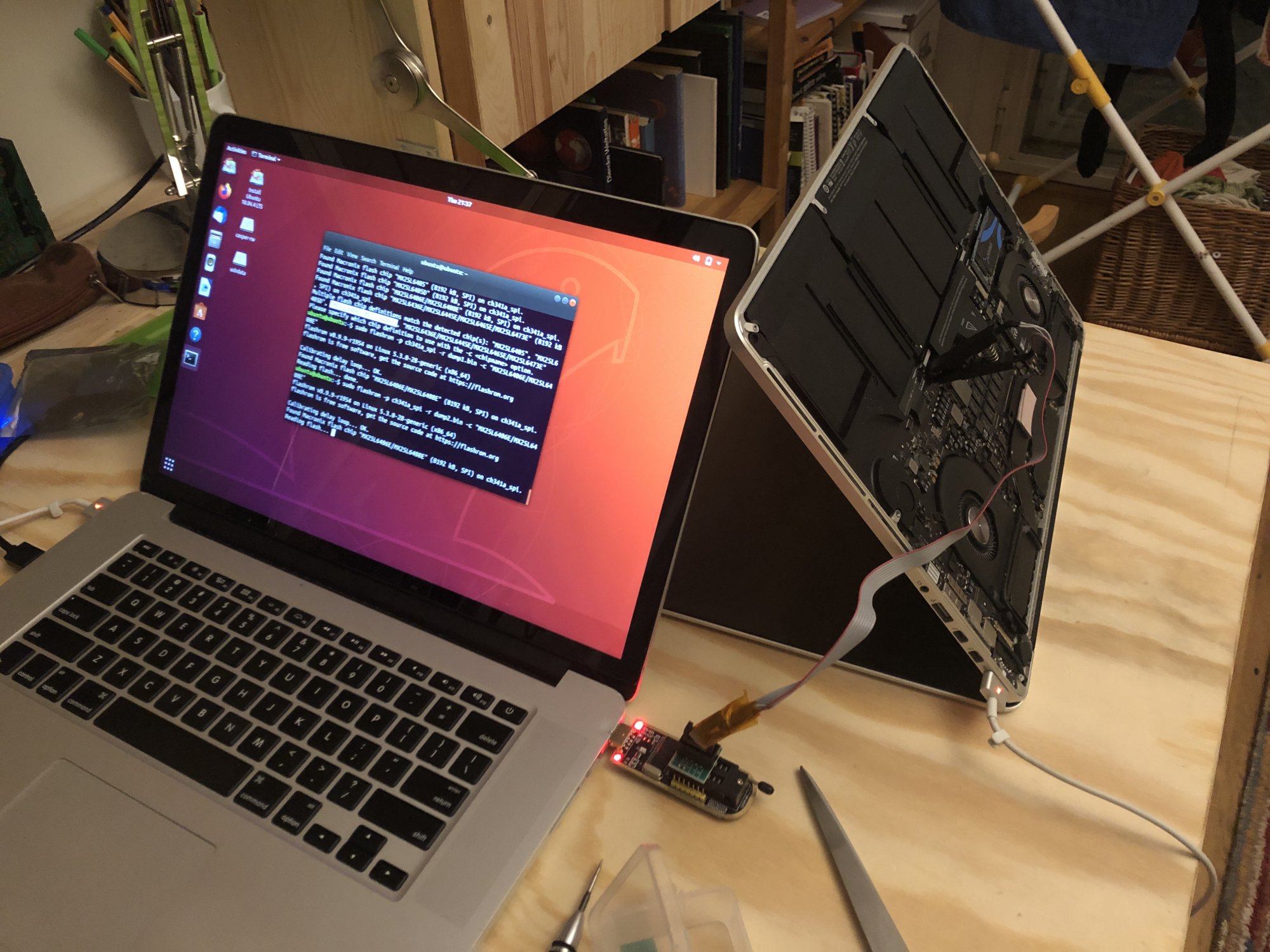

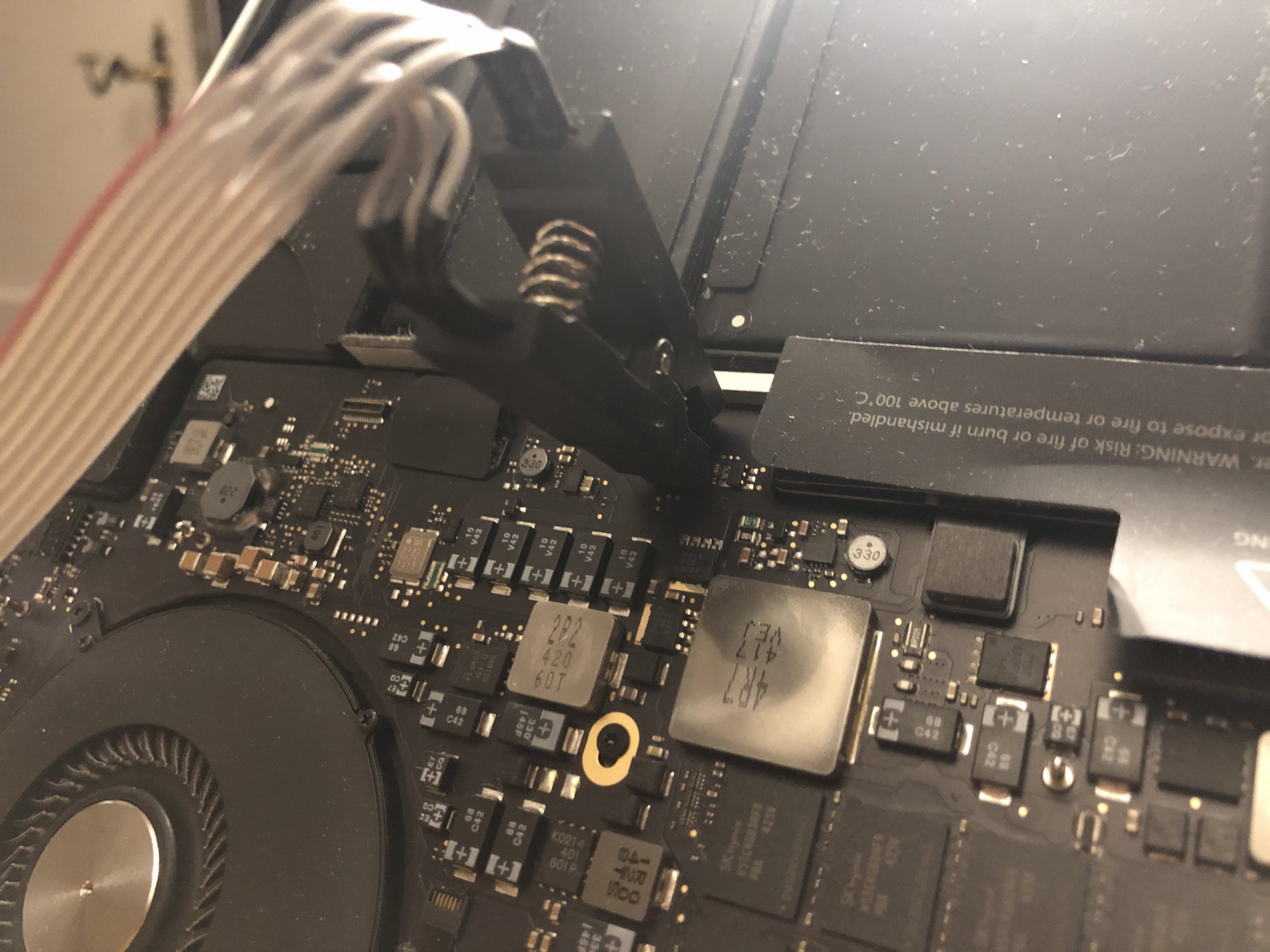

Think I may finally be ready to try the SPI programmer route for my 2013. Any recommendations for where to get the J6100 adapter these days (I assume the CH341 on Amazon should be fine)? They're are $55 on eBay, and ship from overseas. Thanks!
The cheapest is eBay for that $55-$90 otherwise you could try and wire your own but you would need to buy a Hirose DF40 connector that matches your specific connector, which is the 30-pin I think.
Reactions: dhazeghi

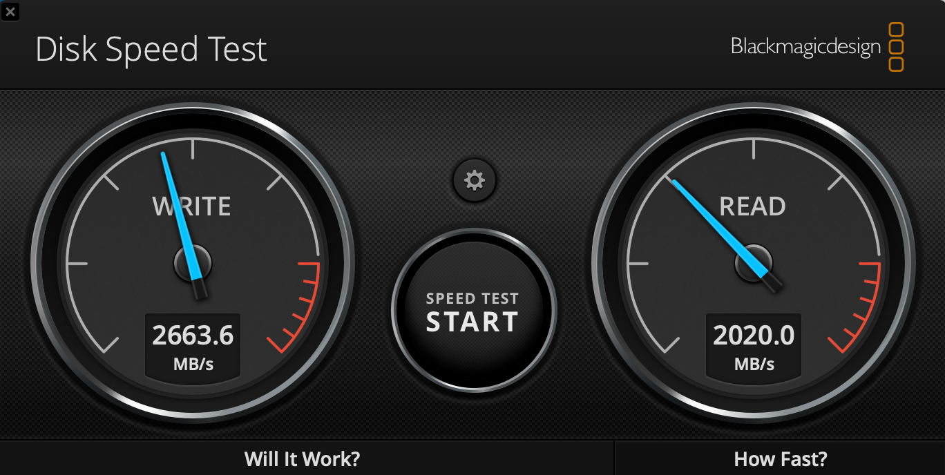

Quick update : just performed the upgrade. I also cleaned and changed the CPU/GPU thermal paste.
So far so good. Running Sabrent 2TB and a Sintech adapter. I always use my macbook plugged in, so I won't be bothered if there's more power draw. Here's a snapshot of a disk speed test I just performed.
Reactions: vpujols
Did you let the Speedtest run for a while? After a bit mine starts dropping in speed.

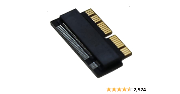

very well could a bad adapter, I've been using amazon purchased short sintech adapter (link below) since 09/19 with no issues whatsoever, possible fake ones? i don't know.
Apparently that is the exact same as the one I have:
Purchased 1 time.
You last purchased this item on November 8, 2019.
