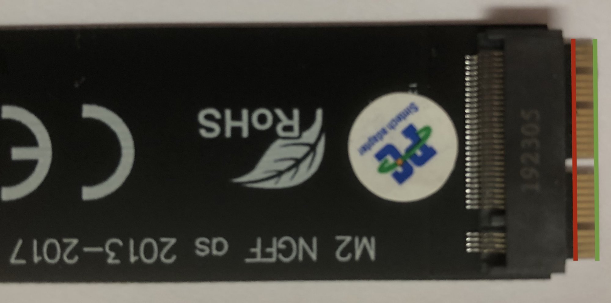

Someone commented above about using Kapton tape or some other insulator to avoid having the pins short out on the metal housing. Try that first, I doubt the connector failed because they are nothing more than trace wires that map one interface to another. If you have a microscope you could look to see if any of the solder joints on the connector are broke or if it may be shorting out when you have it installed. I've had the same thing happen before. The flashing question mark folder just means it cannot find an operating system which means either you don't have one installed properly on the drive or the drive is malfunctioning (i.e., drive pins are shorting to ground as described above). Good luck and let us all know what fixes it.
Reactions: Berlinsky
For me, on a 15 inch 2015 MBP, Kapton tape was the answer. First at the end of the adapter, reducing the amount of metal exposed on the pins being inserted into the socket. That fixed most of my problems. Was still getting a few problems, so Kapton tape on the surface underneath the SSD. No idea if the latter did anything, of if just reseating it fixed it, but so far so good.
Can you clarify where you placed the tape?
In my picture below did you use it on red line or the green line?
Red line; however, it looks like you have the newer adapter whereby kapton tape isn't required.
