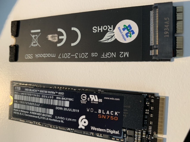

would this be the correct procedure:
- clone/backup with CCC (does my external drive need to be formatted to APFS for proper backup/clone?)
- create bootable usb osx catalina install
- fresh install to SN750
- install CCC
- run CCC to restore Data volume
did a fresh install. didnt restore from back up yet. just testing to see if it will crash typically from opening lid. this time the crash is from leaving the lid open and drive went idle/sleep. when waking from pressing space bar key, it crashed. error was displaying "nvme: fatal error occured..." from the crash log.

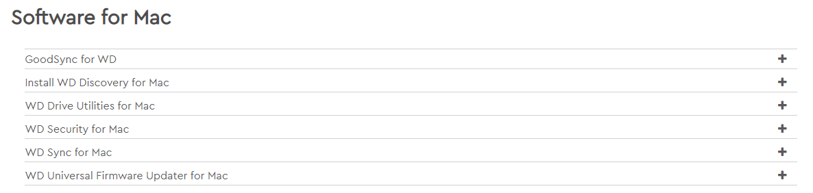

not sure if WD rolls out firmware updates for the SN750. I cant find it anywhere.
edit: there is a firmware updater from WD
the other nvme drive is being used in my PC. Dont have an extra one.
Maybe it needs an update like the Samsung Evo Plus.
the updater doesnt work. at least i dont think it is for this drive. it asked to be plugged in, im assuming its for external drives.
had the nvme in the laptop and scanned with firmware updater app, no result.
put the nvme in enclosure and plug into usb, ran a scan with firmware updater app, no result.
Maybe the drive isn't compatible? Everything seems in order.

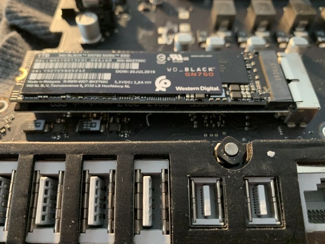

Hey everyone! Thanks for compiling all this info, it's been incredibly helpful. I upgraded my 2013 MacBook Air with a 1TB Crucial P1 SSD, and got a matt card from Chipmunk with firmware I patched to support hibernation. I'm using Mojave, 10.14.6. Everything has been working fine 99% of the time, but I hit the following panic this morning. Has anyone seen this crash before, or does anyone have suggestions on how to prevent this from happening?
Code:
Anonymous UUID:       F9564CCE-3724-05BF-C209-8FB35136FE34
Thu Apr 16 09:22:20 2020
*** Panic Report ***
panic(cpu 0 caller 0xffffff7f877e4b30): nvme: "Fatal error occurred. CSTS=0xffffffff US[1]=0x0 US[0]=0x4 VID/DID=0x2263c0a9
. FW Revision=P3CR013\n"@/BuildRoot/Library/Caches/com.apple.xbs/Sources/IONVMeFamily/IONVMeFamily-387.270.1/IONVMeController.cpp:5334

Hi guys - I really need som help here (please) !!
Just installed a fresh new Sintech Adapter and WD SN750 1TB SSD bought from Amazon in my iMac 27” Late 2015 (running Catalina 10.15.4, SilentKnight reports EFI firmware 176.0.0.0.0 is up to date) both parts should be compatible following various articles that i found.
But my Mac can't find the disk in Disk Utility (with expanded the view) ,-(((
I boot into recovery mode from a USB-boot (also Catalina 10.15.4) and have also tried via a USB-Ubuntu with the disk utility with no luck .....
You are using a Catalina or Mojave USB installer?
Tried re-installing the drive and adapter?
Are you able to test the drive in another Mac or MacBook?
(from amazon, try this)
Additional steps:
4a) for me the Disk Utility would not show the Drive, so what I had to do was shut down the MacBook.
4b) When the device has fully shut down press the Power button again, when you press the power button hold down the following Keys: 'Command/cmd' and 'Option (sometimes this is shared with the alt key as it is with mine)' and 'P' and 'R'
4c) Hold the 4 keys, you will here the MacBook chime, keep it held until it Chimes again and then release
4d) After then wait for the MacBook to boot up into the Recovery Partition and look in Disk Utility, you should see the drive in Disk Utility now. The laptop will reboot a few times before booting into the Recovery environment
