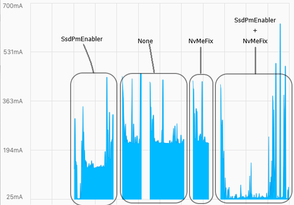

I'd like to share my experience with SsdPmEnabler / NvMeFix on my MacBook Air (13-inch, Early 2015).
Setup:
Mojave 10.14.6 (18G7016)​
MacBookAir7,2​
Intel Core i5 1.6 GHz​
Boot ROM Version: 425.0.0.0.0​
XPG SX8200 Pro 1TB + Sintec short adapter​
iStat indicated the following for idle power draw.
None - 0.22 A​
NvMeFix - 0.22A​
SsdPmEnabler - 0.13 A​
NvMeFix + SsdPmEnabler - 0.02~0.03 A (!)​
Interestingly, NvMeFix alone made no difference at all, however, once it got teamed up with SsdPmEnabler, there was a drastic drop.
Thanks for posting! We finally got a MBA running ssdpmEnabler and to include on my User Guide.
Nice graphical illustration. I'm a bit skeptical about the NVMeFix effect. Was the measurement done with AC adaptor connected? What's the time scale i.e. x-axis in your graph?
A gentle reminder to everyone: Pls connect to AC power and take measurement. Only under that condition will produce meaningful measurement for idle power consumption.
It's the "1 Hour" scale and yes, it was on an AC adapter the entire time. I did the same test with a Sabrent Rocket 1TB on my other MBA7,2, but just realized it was stuck with an El Capitan Boot ROM. Once I get it up to date, I'll try again.

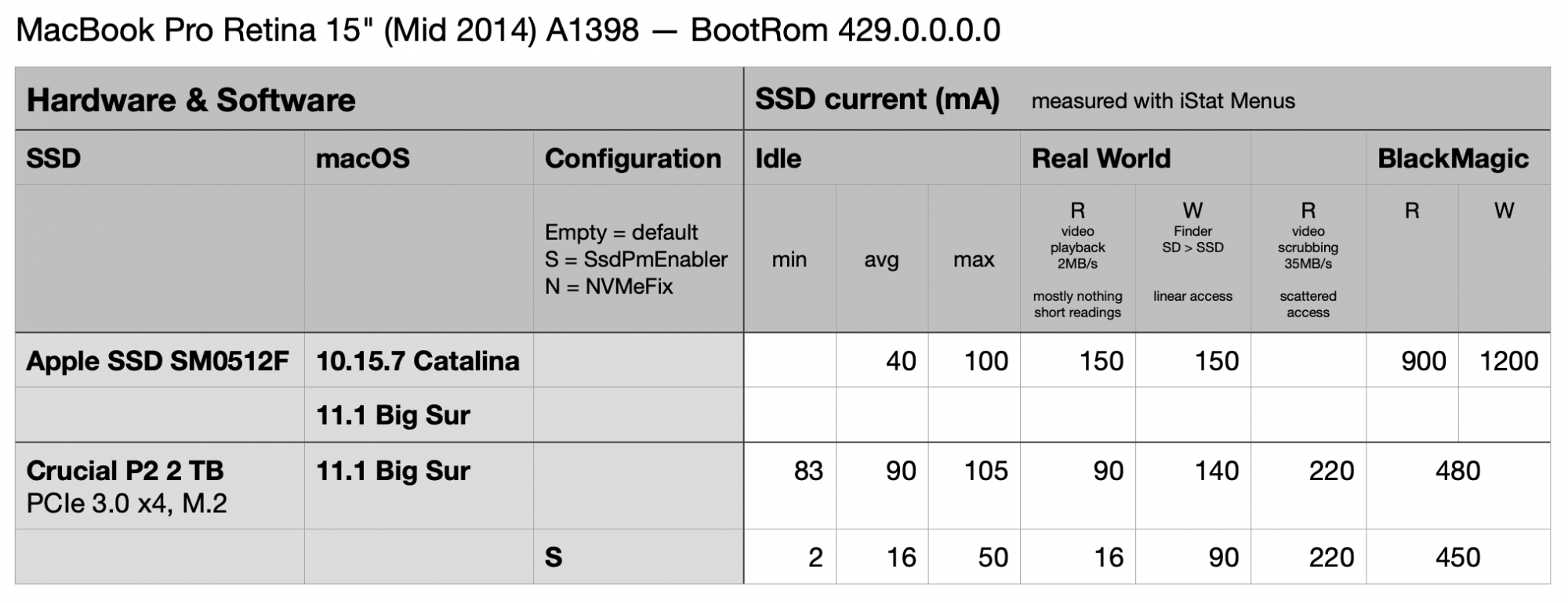

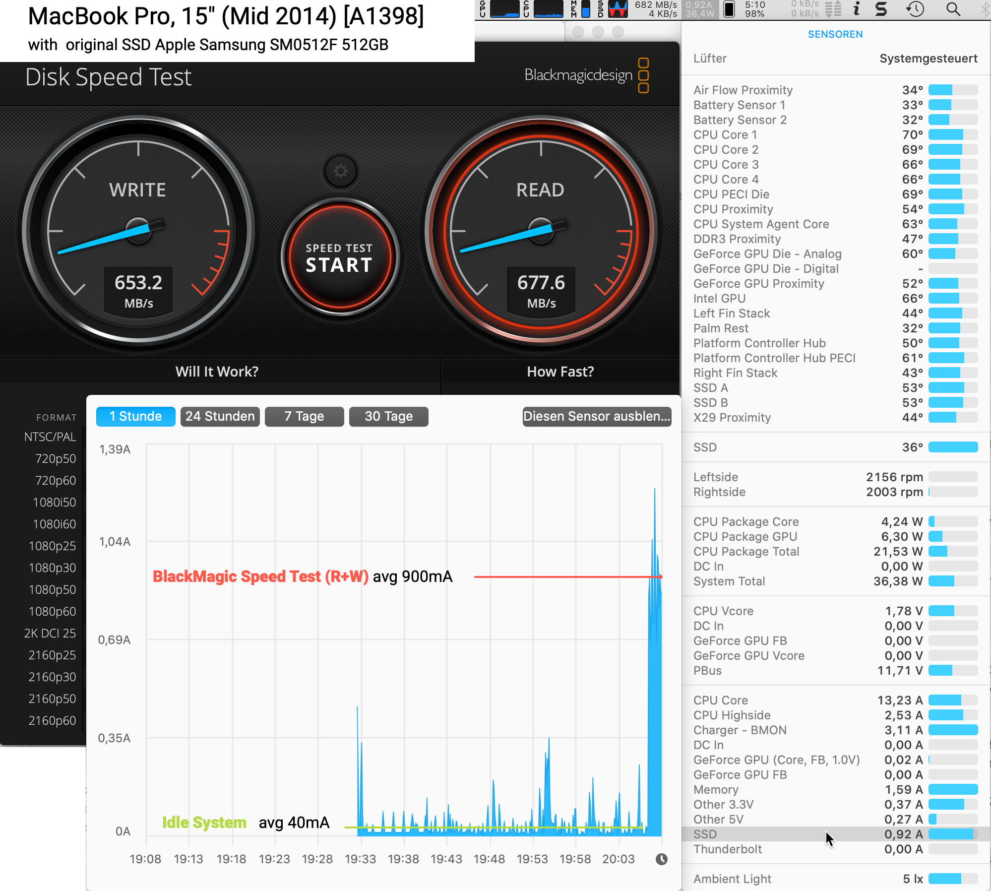

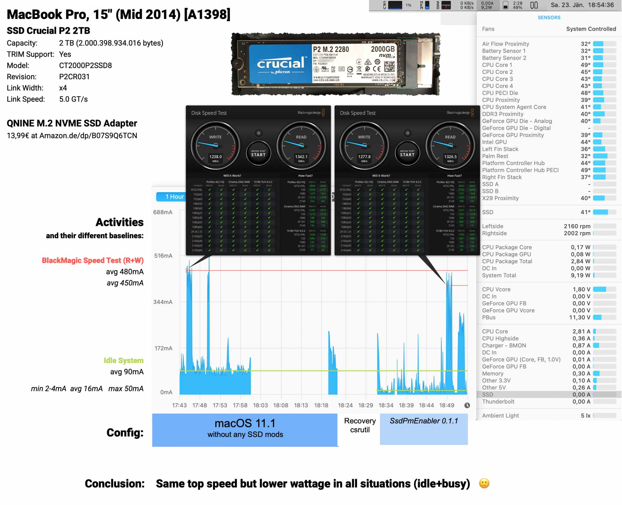

SSD Crucial P2 2TB in MacBook Pro 15" (Mid 2014) (model A1398)
Ran it for about a week. Works super for me with SsdPmEnabler as I also reported at Github.
Double the performance compared to the original, and idle consumption on average being only 16mA!
No crashes. Normal standby and wake from standby. Hibernation untested so far.
This is the setup I used and the performance I got:
MacBook Pro 15in Mid 2014 A1398 - SSD comparison - Original Apple Samsung SM0512F 512GB vs Cru...png
SSD Original Apple Samsung SM0512F 512GB in MacBook Pro 15in Mid 2014 A1398.png
UPDATE: How does the SSD perform after 1 month? Still very fine. Same speed, no crashes. All good so far!
