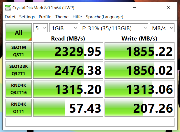

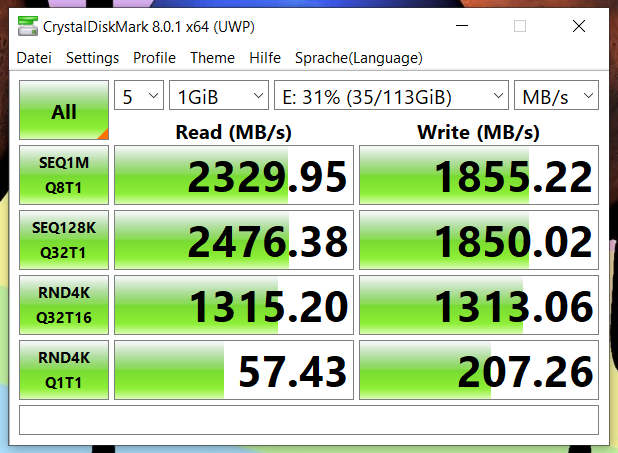

2 days ago replaced my samsung made proprietary apple 128GB drive with Silicon Power UD70 500 Gb, which should be able speed up to 3,400/3,000 R/W but speeds are only 930/1700 compared to the 600/1800 former drive's speed.
At NVMExpress menu x4 and 8.0 GT/s are shown. Is there anything that I have to do to reach higher speeds?
May be the problem, that I'm using cheap chinese adapters from aliexpress? Tried 4 types of them with the same speed results. To me they look identical to sintech adapters, but maybe not. Thx

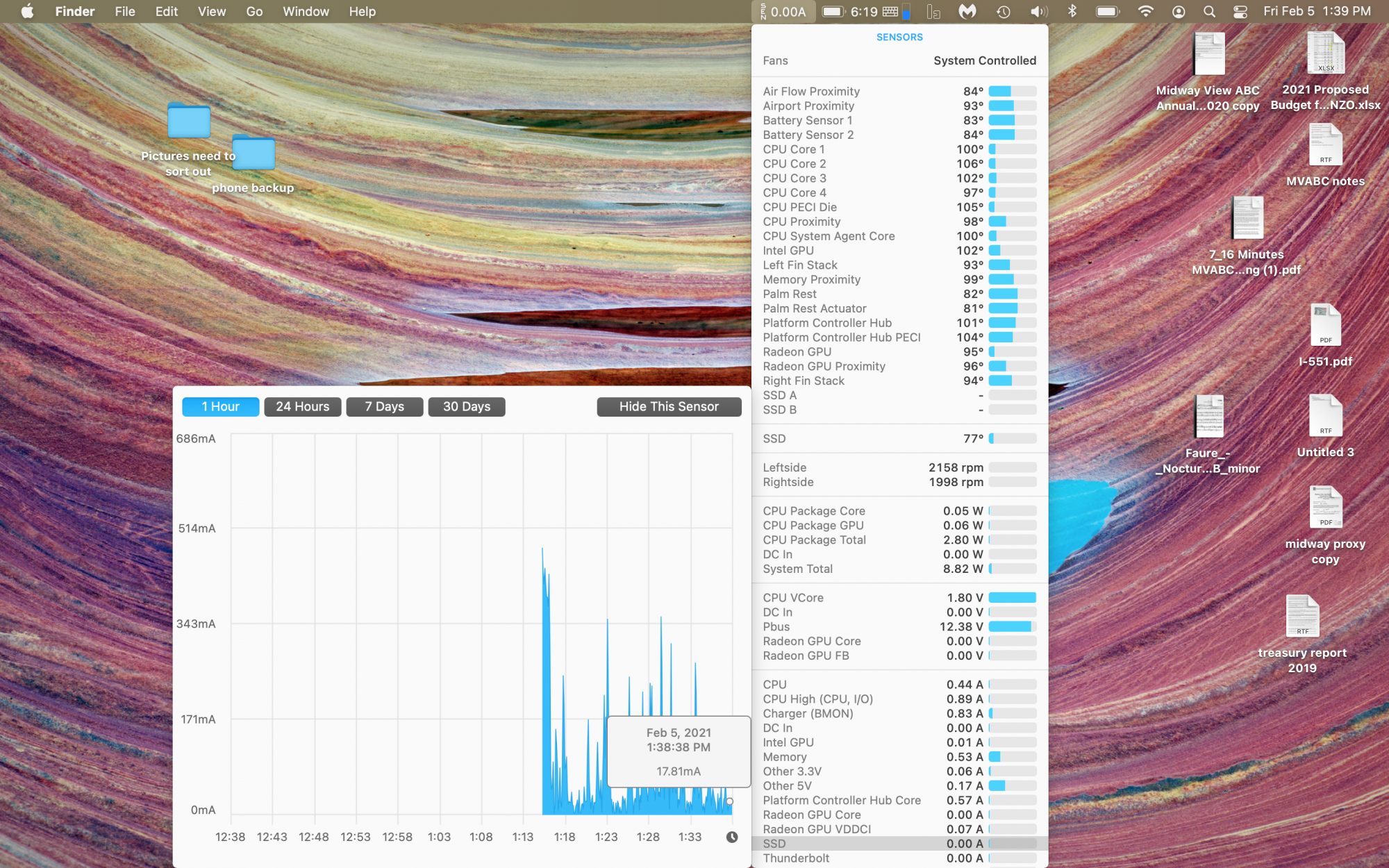

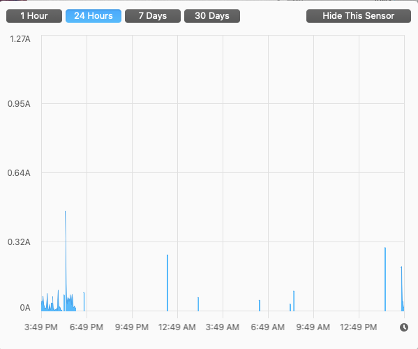

First screen:
Running idle/low usage for some time on battery. Then for about 2 minutes BlackMagic. Let the SSD come to rest (the cache of the SSD needs to be processed).
Second screen:
Running on power adapter for some time (same room, same day, next after the battery test). Run BlackMagic for about 2 minutes. Wait until the SSD has cleared the cache (it's a Q SSD).
Question: is the SSD using less power on battery than on Power Adaptor (and could the 0.00x A reading be correct) ?
iStat menus reports 0.00A and 0.17 for the battery and power adapter operation.
Lower current (i.e. power) should lead to a lower temperature of the SSD. The respective temperatures are 30 and 34 degrees Celsius (room temperature is about 18). It's an indication that the hypothesis (lower power usage of the SSD during battery operation, the 0.00A reading is correct) is correct. But I must admit that a difference of 4 degrees isn't hard convincing evidence (the power difference according to the current readings in iStat Menus resemble about 0.5 Watt).
In addition to the temperature readings: the fan is off when running on battery, and runs at lowest speed when running on power adapter. With high cpu load, iStat menus does show that the fan becomes active when running on battery (so the “turned off” is likely not an error in iStat menus). A running fan will likely have some cooling effect on the temperature of the SSD. That makes it even more likely that the power usage of the SSD is indeed significant lower when running on battery.
The reason for this test is to verify whether my observation that my Intel 660p seems to be running with power management (without any special kext file) since Big Sur (and the newest firmware), is correct. No one else has described this for an NVME SSD far as I know. So there is serious doubt, and I try to collect evidence that either rejects or supports my observation and conclusion.
I ‘m open for any evidence that supports a conclusion that the 0.00A reading in iStat Menus is a “glitch”.

How about your battery life? Is there any significant difference?
I'm not using iStat menus, hence I cannot state exact values regarding idle, etc. I'm also a bit confused about the ongoing discussion whether to measure with or without power adapter. I trust the average power consumption values stated by other users under this thread.
The power loss over night is approx. 2%. Besides SsdPmEnabler.kext and NVMeFix.kext I also adjusted hybernate settings. Compared to the formerly installed Apple SSD 256GB battery life is definitely longer now with the new WD SN 550 SSD.

No new evidence in your two screenshots. You've been repeating and rehashing the same thing in the past two months (?). I had access to 2015 13-inch MacBook Pro (MacBookPro12,1). So I knew and know what you saw. In fact, I mentioned this observation in one of my very first posts I made in this thread. Later on multiple occasions, I explained that this "0.00A" is a glitch/bogus (shall treat it as unknown) in the context of MacBookPro12,1 implicitly or explicitly. I won't repeat here. Read back my posts if people are interested.
What you see on MacBookPro12,1 is very different from what people see on MacBookPro11,3. I was asking you to perform experiment to verify any battery saving on your MacBookPro12,1. So you could conclude on your "theory" and settle in peace in your mind.
Frankly, not for me. I believe neither for anyone else in this thread by now. Personally I couldn't understand why you're so hinged to your claim. I have my psychological theory. But I think you'd better ask yourself when in solitude and have few minutes to spare.
My time in this thread will be short lived. You're and are going to last longer than me. When done properly, I believe you may be and will be one of treasured contributors.
On MBP11,2 with Apple OEM SSD I see the same 0.0 A with 430.0.0.0.0 firmware in Big Sur. It must be something in the Istat. There are no kexts loaded.
@startergo
I'm not sure what you saw in the last couple of posts when you said you saw "0.00A". I also don't know if you understand the problem of "0.00A" on MBP12,1 on battery. If you have the patience and know-how, you could go through it from ground zero with anyone interested in this topic.
@MauriceG
If I may, pls stop editing your posts. Time and time again your first and final versions are quite different in tone and sometime contents. That's quite awkward after people responded to you and to an early version of your post. If you do have to do non-trivial editing, let people know what you edit in a separate paragraph. I think that will earn you better credibility. Better yet think _twice_ before you post.
No, it's not the beginning of discussion on "0.00A" glitch. I've had enough said in the past in this thread. It's the end from my perspective. Nobody owes anyone else an explanation, fulfils their curiosity or sometimes corrects their stupidity. I'll simply ignore the same repeat and rehash in future.

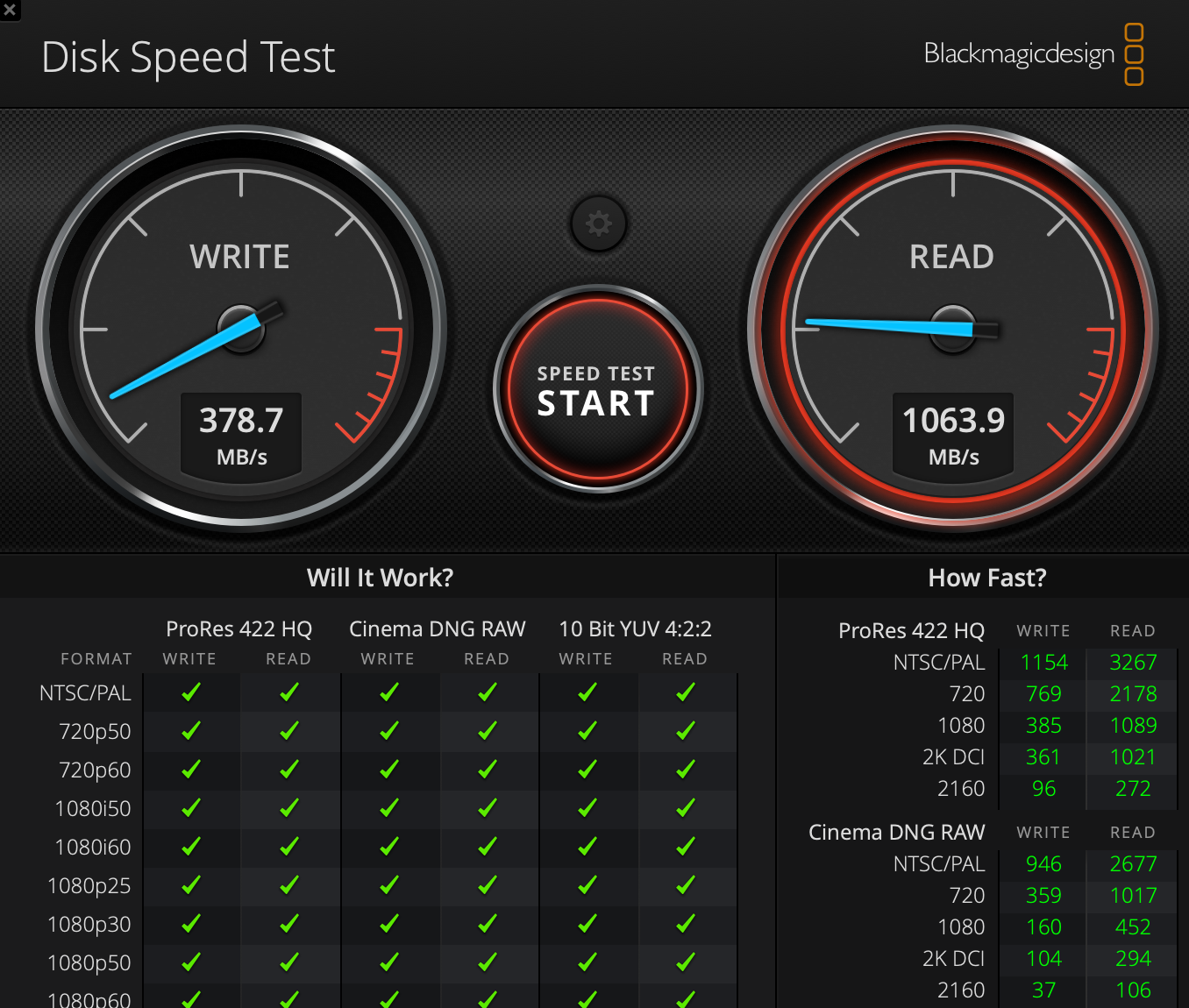

So i have been studying this thread for some weeks now, but i haven't found any information on this issue i'm having.
I upgraded my MBP early 2015 13" with a 500gb Crucial P2. Clean install. Everything is working fine. No crashes or weird behavior. However, the speeds i'm getting are unusually slow and weirdly out of proportion:
I first thought this might be macOS indexing or doing other stuff, but i have been using the Macbook for almost two weeks now so i guess that's not it.
I also tried installing Windows through bootcamp, but the speeds on Windows are about the same.
Next i thought i might have gotten a bad P2 SSD, so i plugged the SSD into my PC, with very different results:
So i guess it's not a bad SSD either.
Could my Macbook just have bad wiring or something? I really don't know what else could be the issue here, do you guys have any idea? Thanks.
These are other things i've tried/done:
  • Upgrading the Firmware of the 500GB P2 didn't make a difference
  • I've tried using both the long Sintech adapter and two from Alixpress, all with the same results

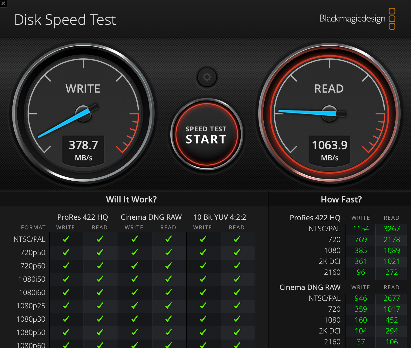

Nevermind, I think i found the issue. Looks like my NVMe slot has some corrosion on it.

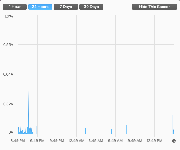

Hi everyone, just wanted to post an update.
So, due to @herb2k 's very good advice I managed to install nvmefix as well as ssdpmenabler and observed that indeed the two work together.
  • On my mid-2015 Macbook pro 15 inch, ssdpmenabler enabled power management and brought my 660p down from .17A to .06A
  • Previously nvmefix did not affect the 660p, but now.... at last, here I am at the controversial 0.00A reading.
  • But as you can see from the screenshot below, in fact my computer is not really reading 0.00A but more like 17mA at its lowest.
@MauriceG, if I understand you correctly, you are seeing swings between exactly 0.0A and .17A on your machine which to me indicates rather that there are differences in the voltage measurement system on various models of Macbook, as has been established on this forum. Indeed I haven't heard of any 660p owner reporting that PM worked au naturale, without kexts, other than you. So either you have a really special and unique example of the 660p, or you've been led astray by the demon of assumptions. Have you tried installing the ssdpmenabler kext yet to see how it may modify your results?
In short I think we can say that some 13' Macbook Air and Pros do not measure amperage accurately and so give a misleading idea of whether PM is enabled. In my case on the 15', I see now the intel 660p working as it was designed to do and giving really low idle states as advertised.
Which brings me to the next point. For all of you engaging with the timeless query of 'Which ssd should I buy?', I can plug for the 2TB Intel 660p. Don't bother with anything less than 2Tb because its a qlc drive. I bought it because I was encouraged by its PM, and was a little dissapointed when that didn't work. However with ssdpmenabler and Nvmefix installed it now performs as advertised. And thats a great deal, because these drives are now very cheap compared to the others. Don't let qlc dissuade you either. People go on about the slc cache, but if you keep 1 TB free, you'll easily have 100+ GB slc cache, which is very fast. And remember that TLC drives also have a slc cache, after which they slow down as well. Speeds are also good at 1700 write and 1500 read.
So its an option not often talked about here, especially now that these kexts are working. And theres no crashes,
Aha! But look at your Istats graph... it reads in Amps, mine reads mA. The devils in the detail my friend. Also those gaps at 0 in your graph look like you had your computer asleep. I’m talking about active wake behavior on battery.
How did you change it to mA?
By the time finished reading your well structured question, it's almost like the answer is right next to you. I believe you're inspiring other people running into similar problem.
The very first response I got in this thread was asking a similar question. I replied and the reply sank deep into the Pacific. What a sad ending. LoL
Other culprits come to top of my head. Bad installation. Poor quality of 3rd-party adaptors. Poor/jeopardised cooling (that should slow down on both read/write).
  • A vs mA in iStat Menu is a red herring. The graph & data points there are about prettiness than correctness. It's about impression than precision.
  • Almost all values are snapped from Apple SMC. So it's simply GUI presentation of SMC sensor readings
    • some pundit here claimed almost all values sourced from SMART. That's simply very wrong.
  • Missing values mean not snapped i.e. iStat Menu process is suspended. People can check out the discussion here: https://github.com/kvic-z/SsdPmEnabler/issues/3#issuecomment-770135820
iStat Menu does its job. I won't treat it as a scientific instrument. It does its job giving an overall impression. 14-day trial is enough to check on people's new installation of NVMe SSD.
When it's on sale for $3.99 a license, it's a steal. Otherwise, there is a freeware known as HWMonitor. I run HWMonitor on my iMac - mainly to keep an eye on HDD temperature & its fan speed. By the design of it, I can guess the author quite a decent man. Sadly it seems no longer being developed.
