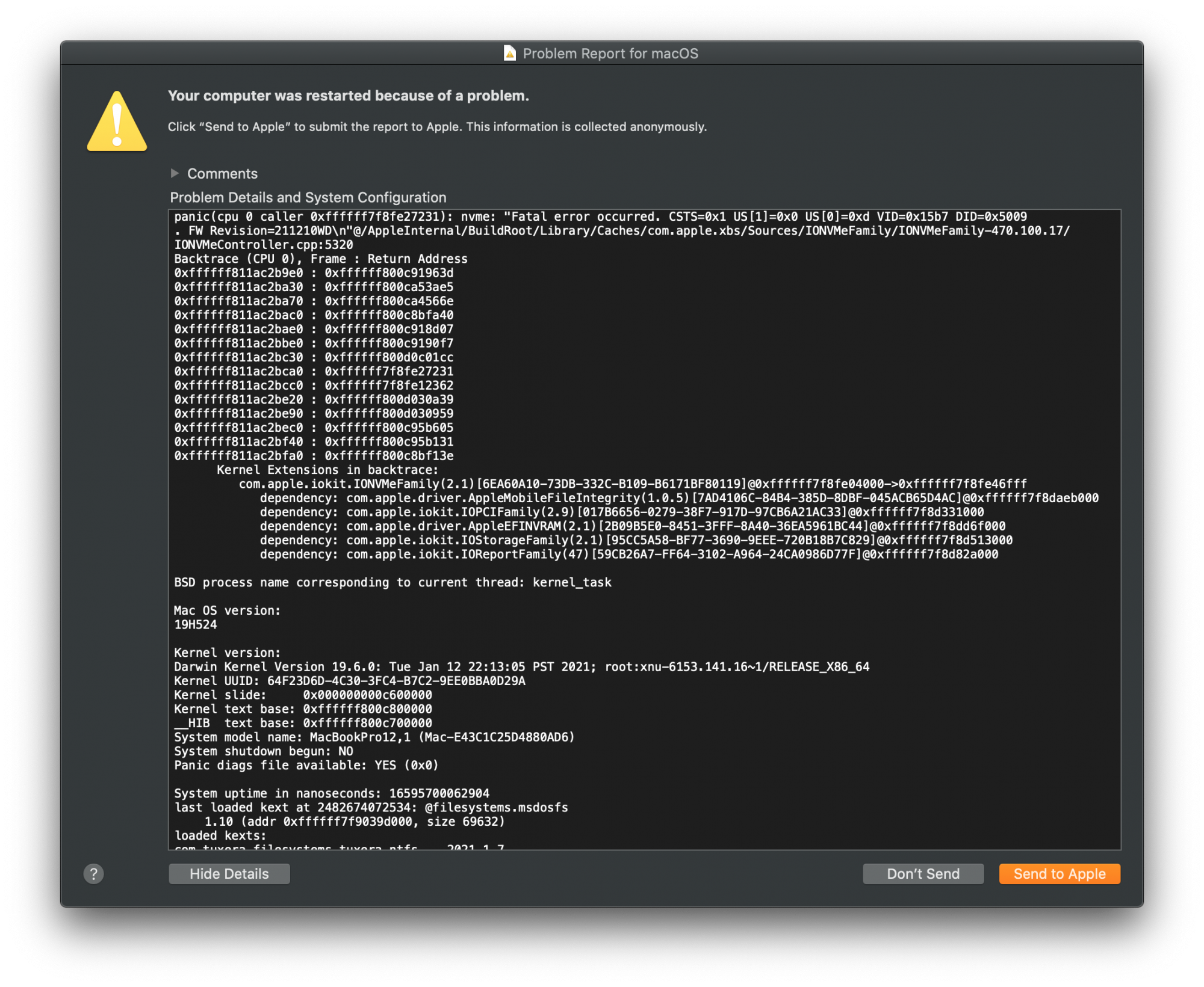

Got a kernal panics everytime when my macbook idle and then sleep ( for a few minutes )
Any idea or any miss config ?
MBP 2015 13"
BootROM 426
MacOS Catalina

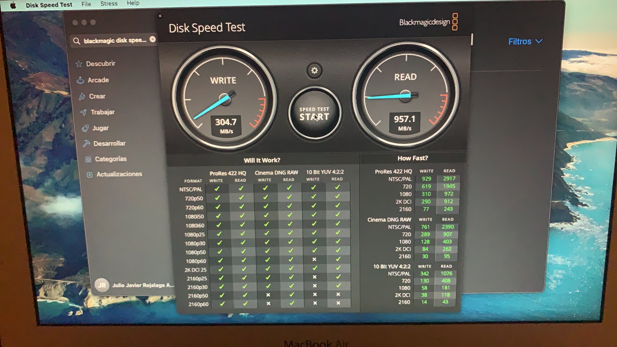

Hello everyone!
I got my first macbook (been long time user of iphone but never a mac computer), macbook air 11“ early 2015.
I found this thread looking to upgrade the 128GB hdd, and I can say is awesome all the information here.
My only suggestion for this to be the ultimate guide will be to merge/add:
- Step by step to create the bootable USB
- Step by step of the installation process (partition types, etc.)
But nevertheless is a great guide to select a new ssd! ;)
Here are my numbers:
Before
After
Crucial P2 500GB
Cheers!!
MBP 2015 13"
BootROM 426
MacOS Catalina
Lilu 1.5.1
NVMEFix 1.0.5
SsdPmEnabler 0.1.1
post the full text of the panics - see my previous messages where to find these on your Mac.
what drive/adapter are you using? How reproducible are the crashes?
if all else fails try to reinstall the SSD adaptor, after a clean with isopropyl and make sure your drive is fully seated. This seemed to fix my issues - I’ve not had a crash in weeks.
There is also a possibility of heat issues. e.g. the SSD drive gets hot possibly after heavy use and is slow to respond/rejects the macos read/write requests. Then the os could panic.
Ups, sorry, cant post the wole crash, seems like have been cleaned by my cleanmacx.
Im use the sintech adapter on wd blue sn550 500gb.
Problems :
- if mac is idle for a period time ( until screen goes black, like sleep ) -> trying to wake -> display the question mark folder followed by kernel panic.
- When i choose sleep, it sleep first, and then restart
Trying to disable put hardisk to sleep when posible and power nap while on battery. No crash in a week ( except sleep).
Trying to reseated ssd, or ill comeback if had an kernel panic again. Thanks
