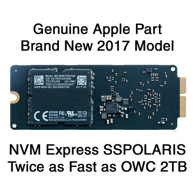

Hi, thanks for all your interesting posts. I have just bought a 2TB Crucial P2.
Can you tell if it's QLC or TLC from the look of it?
• The SSD is one-sided, no components on the backside.
Noticable info on the sticker:
• 3.3V, 2.5A
• Firmware: P2CR033 (This is the recent firmware.)
• I have noticed that on some photos on the web the sticker shows 1.7A – what does that mean?
• The circuit board shows a lot less components than some of the photos online.
My SSD looks like the one here: https://www.storagereview.com/review/crucial-p2-nvme-ssd-review-2tb
It does not look like on the Amazon photo.
• 3.3V, 2.5A
I guess its QLC. You can't see it on the label
There is some phison-software (http://vlo.name:3000/ssdtool/ ) which gives you the answer of your question by reading out firmware.
1.7A is the power consumption of the one with 1 TB.
2.5A is for the one with 2TB.
There is some phison-software (http://vlo.name:3000/ssdtool/ ) which gives you the answer of your question by reading out controllers firmware.
Thanks for your reply. Hm, based on what is your guess?
“Phison flash id” requires Windows just to read out the controller. Running it in Wine didn't work.
As for the 1.7A or 2.5A: The Amazon photo shows the 2TB Crucial P2 with 1.7A.
And in this review you can see a 1TB with 2.5A. – Just the opposite.
did have a Crucial P2 weeks ago and read out the firmware, its was a qlc too.
Do you think amazon uses different labels? I think they took one pic in the shop and photoshopped the others...
A picture is not part of a purchase agreement.

I just bit the bullet & bought a brand new Apple 2TB Polaris for $899 on eBay & don't have a single problem plus I get Write speed of 1335Mbps & Read speed of 1375Mbps. It was pricey but I can afford it & I have none of the problems that others report. Temperature of the SSD was only 35C after some testing of performance with Black Magic Disk Speed Test.
