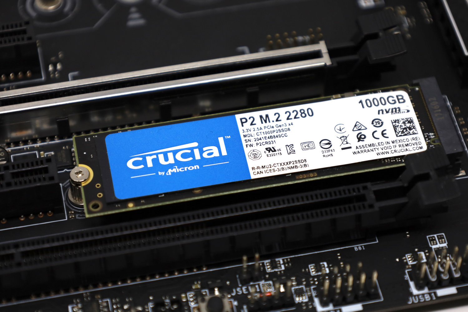

As for the 1.7A or 2.5A: The Amazon photo shows the 2TB Crucial P2 with 1.7A.
And in this review you can see a 1TB with 2.5A. – Just the opposite.
Crucial P2 1TB PCIe Gen3 NVMe M.2 SSD Review
In our Crucial P2 1TB review, we see how this PCIe Gen3 NVMe SSD fares compared to other M.2 drives we have tested, and the answer is not wellwww.servethehome.com

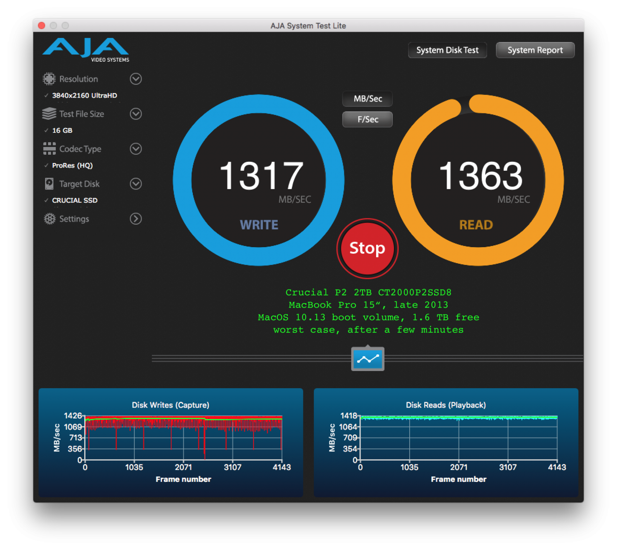

good to know! Thank you!I have installed the 2TB Crucial P2 finally.

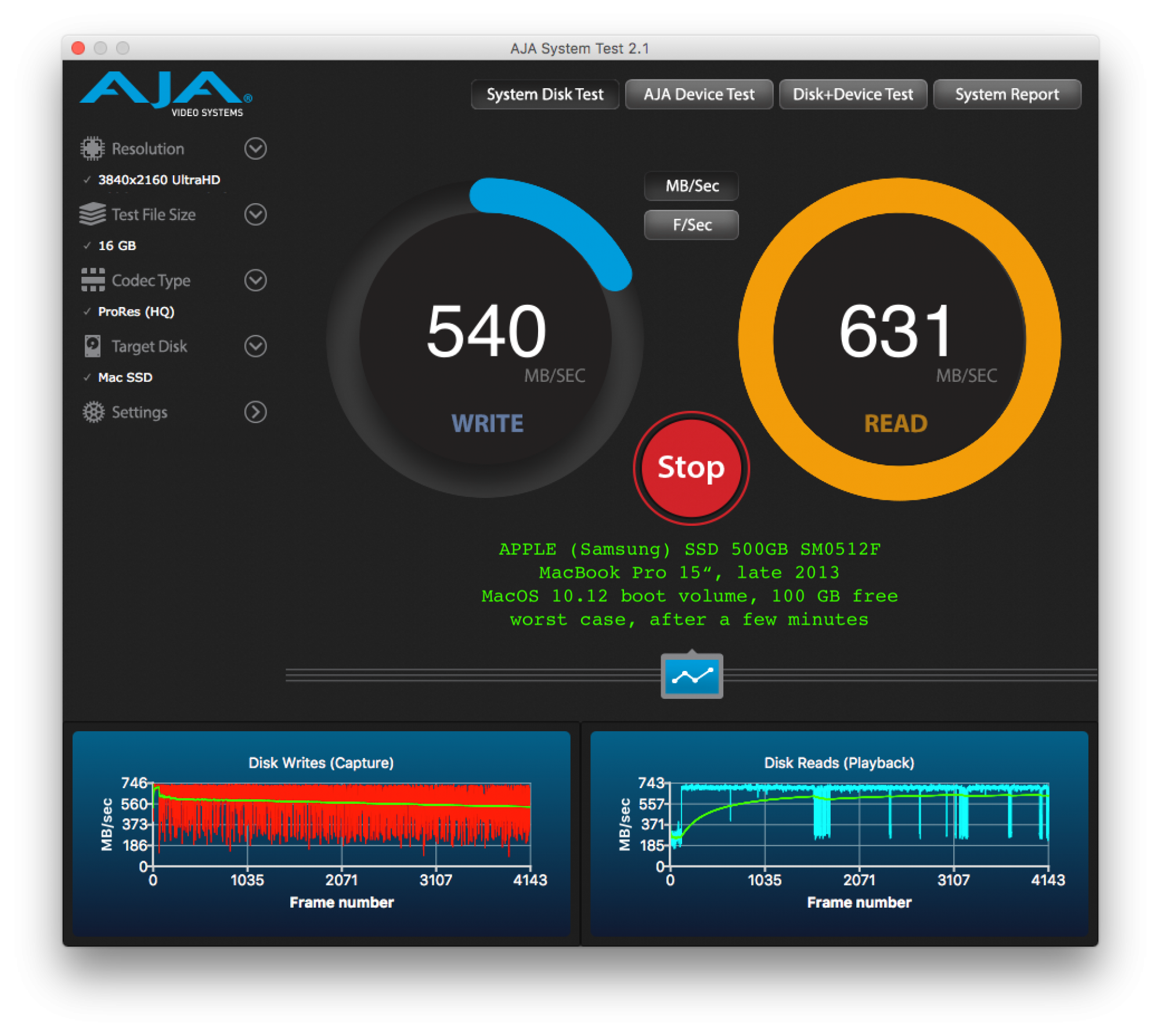

So far I am impressed with the speed, which is double of the Apple SSD. Temperature is 40°C in 23°C room temperature. Apple Diagnosis has recognized the SSD (no problems found) and also SmartReporter. I can post details here, if somebody wants to know more.
