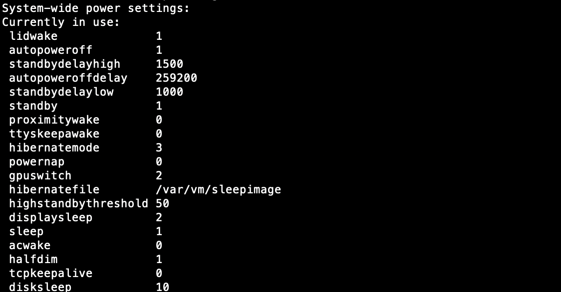

Hello,
I've read it, and already tried to disable things such as tcpkeepalive, tried different hibernation and sleep mode, but nothing seems to work.
here are my current pmset settings :
Turning hibernation to 0 makes the problem worse.

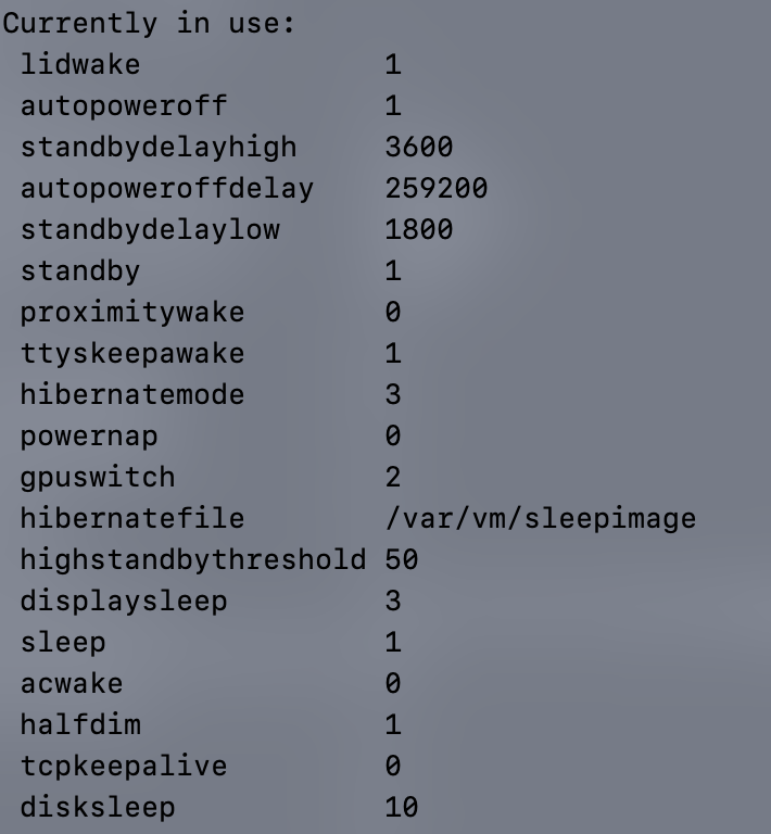

Hello,
Your settings seem to be fine!
Did you try to use @kvic's guide?

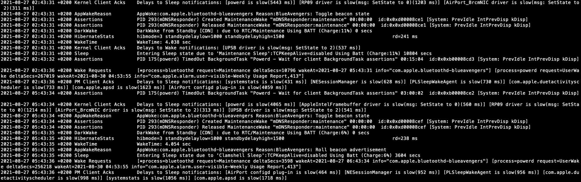

Interesting, here is a log of the pmset of this night (my computer was not powered) :
The culprit seems to be that AppWoke:com.apple.bluetoothd-blueavengers Reason:BlueAvengers: Toggle beacon state.
I made some research, and the "allowing bluetooth device to wake up computer" under advanced bluetooth config. is already turned off here. This thread is providing some useful information.
I tried to completely disable Find My Mac as it could be the culprit too, as I don't have any bluetooth device connected to my mac and proximitywake disabled. I'll keep you posted.

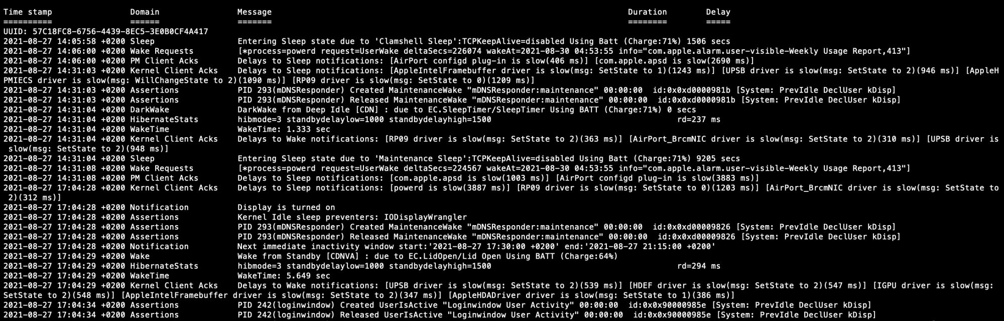

UPDATE :
Idle for like 3 hours, looks like the log show that the computer isn't trying to wake every half our or so. Still, 5% lost in the meantime.
