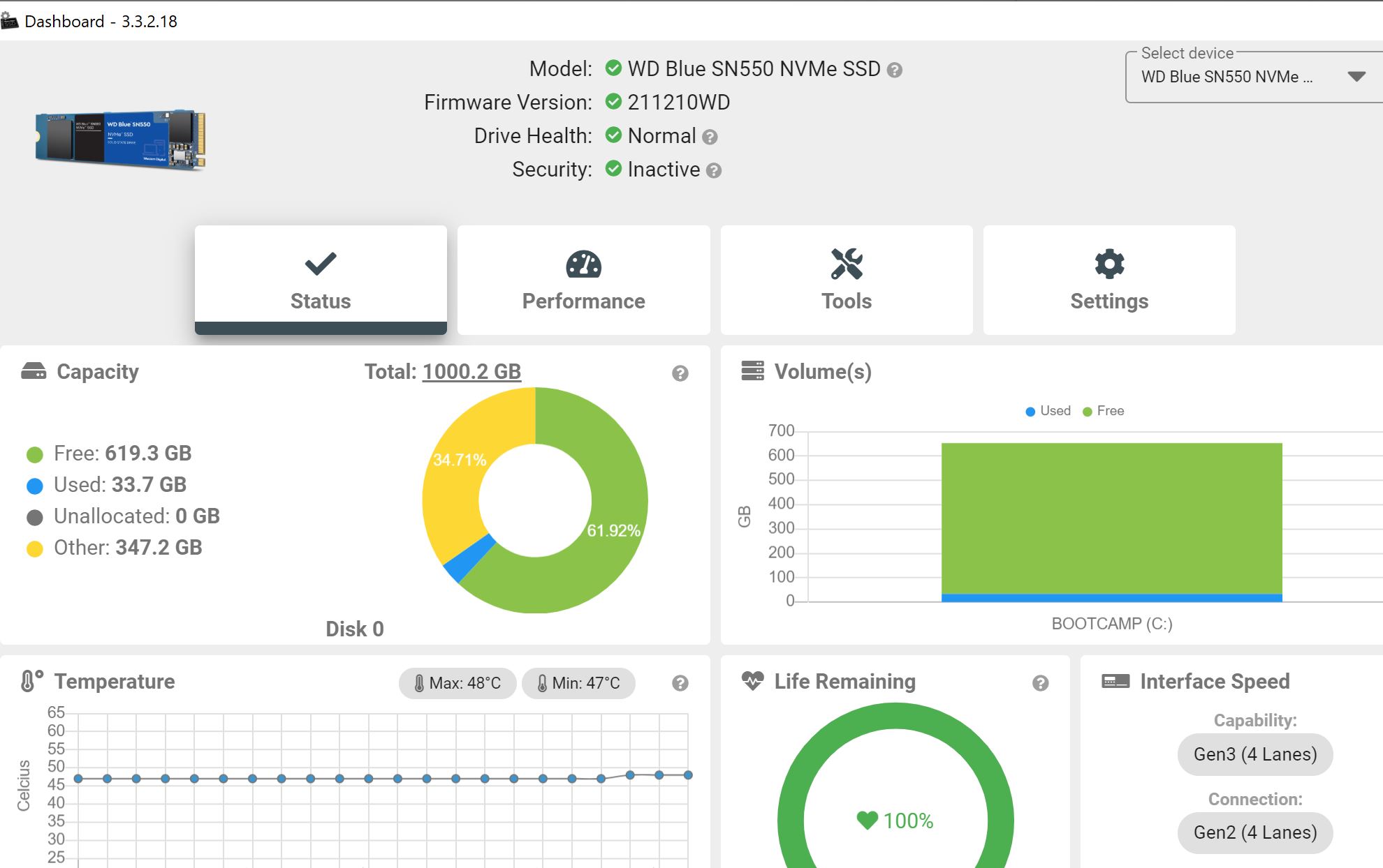

just wanted to give an update on my SSD Upgrade on my MBP12,1. I ended up buying the WD Blue SN550 1Tb + Sintech adaptor. The installation went very smoothly (Bootable USB with BigSur Installer + external disc with Time Machine Backup). Then I installed W10 with Bootcamp and downloaded WD Dashboard to check if the Firmware was up to date (it was up to date as shown in image attached).

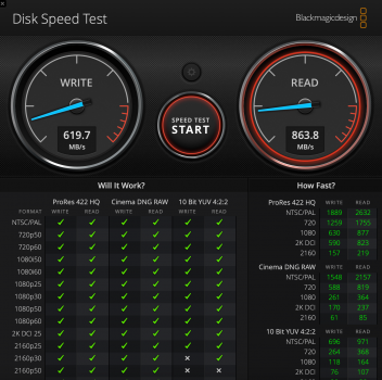

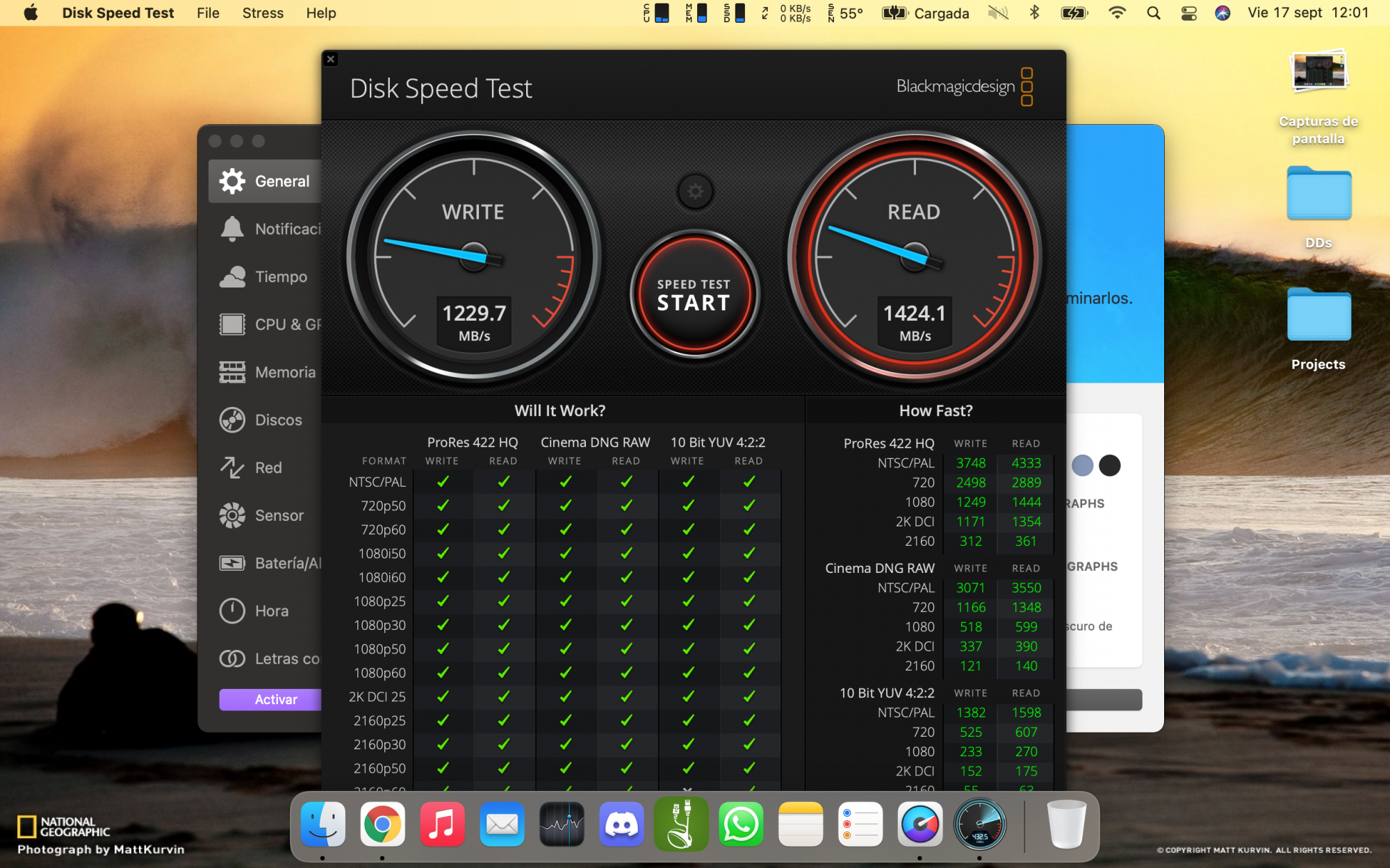

Then I switched back to MacOx to install kext (thanks @kvic )and test the W and R velocities as well as the idle power consumption. I have attached a disk speed test of the Original Apple SSD and then idle power consumption + disc speed test of the SN550.
I have been working with both W10 and BigSur for the past few days and I have no complaints so far, battery drain during sleep mode is minimal and everything else runs pretty well! Again just wanted to thank this thread and all the people that helped through the process!! :)

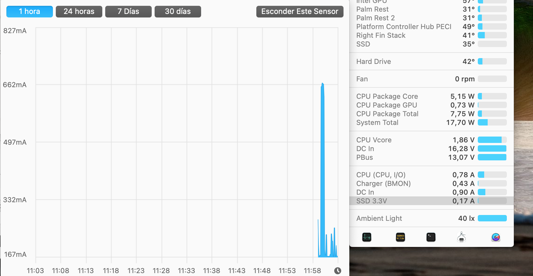

Out of box idle power will be like:
  • Corsair MP510 - 0.17A
  • Crucial P2 - 0.10A
  • Hynix P31 Gold - 0.10A

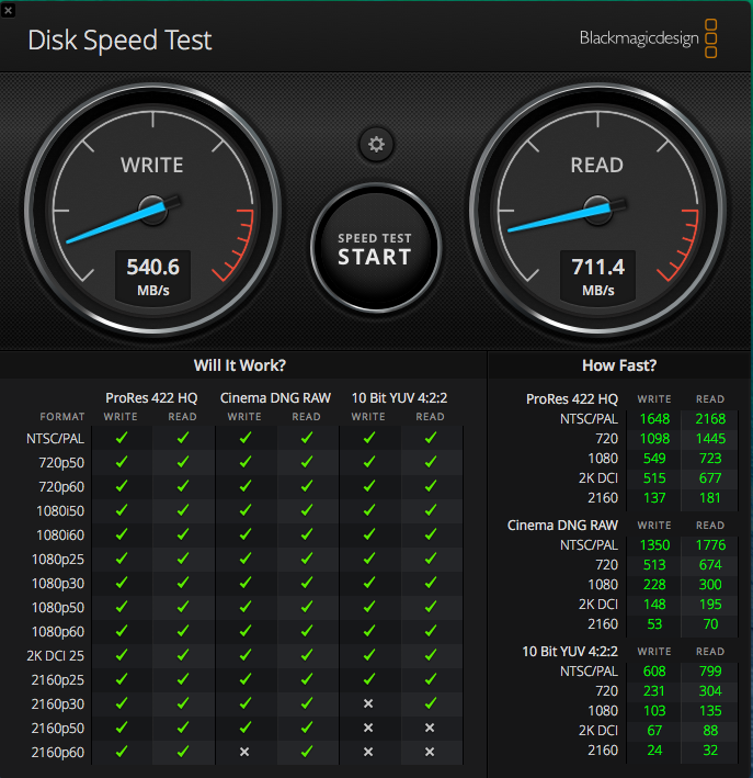

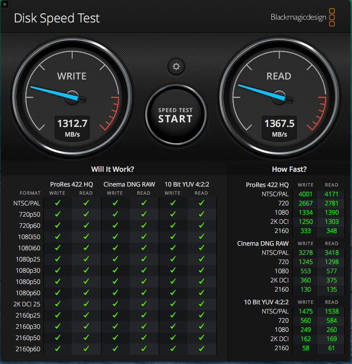

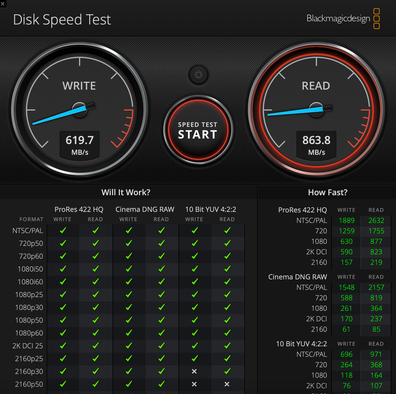

Here are the speed results. The original drive had read/write speeds of 540/711. The new drive was 1313/1367. So it's much faster. Note - I used the 2GB stress test on the original drive and both 2GB and 5GB on the new drive. Didn't seem to be a difference in test results between 2 and 5GB.
Original 256GB Samsung/Apple SSD
New Corsair MP510 - 480GB
