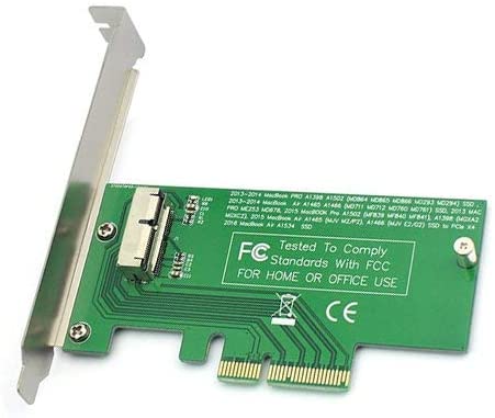

I received a 128GB version for free. So i bought an adaptor and put it inside my Linux machine. Get electrified on a daily basis. Well protected both mechanically and electrically. :cool:
Available on Amazon and elsewhere:
